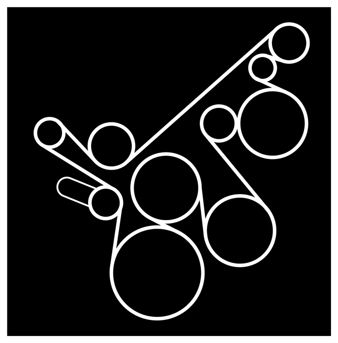

Getting tired of referencing my belt routing scribbled on an old piece of cardboard... actually it's not like I need to reference anything anymore, but figured I'd take the time to make a belt routing diagram. All to scale, took measurements of distances and angles.
Any recommendations on where to get a weatherproof vinyl sticker made?
I drew up a label for a TJ with an ORO York air compressor kit and air conditioning awhile back. A page of 15 stickers on vinyl cost me about $15. I had these guys make them:
www.stickeryou.com
By the way, if anyone sees this and wants one of my stickers, drop me a PM with your address, and I'll pop one in the mail, no charge. I offered them up in a free "for sale" ad here, and gave a handful away. I still have a few left.

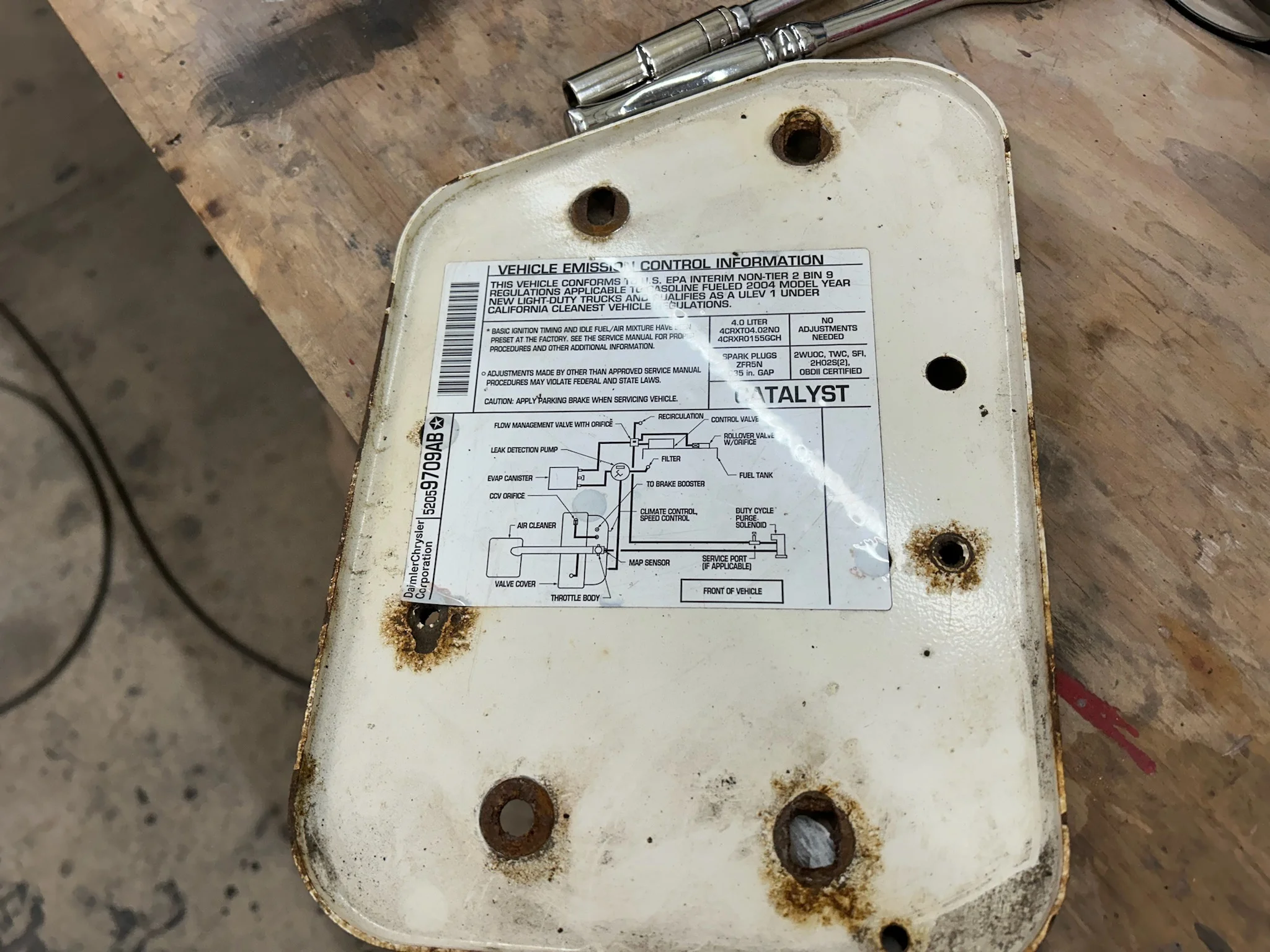

My body shop guy wants me to find this label and replace it to keep things original. He refinished the fender supports when he replaced the fenders.
Any idea where to start looking?
Try https://www.vinslabels.com/replacem...order-veci-replacement-read-veci-sticker.html, but be prepared for sticker shock (pun intended). If I remember correctly, they are on the order of $100. I looked into one for another vehicle a few years back. Not true - this was for a replacement VIN decal.

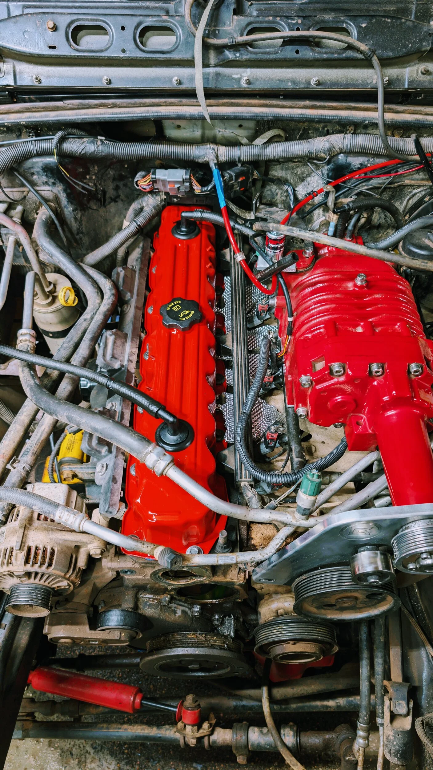

Mine has a few extra pulleys
www.stickeryou.com
Thanks I'll check them out
Take a high def picture of it without any reflections and take it to a vinyl shop. They should be able to print it on high quality vinyl.
Or
Collins Brothers Jeep may have one. This one is for an '06.
https://collinsbrosjeep.com/2006-4-0-emissions-decal-under-hood/

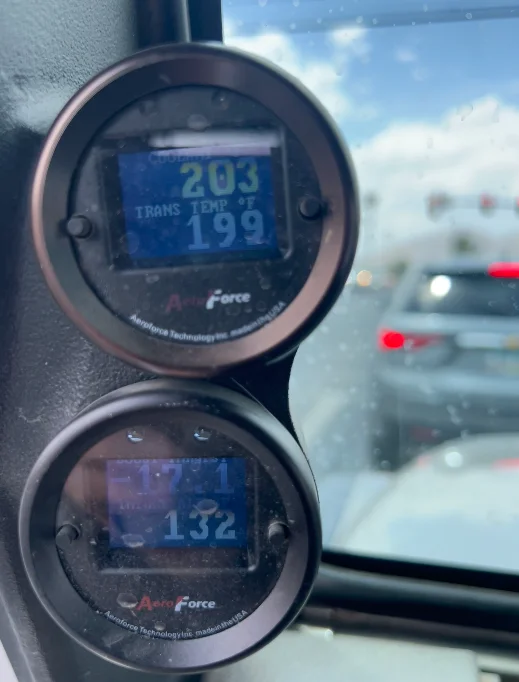

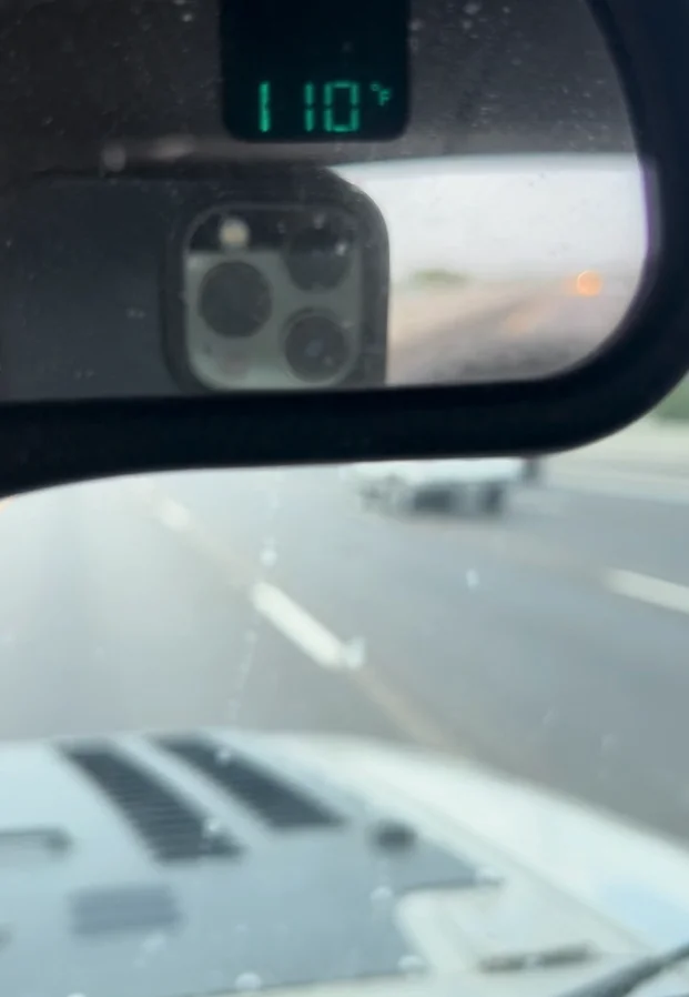

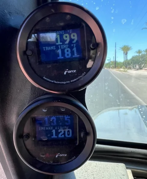

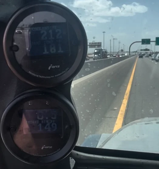

My temps are already much nicer and that's just in time for the heat wave.
Around noon today on the highway (slight incline):

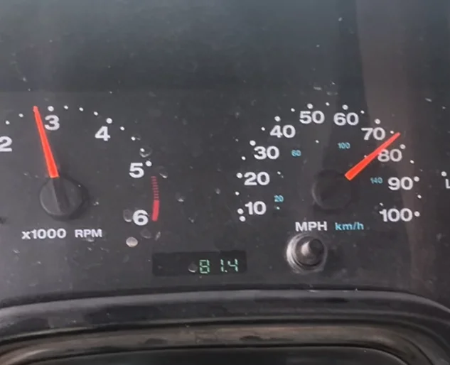

It didn't get this hot until after I was doing more around 85 mph at 5 psi of boost right before I took the photos. The hottest I saw was 215* for about 3 seconds before it dropped back to 212* as the hottest consistent temp.
In town after leaving the VA:
(driving)
(idling)

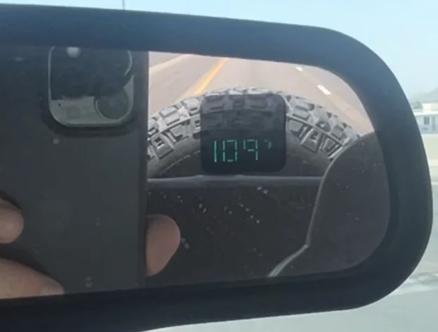

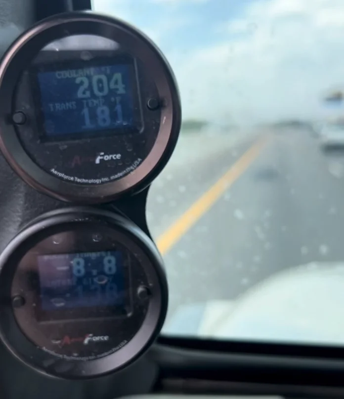

Around 1:30pm today on the highway (slight decline):
