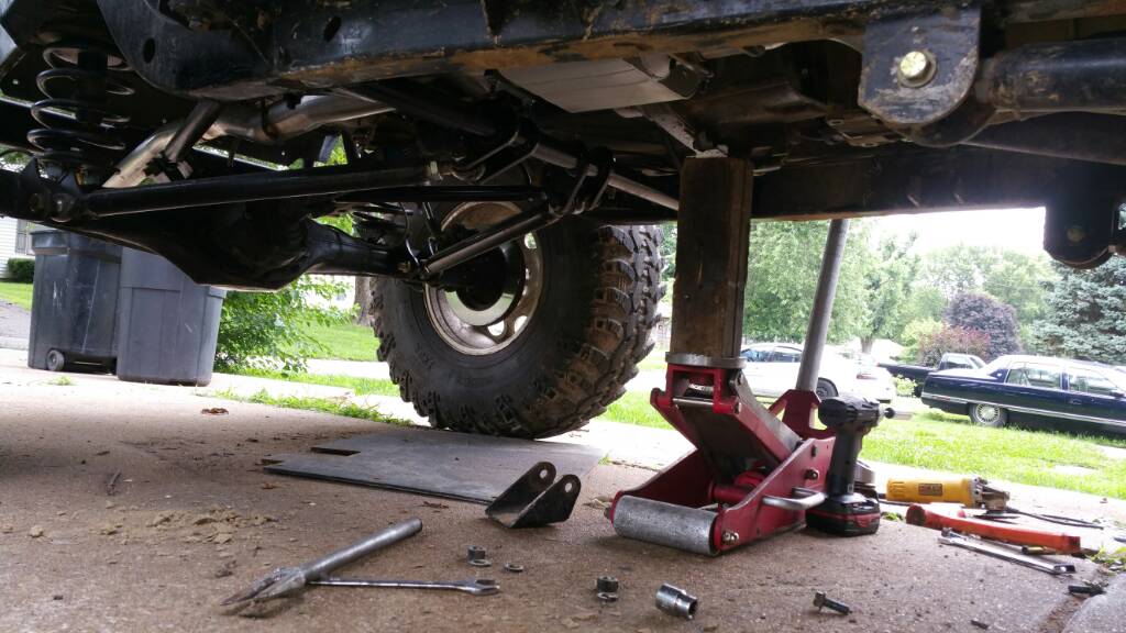

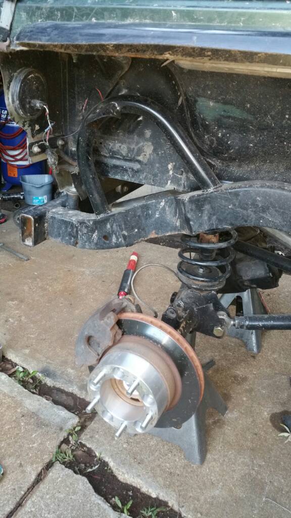

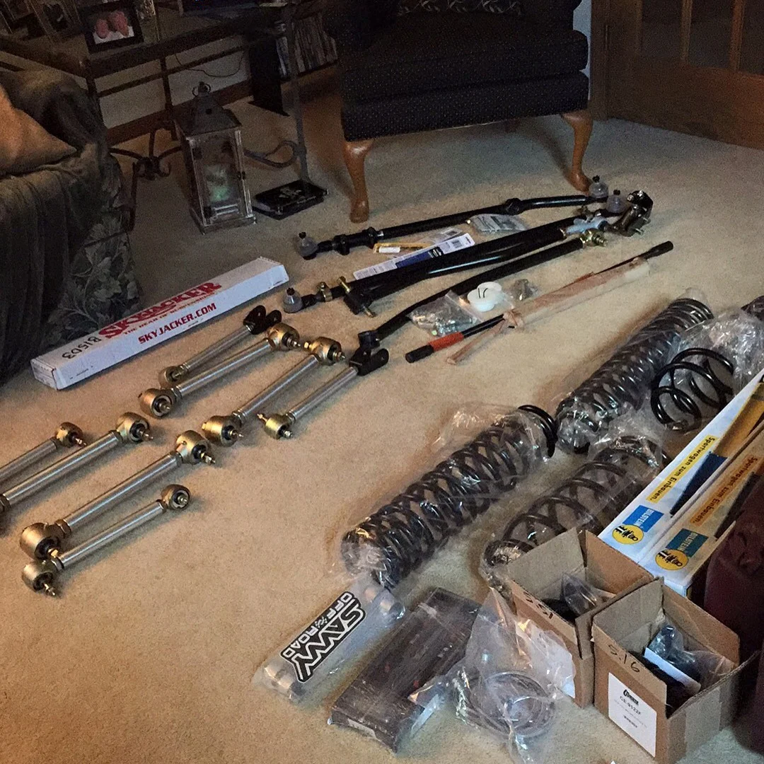

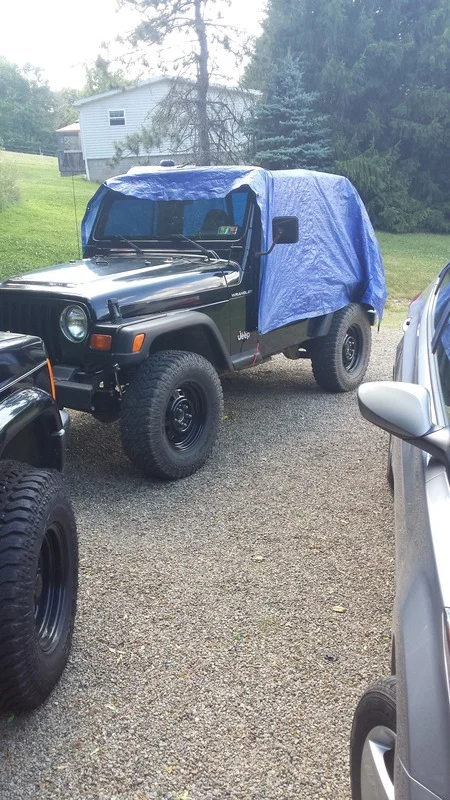

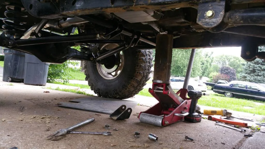

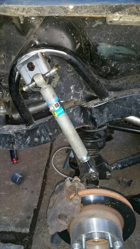

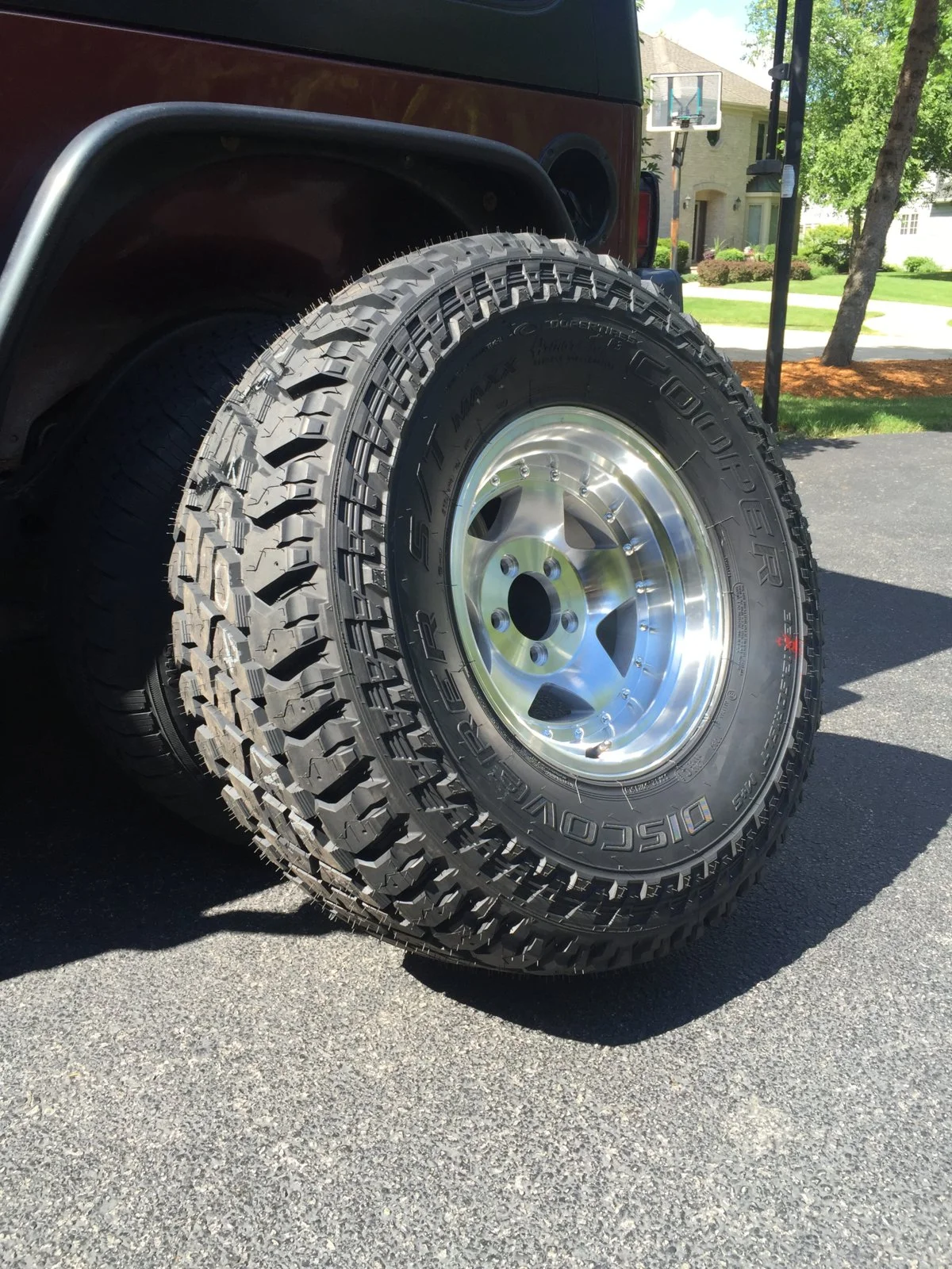

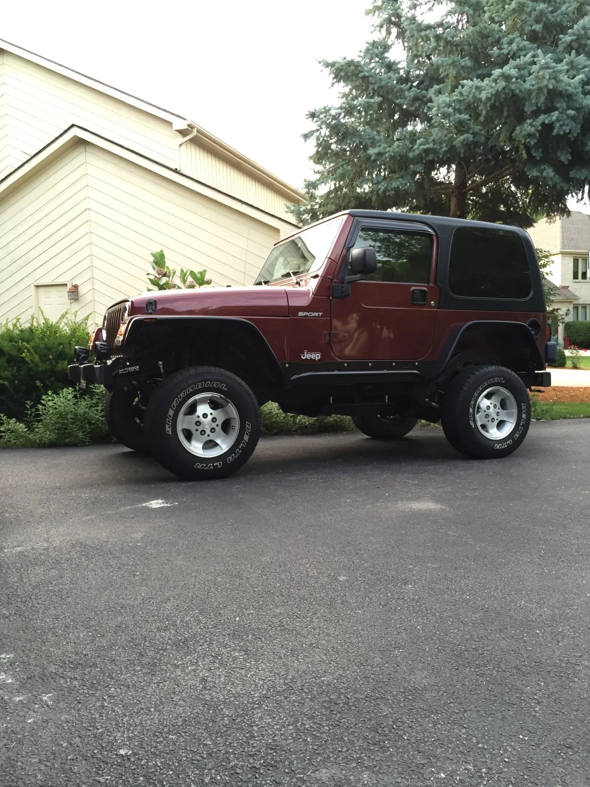

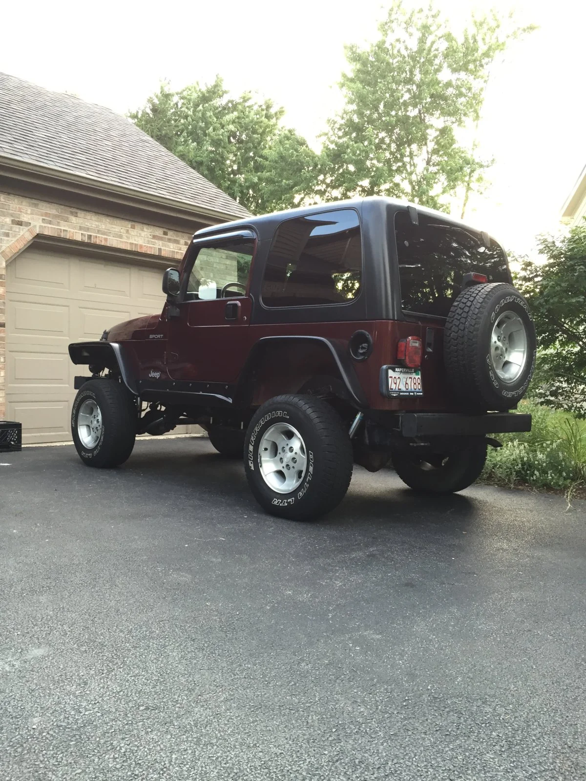

image.jpeg image.jpeg image.jpeg image.jpeg Installed the savvy 4" kit this weekend. Also put xenon flat flares on. Tomorrow I'll put the currentlync on and align it at work. Had to drop the t case 2" to get the vibes to be driveable. Ordering my shafts tomorrow from tom woods hopefully can do the sye next Monday. Waiting to get the alignment set up before I put the 33s on.

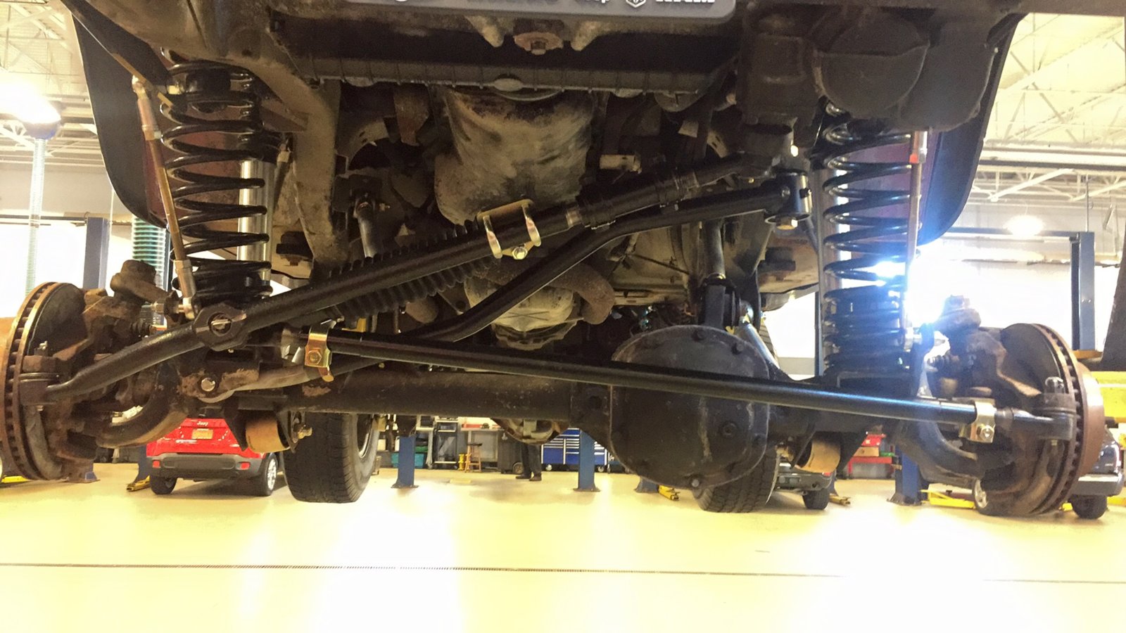

Currently my front drive shaft is out due to the dc joint failing. While doing the alignment today I had 6* left and 6.5* right caster. Reading a lot recommending 5-5.5 for a 4"+ lift. Jeep is still a little squirrelly. I think I need to get my rear steer ahead dead set. It was .14* so didn't mess with it. I set toe slightly toe in. Also my rear axle is about 3/8" off center and the front is almost 1/2". I guess I should really get the axles perfectly centered then worry about the alignment. Any recommendations on alignment? Any of you guys use an alignment rack?

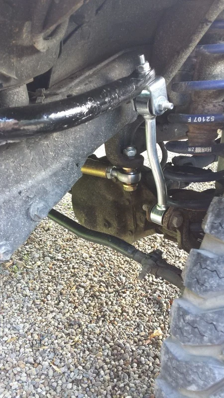

I installed Metalcloak's t-bar last week and today I finished up on the sway bar install (painted the bar, brackets, and installed Zone Off Road fixed links). Now I can dial my RS9000's back down to 3F/2R.
