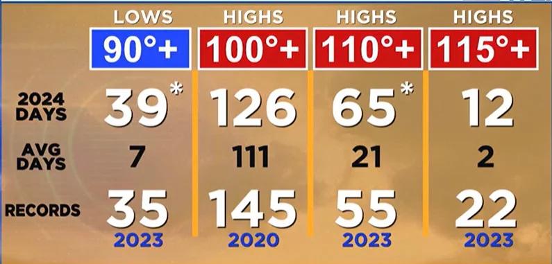

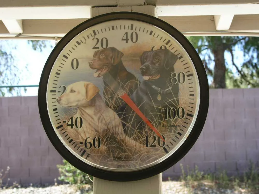

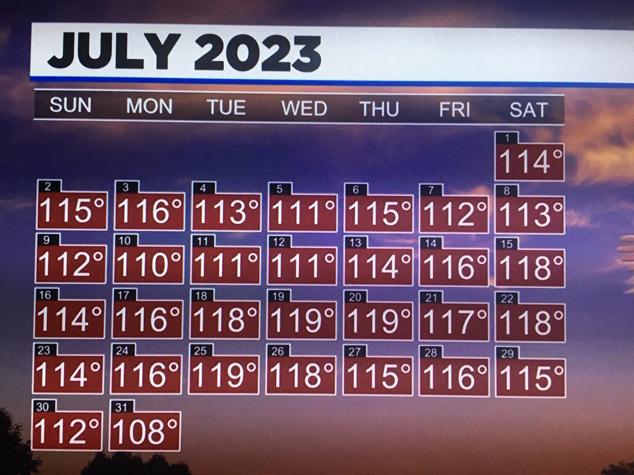

Sometimes folks who don't live here don't fully understand what we deal with in the summer.

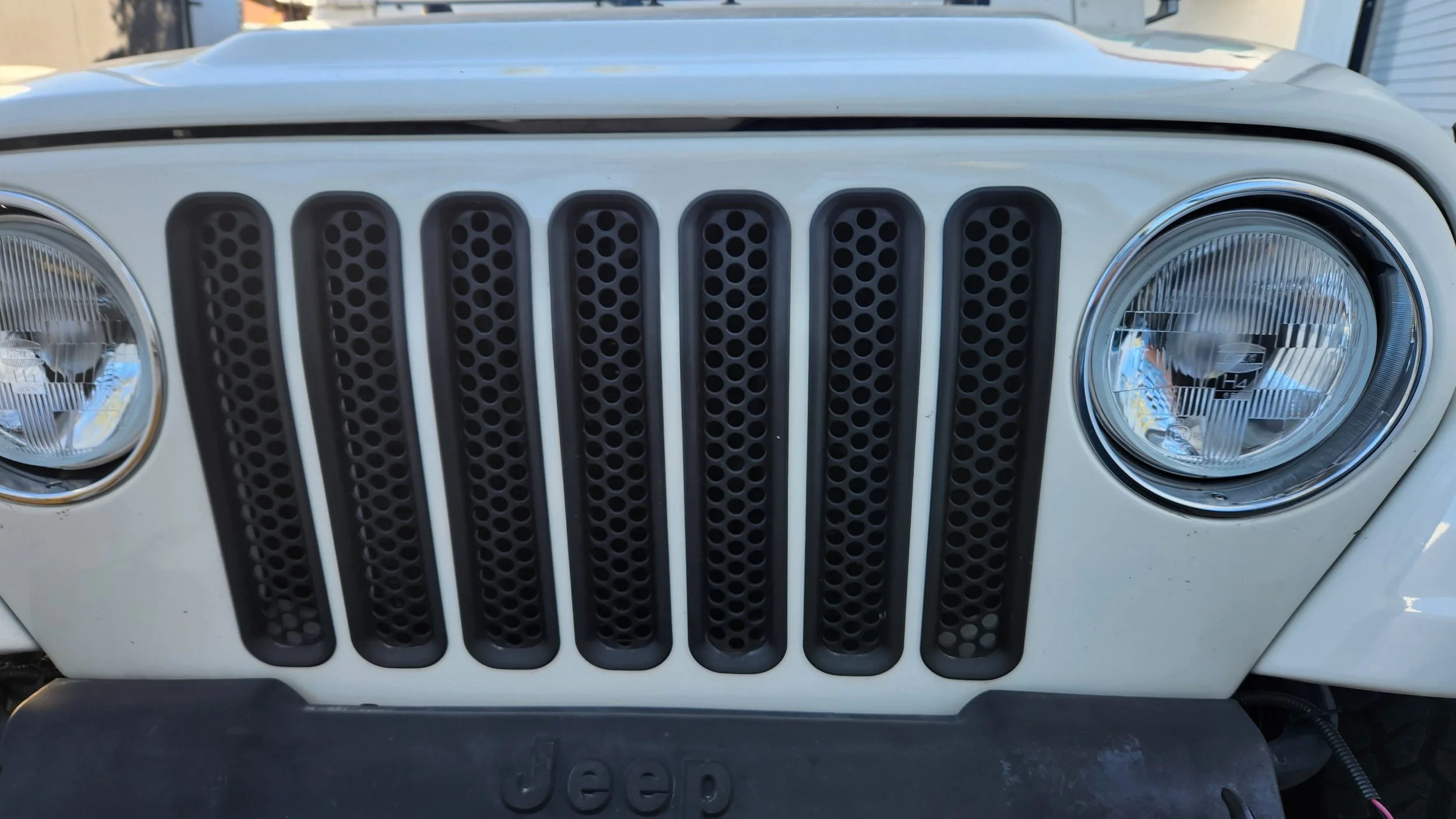

There are past threads where I recall some people saying it is normal, but I still don't know. I also have the black inserts in my grill which I plan to remove this year just to see if that makes a difference, some say it won't and some say it will. It's the last thing I have to try.
