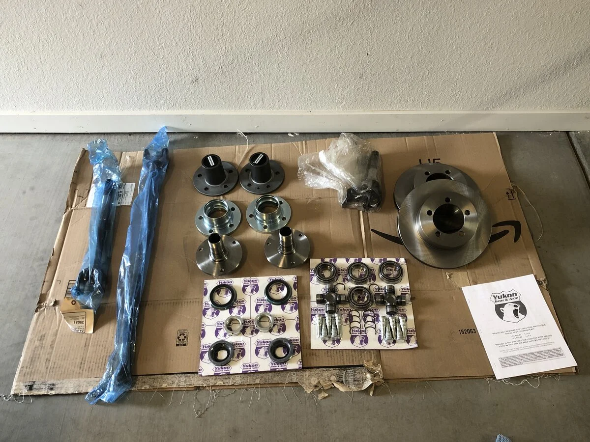

And that’s where we left off! Not sure the next steps but a hub kit may be in his future as well. Maybe 35s will decrease the high speed vibes enough though
