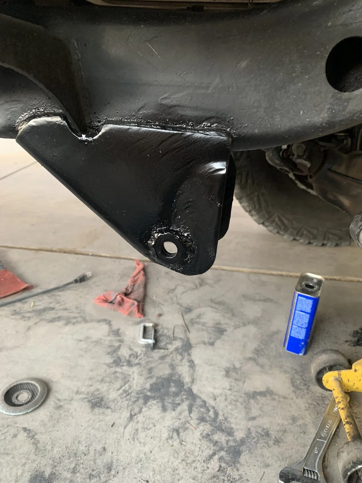

Filled in the old stock hole and welded the washer on for a little extra strength.
Cut the bottoms off my LCA mounts and boxed it in. Made sure the plate is behind the joint and above the bottom of the joint so a rock can slide from the joint onto the plate and not get hung up.
