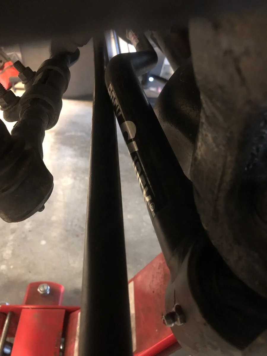

The things you find when you properly cycle your suspension.... turns out my front driver side uptravel is limited by this rough country diff guard the previous owner put on. It hits my currie track bar at just about full bump but not quite. Good thing I RTVed this thing on super well. Time to take that guard off.

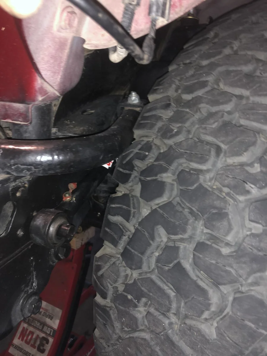

but I found out why it’s so hard hard to turn at full bump. Sway bar is in the way. Would an anti rock eliminate this?

My antirock arms caused rubbing compared to my stock bar disconnected but every Jeep is different with wheels, tires, etc. , could you relocate your sway bar disconnect pins closer to the front to push the bar farther up into the inner fender?

This is one of those duhhhhh moments. That will definitely fix it. My mind is on too many things right now. Thinking about relocating my upper front shocks mounts an inch further up to allow more up travel

I’m just going to relocate the pins further back to push the sway bar up out of the way
Ok. Are you sure it's only rubbing on full bump/full lock while disconnected? It looks like it's rubbing your link maybe while connected at full lock.
