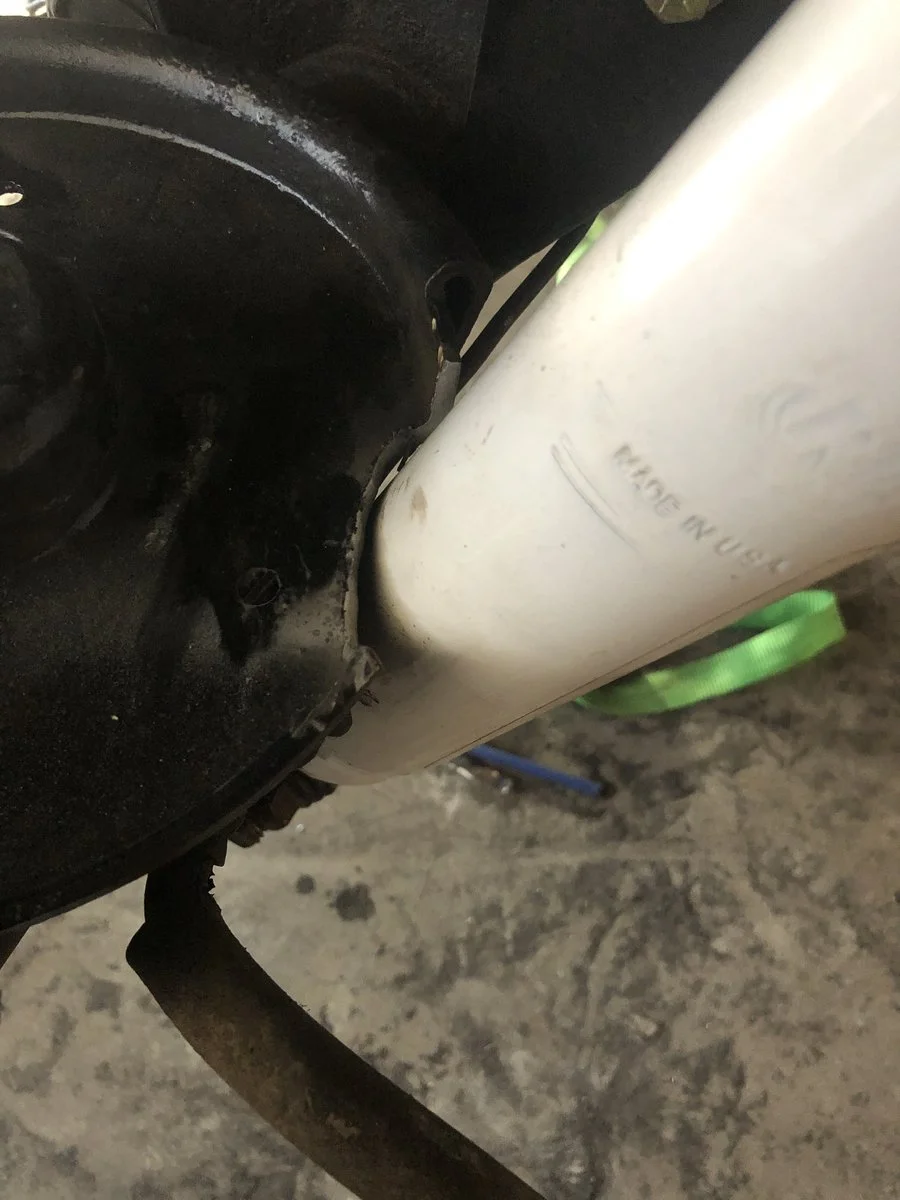

Damn that shock is close! You sure it’s not going to contact at all?
It’s kind of a bad angle but it doesn’t touch even at full droop. I will probably take a flap disc to it and take a little more out once I get my driveshaft and have to adjust pinion again anyways.
Got it! I almost did this on mine but then I just bought the lower shock mount extensions instead.
Here’s a better pic. Hanging at full droop but a little more grinding wouldn’t hurt. See I ballparked where the shock extension would be at full bump and I would have to add bumpstop extension to run the shock mount extension so I opted to cut
Here’s a better pic. Hanging at full droop but a little more grinding wouldn’t hurt. See I ballparked where the shock extension would be at full bump and I would have to add bumpstop extension to run the shock mount extension so I opted to cutView attachment 158376
Make sure you check side to side droop as well! Angles change a bit.
