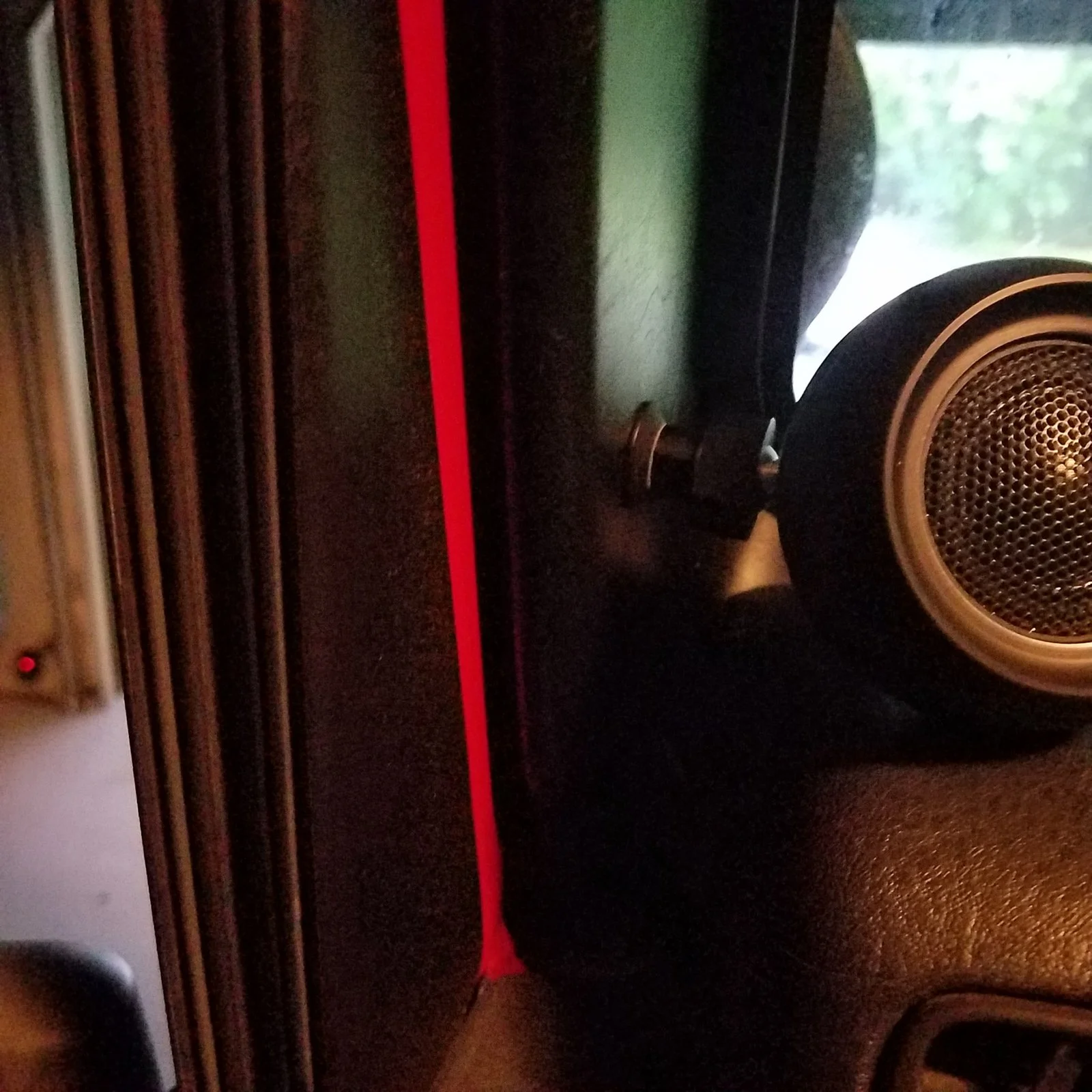

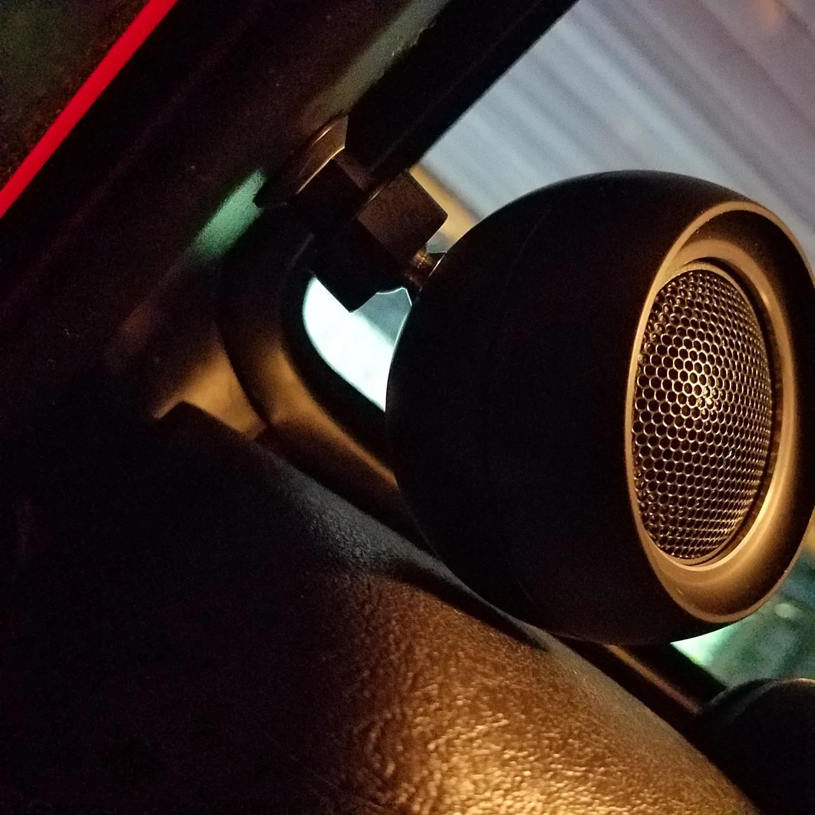

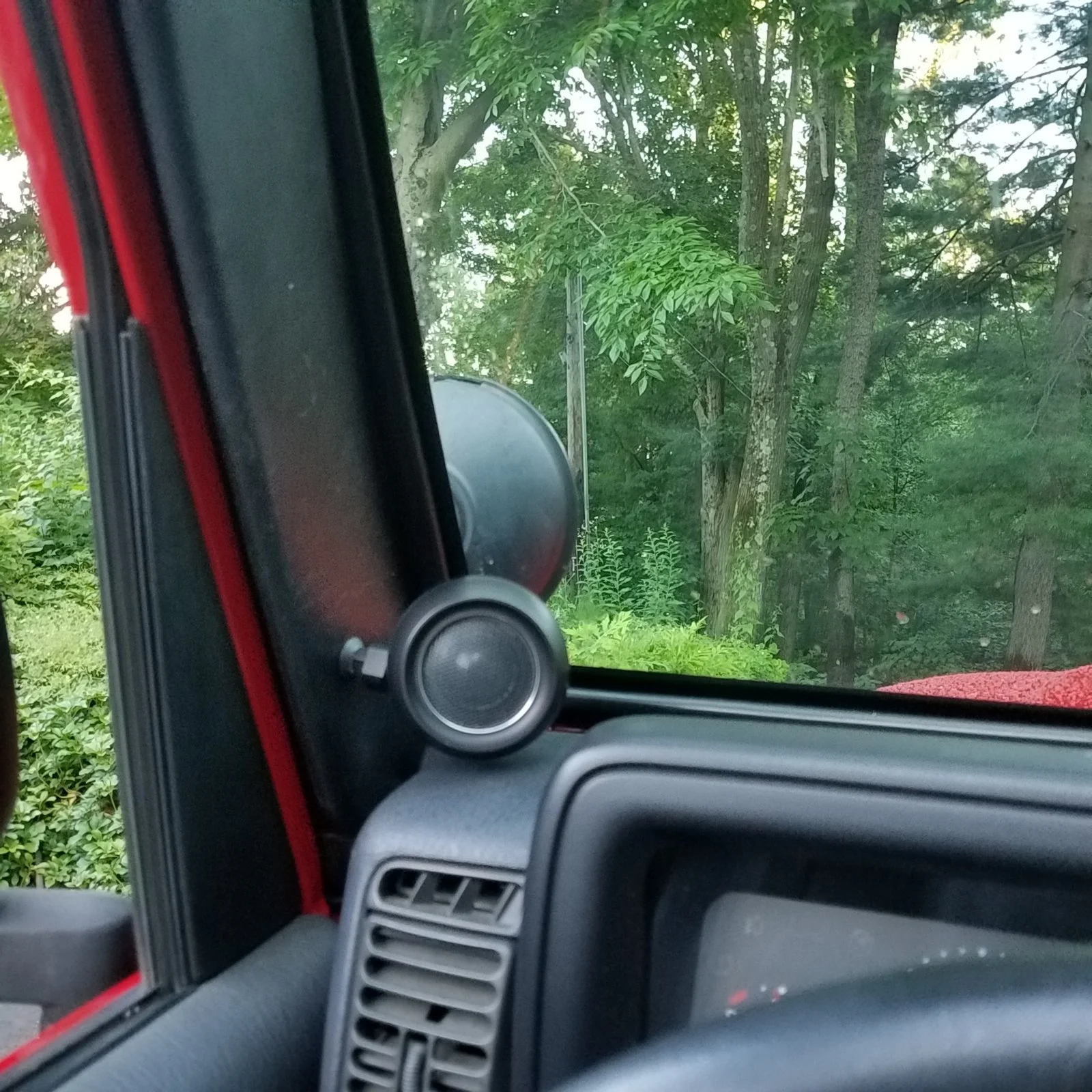

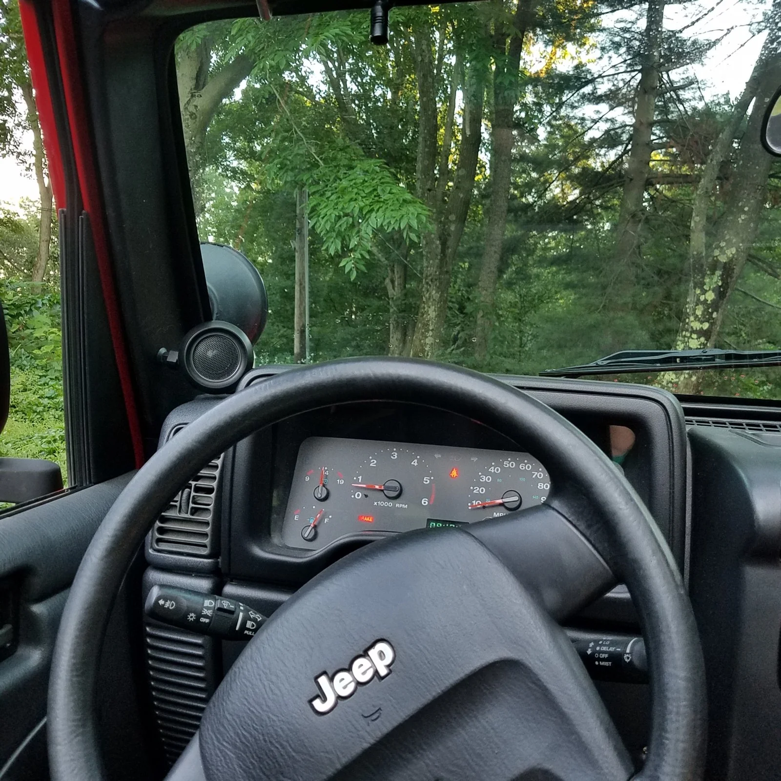

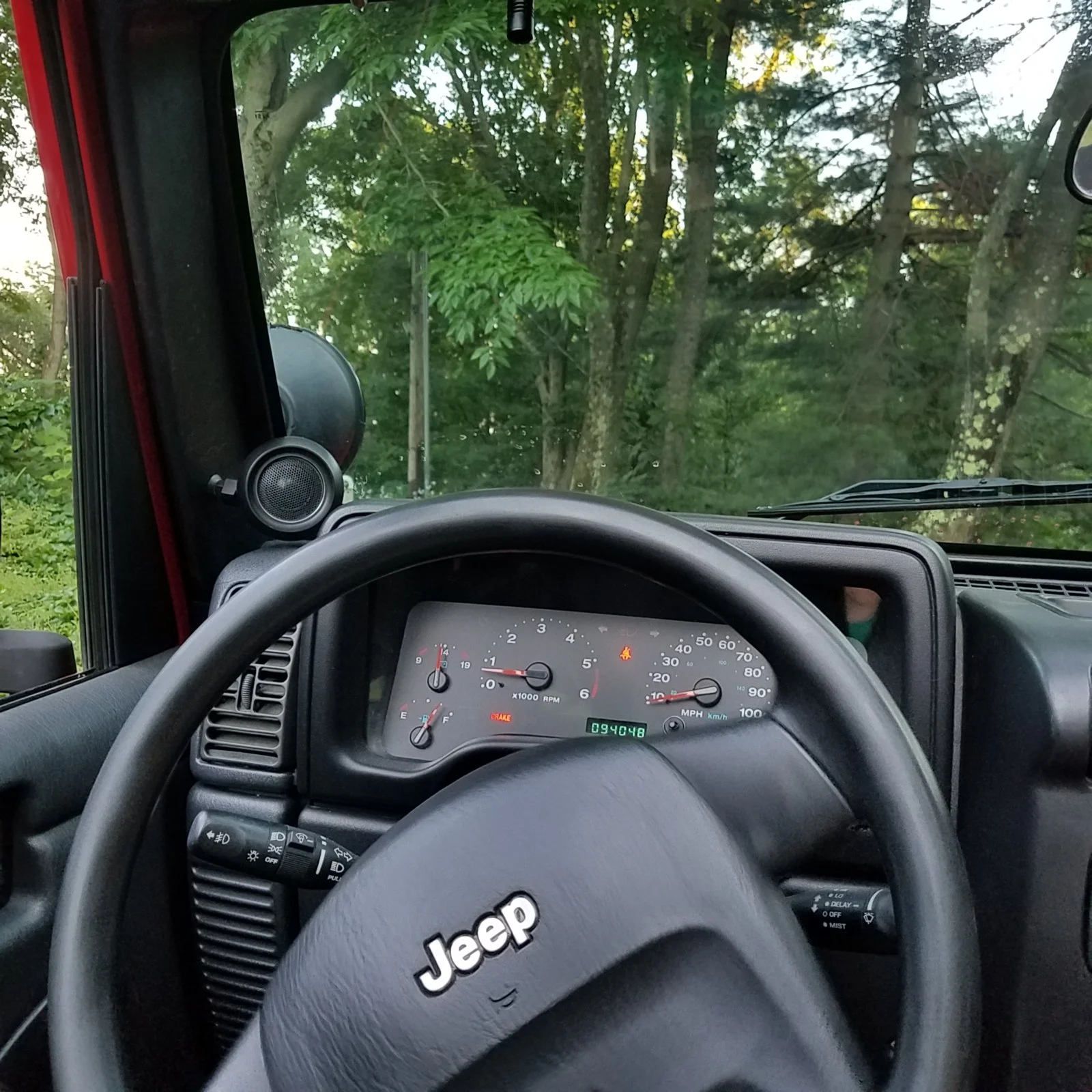

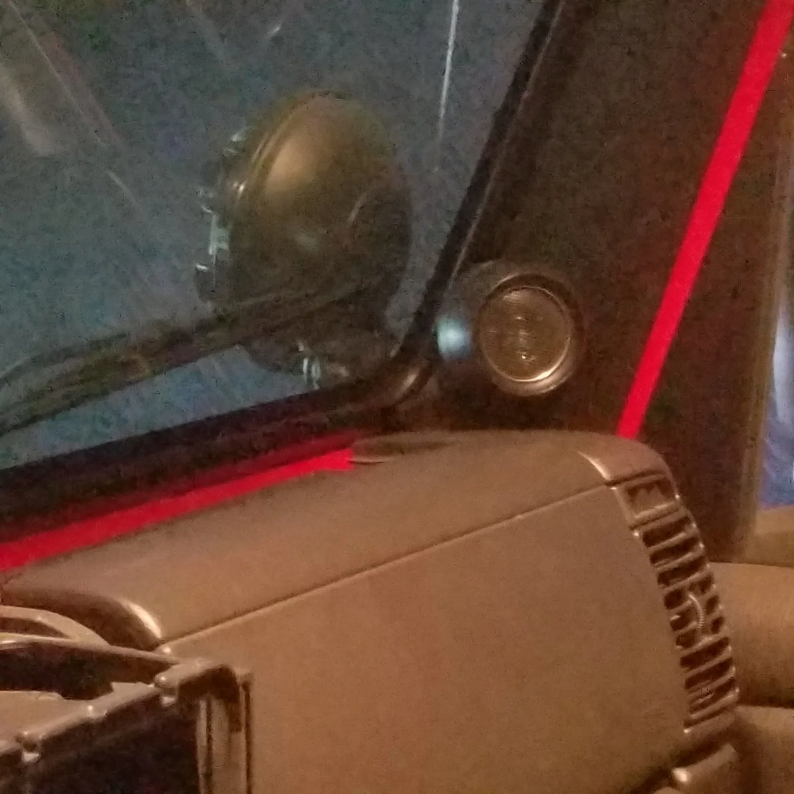

I utilize all of my interior space so I cannot sacrifice space under any circumstance, so I thought of placing speaker pods in the A pillar trim. By placing tweeter pods in the lower A pillar the audio is now on axis and blowing music in your face. I am not sacrificing any interior space and should be able to have a clean install.
The end result is what I wanted, the music is crystal clear, with no top on and driving highway speeds I feel that I am encapsulated in a bubble of quality sounds. All I hear is the music when hitting 60mph, wind noise is no longer overshadowing my tunes.
What I ended up doing is going fully active and getting a new head unit which has HD radio and a Qualcomm aptX chip for better quality bluetooth streaming. This HU goes to a 5 channel amplifier (had this amp from a prior build) that is powering the 4 front speakers, which are from my old speaker pods, the 5.25" and 1" mentioned above. The 1" tweeters are in the A pillar speaker pods while the 5.25" were relocated to the OEM front dash location. The 5th channel is powering the Kicker woofer in the center console.
