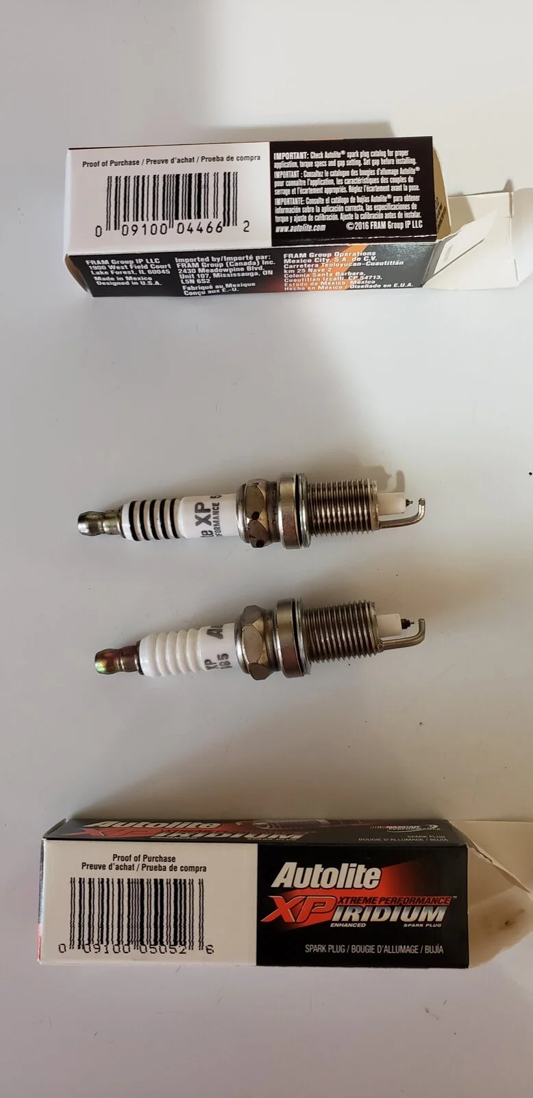

For anyone looking for a colder spark plug, check out the Autolite XP5405. It is the exact same plug as the XP985, just one heat range colder.
Autolite does in fact have other plugs that will fit the TJ; however, these plugs are not extra-long reach like the XP985 and XP5405, and won't start the kernel quite as far into the combustion chamber as the original plugs.
The only difference between the two plugs is that the XP5405 is designed to dissipate more heat than the XP985.

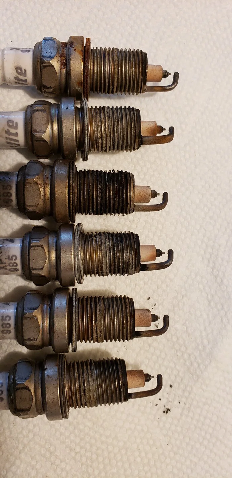

A wee bit toasty. And that coloration is not soot. There is a bit of soot in the exposed part of the threaded base, but all the colored stuff on the insulator and top is hard and metallic-like.
No pinging at WOT with the new plugs yet. Just need to drive a bit east and find a big hill.
