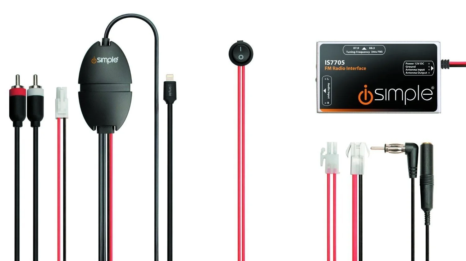

Hello All,
I recently replaced all the speakers in my '05 TJ, including the sub-woofer in the center console. When I changed out the head unit with a new Polk receiver it was not working with the sub-woofer. I contacted Crutchfield and they suggested a JVC unit, when I received the JVC I had the same problem with it not communicating with the sub-woofer. I decided to just keep the stock receiver. All I really need is an AUX and I'll be good. Do y'all have any suggestions? I was told about the FM Modulator(pictured below). Do y'all have any feedback on FM Modulators? Thanks for your help! And TJ on!
The reason your subwoofer isn't working is, very likely, because the original speaker wiring that was driving the subwoofer is no longer there, or at least still connected. The subwoofer gets its audio signal from the left & right speaker wiring so if you bypassed the OE wiring to connect the new speakers, that disconnected the wiring that the subwoofer gets its audio from. The OE subwoofer cannot be driven by line level output or preamp outputs, it needs speaker level power to drive it.
I wouldn't use that FM aux input for anything that you want to be full-fidelity like from an MP3 player. FM cuts off at 15KHz at the highest so nothing going through the FM radio will deliver the higher frequencies that make music sound 'alive'.

Jerry's advice (as usual) is spot on. I agree with everything he said.
