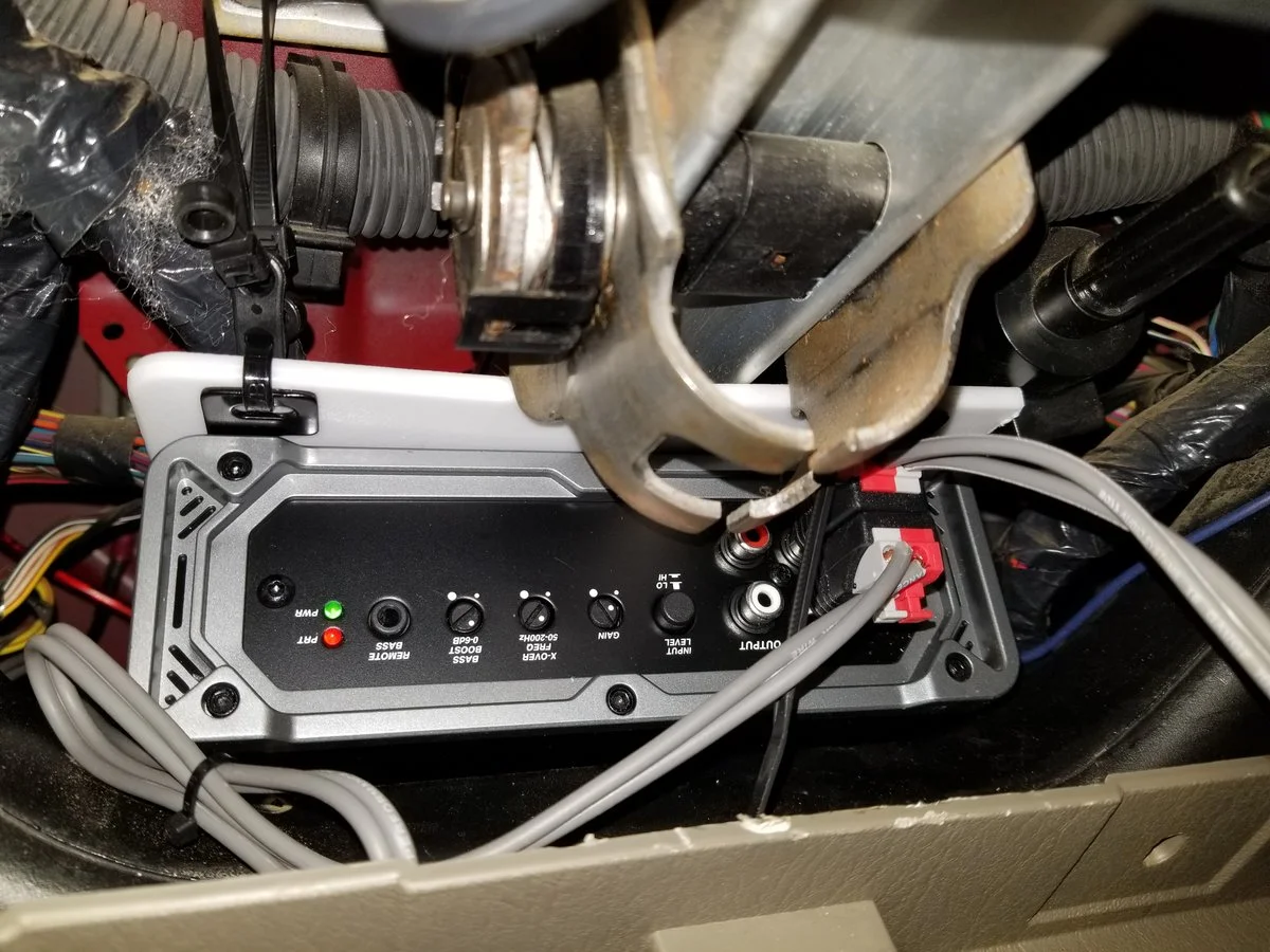

Fyi, I got the amp installed this weekend. During the install I was cussing myself and feeling like I should have 1. Found a smaller amp and 2. Paid someone to install it. Now that it is installed, I don't guess I care as much.
I used a cutting board with zipties. The sound is night and day better than it was. It doesn't rattle teeth like a 12" would, but it does sound good. Thanks for all the input!

Just so you know, that is a very low gain setting - unless it tuned specifically for that setting you can get a lot more of of your sub by turning that up 1/4 turn or to the 12 o clock position.
Thanks for pointing that out. I was surprised by the default 200hz crossover setting. I set the gain before I realized how high the crossover was. I'll work on tweaking the gain, um, again.
