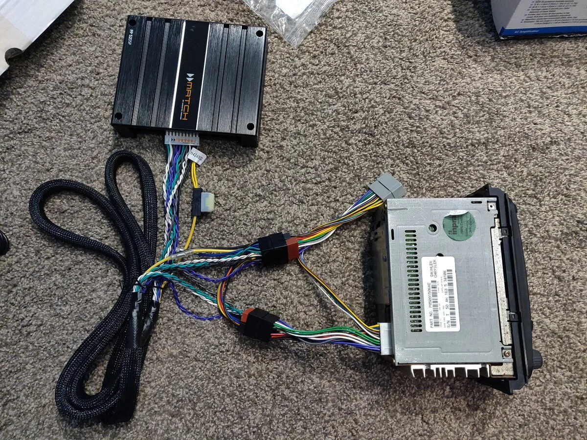

Chris, Audiotec Fischer, they make a plug and play amp/harness for the stock head unit. I sold one to @Tom18 - it's their lower model of amplifier, the Match line, and those models have PP in their name, which stands for plug and play. This is how it would look with the Match PP52DSP and Chrysler harness that they sell.
Nice option.

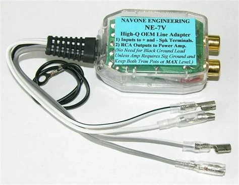

Rather than looking into Amps that have high level input, IMO line out converters would be a better way to go. That way you're not as limited with your AMP choices.
Here's a decent write up you might like, if you haven't looked into LOCs yet.
https://www.crutchfield.com/S-EYLG1A5kKgw/learn/what-are-line-output-converters.html
