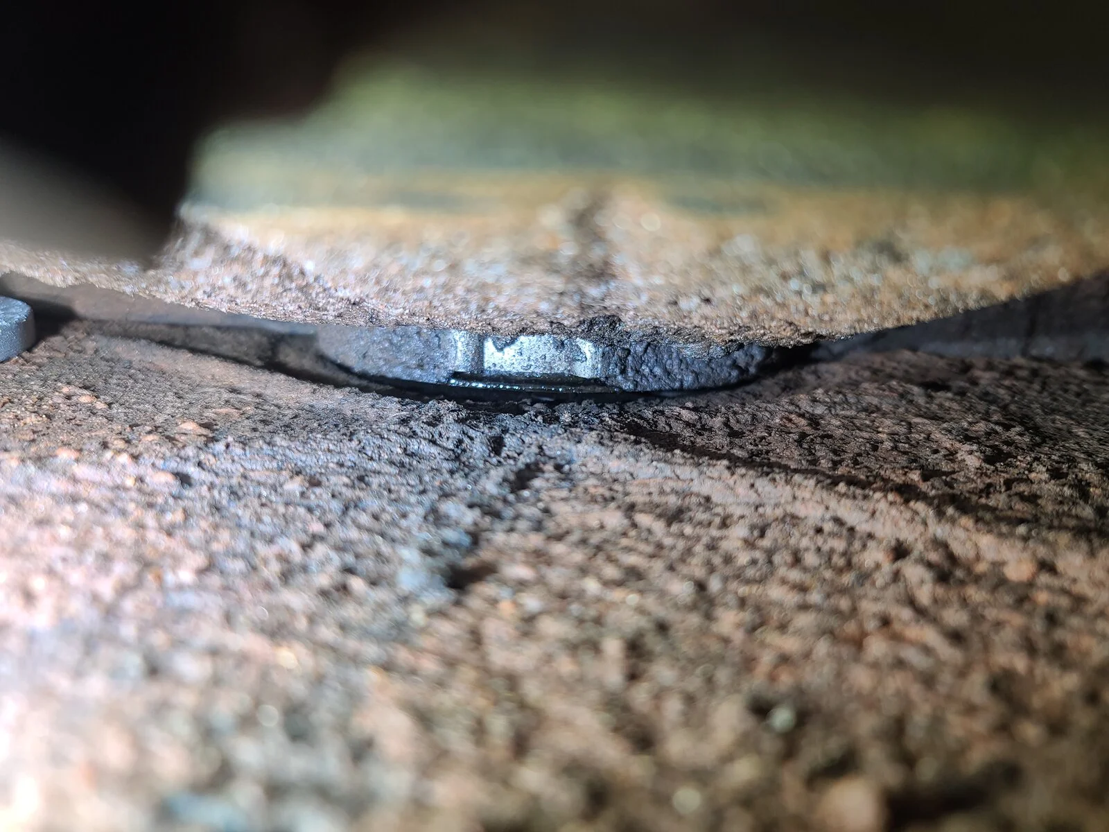

Hi everyone! New Jeep owner here, recently bought a 1997 TJ (manufacture date 09/96 - because apparently that does affect SOME components).
I am discovering that I have purchased a bit of a project, - but what jeep isn't a project - and crawled underneath to examine the exhaust to identify the source of an exhaust leak, when I noticed that at the front of the transmission there's a gap at the front plate of the housing. now, in my limited knowledge of transmissions (I've only ever seen an automatic from underneath) I would assume that i SHOULDN'T be seeing that gap? I'll take a photo and share it if that would help explain it better.
I would also assume that the transmission won't hold fluid with that gap there and that it could be the cause for grinding into 3rd & 4th gears.

I think you mean the inspection cover is missing? Can you see the flywheel through the opening?

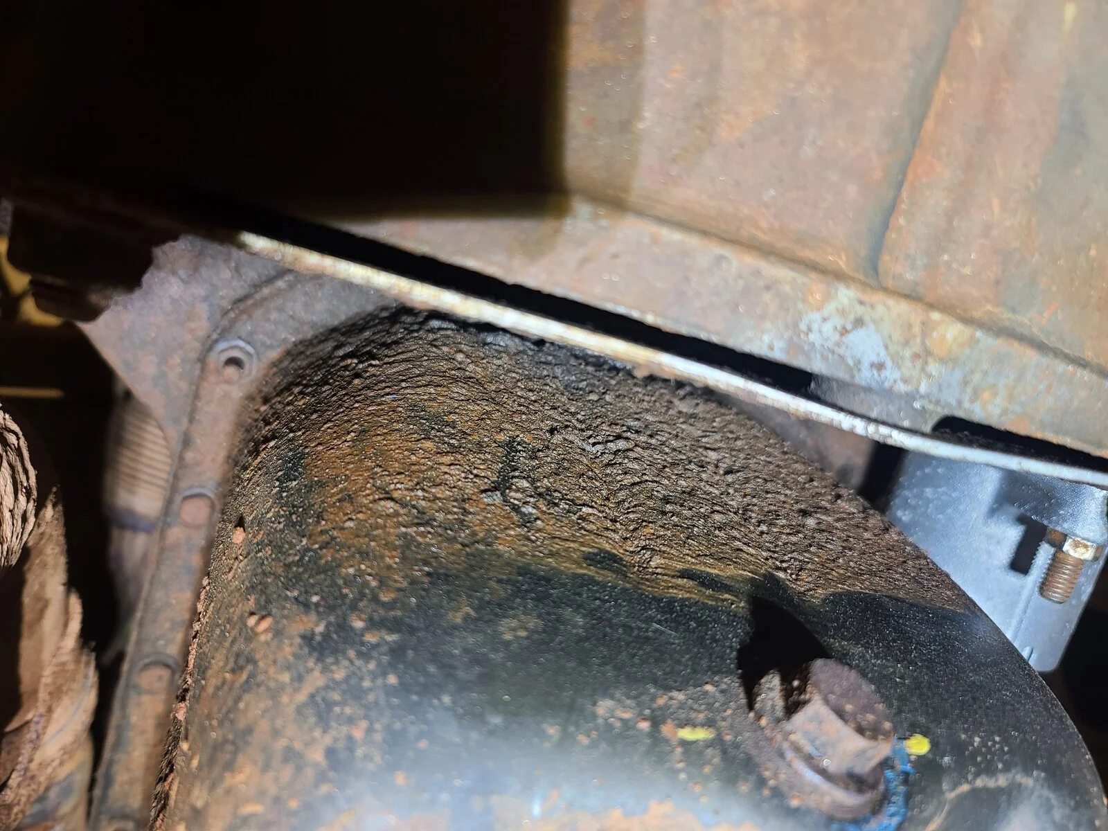

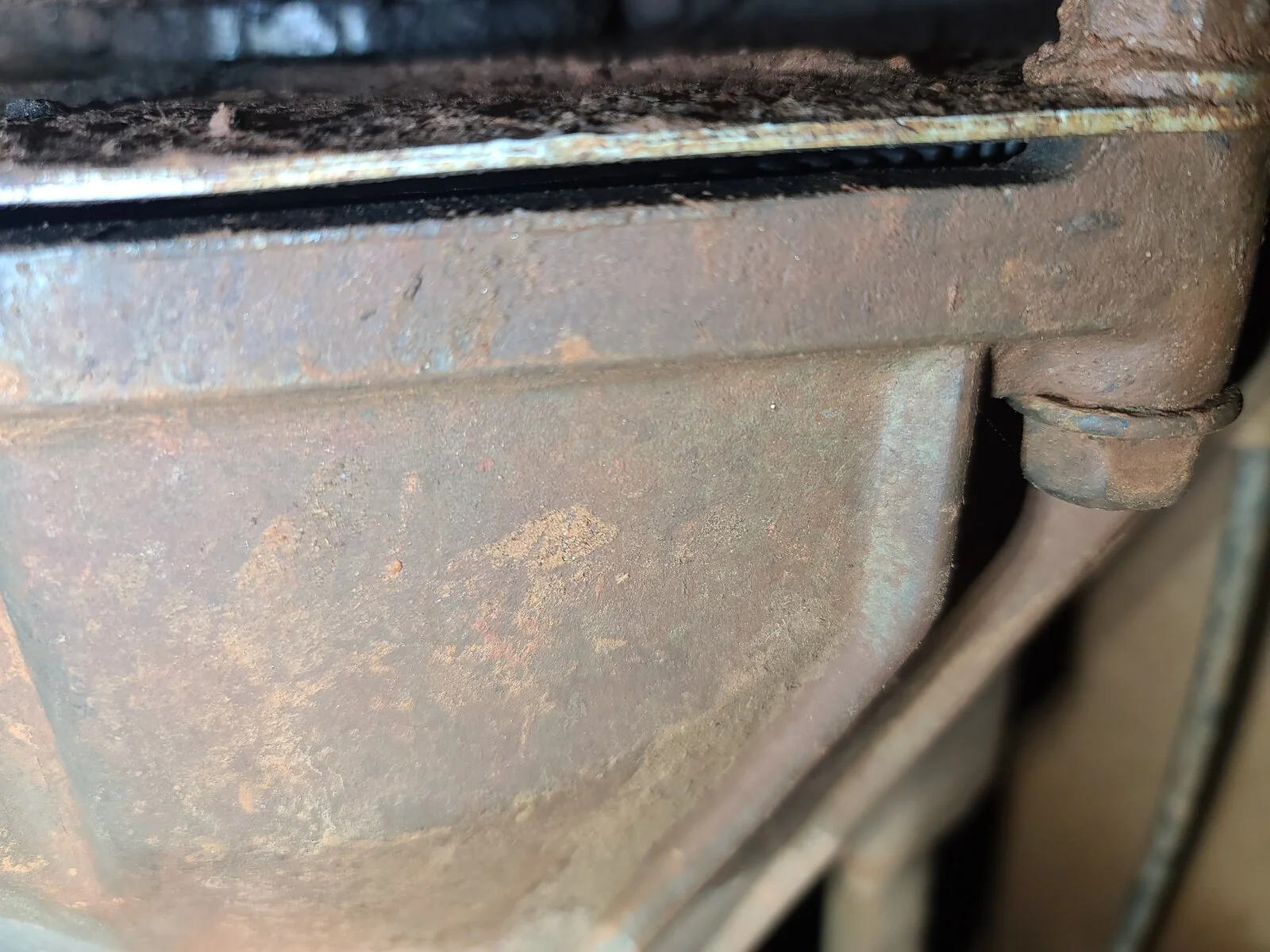

These 3 photos are from the same area, just different angles to give you a couple of different perspectives. The bolt at the bottom was missing as well. this is right behind the oil pan drain plug

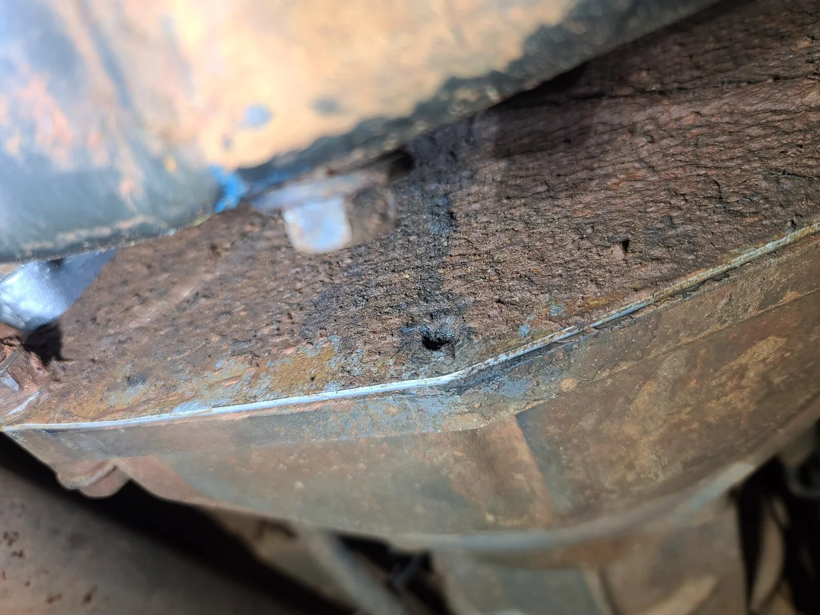

This next photo is up above in between the oil pan and the previously mentioned component. there is a leak of sorts there, anyone have any explanations for that?
That gap is between the Flywheel cover and the tranny housing, normal. The cover gets removed to inspect the flywheel and such.
The third picture shows what seem to be the motor real seal which have a minor leak. Unless the tranny its empty, i no see major leak that can affect the tranny operation.
As Jorge said the gap is normal and won't be your source for a poor shifting transmission. The grinding from 3-4 is odd but I would try draining and refilling the trans with the proper fluid and see what happens. The leak appears to be rear main/back of valve cover etc
Right on, thats one less thing to stress about I suppose. Thanks for the knowledge, everyone!
