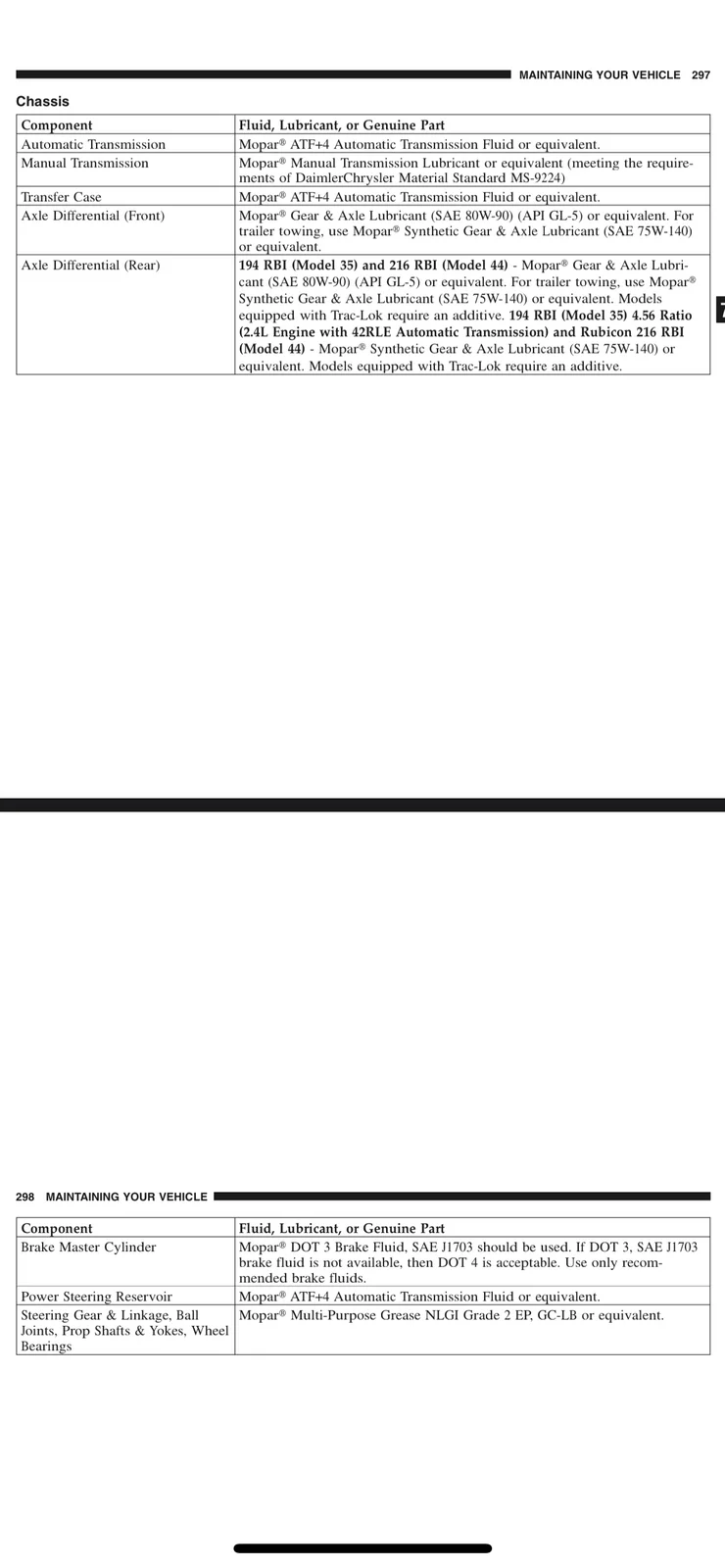

This is directly from a 2004 manual:

Maybe. As suggested above Redline MT-90 is best but it's not sold locally. So for needing to buy it today you want a synthetic 75W-90 GL-5 gear lube but only if it says this on the back label... "Safe for yellow metals". Don't even think about using a 75W-90 GL-5 gear lube in your transmission unless it says that.
Ideally you want a GL-4 75W90 synthetic gear lube as Redline MT-90 is but that is not available locally. GL-5 75-90 gear lubes are not normally ok to use in a transmission BUT if it says 'Safe for yellow metals' on the back label it'll be fine.
