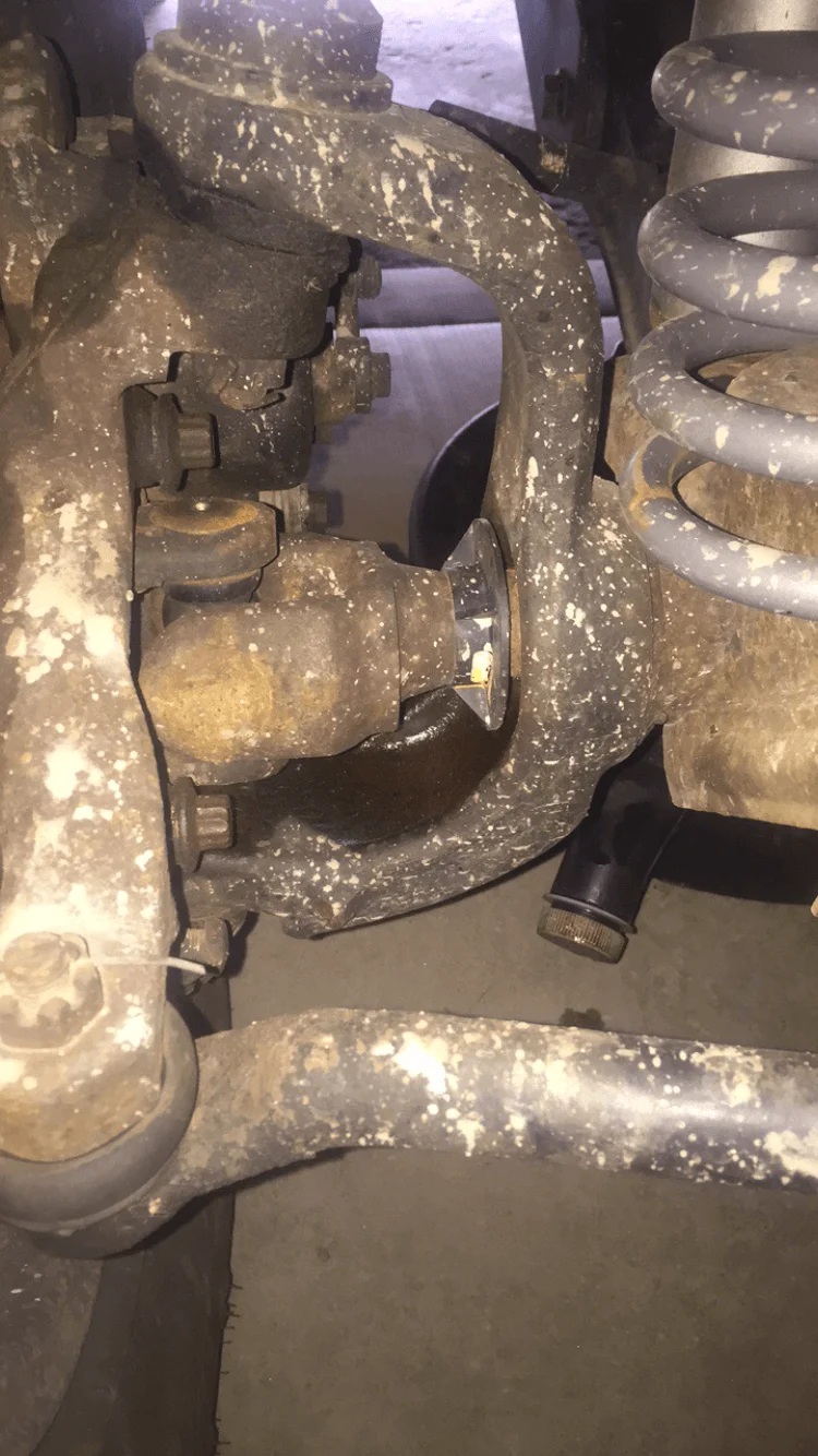

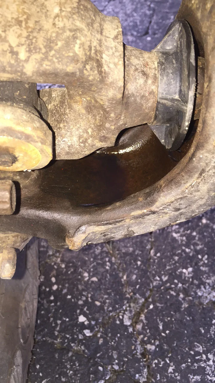

your picture shows the outer dust shield, the axle seal is in the differential called the inner axle seal? Is the inner seal what you have replaced?
Yeah I have replaced the inner seal I am just showing how much it is leaking

I have a stock diff cover and I filled it till it started coming out of the fill hole. I don't know the exact amount that is leaking out of it just notice a small drip in the driveway
