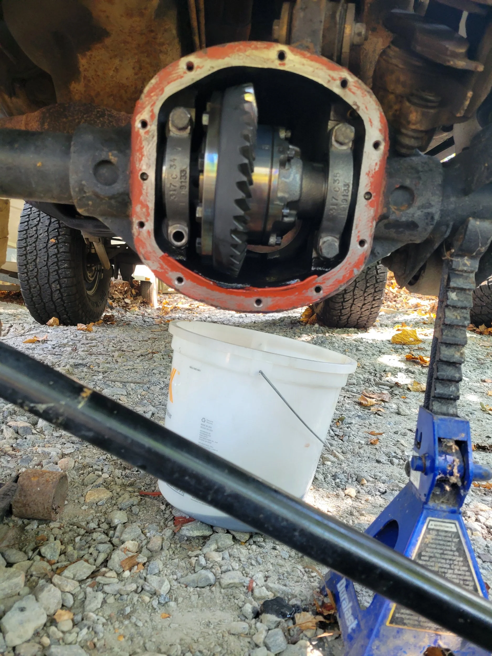

I have it all ready to pull the carrier (detroit auto locker) if I grab both sides I can kinda move it a hair but not yank it out. Im probably just being a bit
Reactions: John Cooper
got it. Helps if you remember to pull the passenger shaft out. :ROFLMAO: Im definitely playing the fool on this but hey learning new stuff. I definitely appreciate everybody replying.

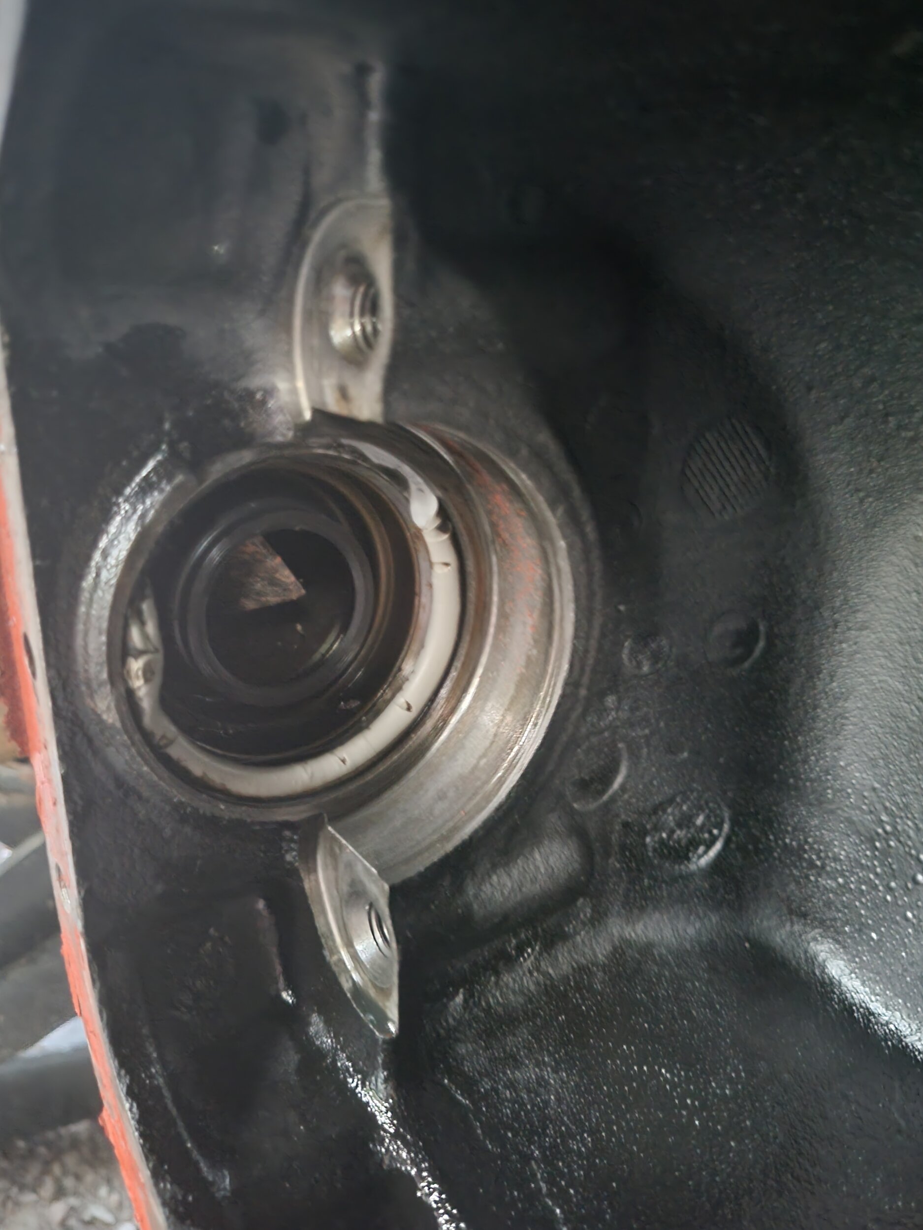

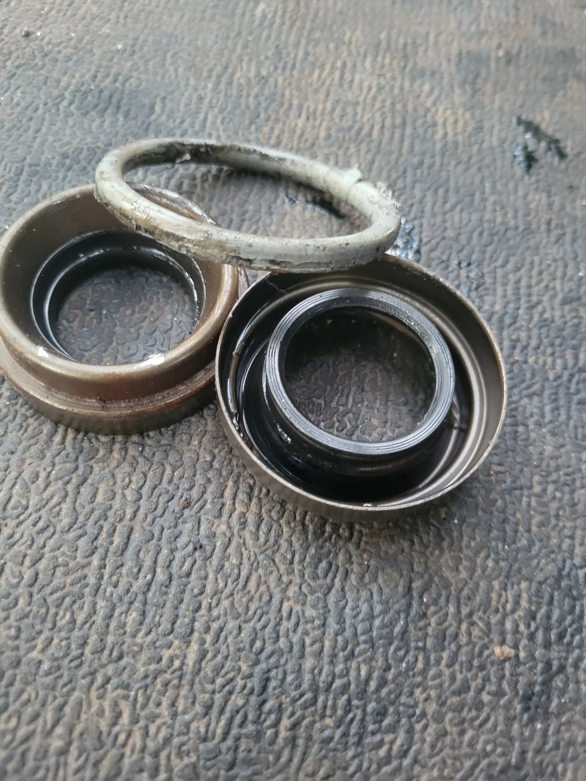

I got the seals popped off and noticed a rubber ring around the seals inside the differential. I dont remember that in @Chris write up or any videos I've watched. Any clue what it is? View attachment 643346
I don’t know why yours is white, but that should be the sealant from when the factory pressed the tubes in. It’s always been orange on every axle I’ve seen. It doesn’t need to be touched.
Thanks. It mostly ripped off on the other side. Is that fine. Can I just remove the remainder of it with no ill effect?
