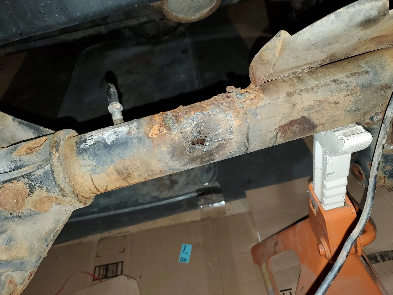

looked over the axles a little better how screwed am I with this hole ? Seems the PO cut off some brackets and burned a hole through the housing. Is this patch-able or will I need a new tube ?

Ouch.. No wonder you got it for a steal... I wouldn't run it if it was patched, but that's just me. You will probably need to have it re tubed, or maybe get an aftermarket housing.
any idea how much a re tube is or a aftermarket housing? I knew I would have to put some $ into the rear because he cut off some brackets but didn't see the hole.
I would strip down the axles and see what else is wrong with it. That hole and associated shit welds around it are concerning. Getting a new tube put it can be done a couple different ways, but will likely be expensive since it needs to be perfectly straight.
If it were me, I would clean all that shit up, fill that hole with weld, clean that up and then find a bigger piece of pipe. Cut that pipe up to about 4"-6" and weld that piece on top of the hole. You would need to fab the CA mount you plan to mount on there to fit over the patch.
All of that would maybe work. Based on the rust I see in the pictures, there maybe other issues elsewhere that would make all that work worthless. Take the brakes, backing plates, axle shafts and carrier all out and really inspect everything before doing anything else. That's my $0.02
