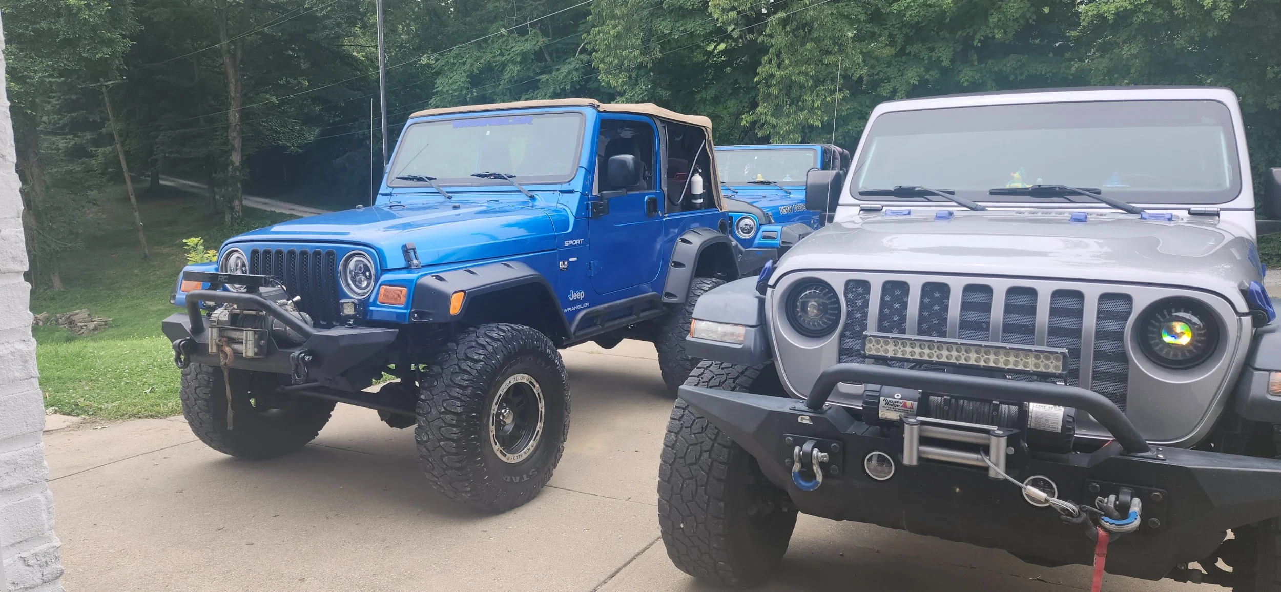

I just bought my first jeep this week. As far as I know so far, it's got 35s, a 3 inch lift, and a long arm kit for mods, and has a 4.0l/5 sp manual with 3.73 gears.
I plan on using it for running to the store/gas station and other small errands, and off roading on unmaintained county roads, creeks, and medium level trails. Don't plan on rock crawling with it or doing anything too crazy.
I plan on regearing to 4.10 gears, getting lockers, upgrading the dana 30 axles to chromoly, and upgrading to a super 35 kit for the rear. Would this be strong enough for my intended use?
Are there any specific brands/specs I should look into for the 4.10 gears and the super 35 kit? Anything I should avoid? Also anything else I should look into upgrading? Thanks for the help
