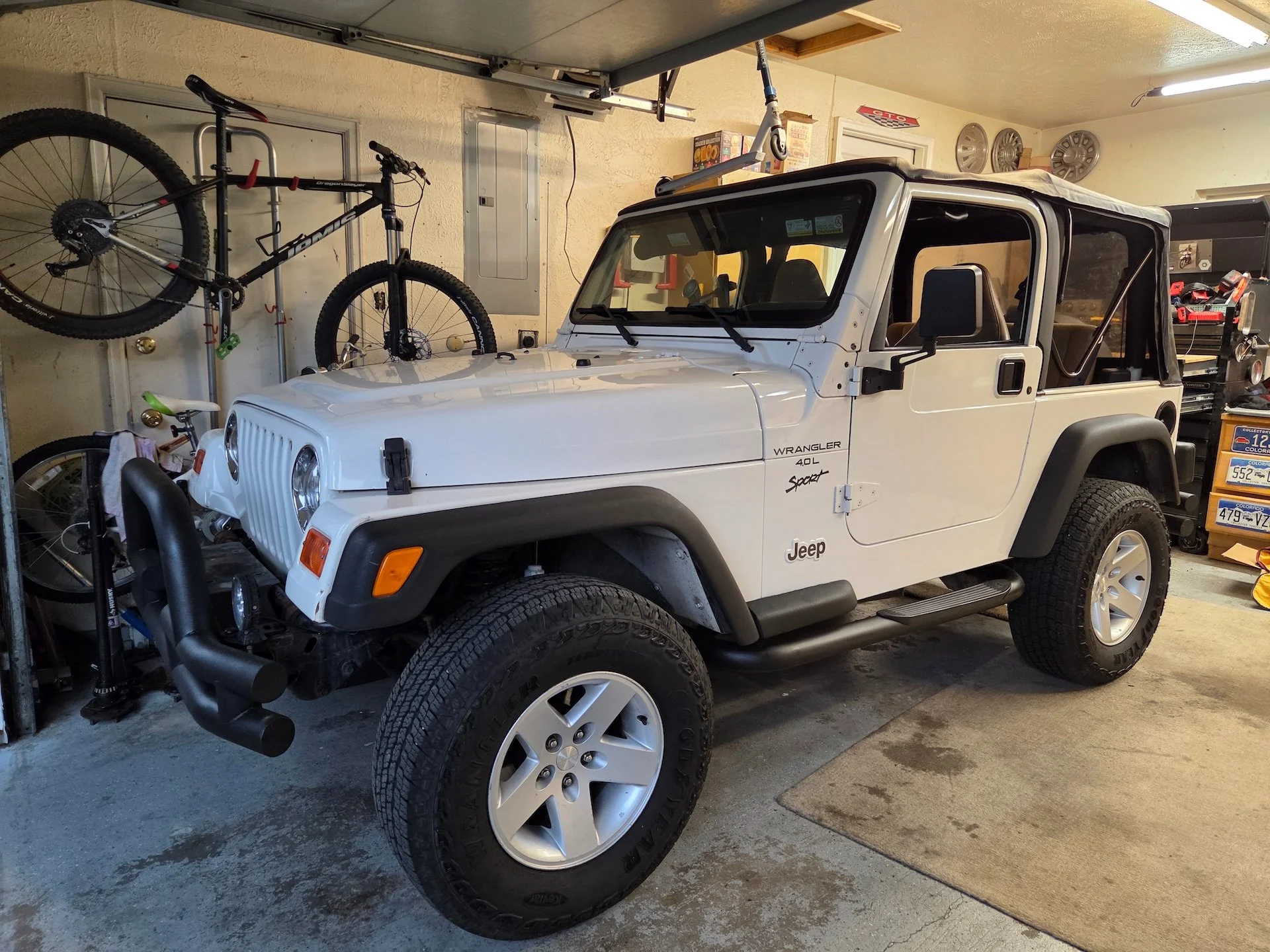

I have a 2002 TJ with a 4.0, 5 speed manual, 2" lift, and 3.07 gears and 265/70/16 tires (30.5"). This is mostly a street vehicle and I probably wont go any bigger with the tires I think these look right.
I have obtained a 3.73 front axle and a dana 44 with tracloc. The rear axle needs new gears and the front is good as-is. My options are to gear the dana 44 with 3.73's, or regear both to 4.10. Are the 4.10's necessary for this application?
