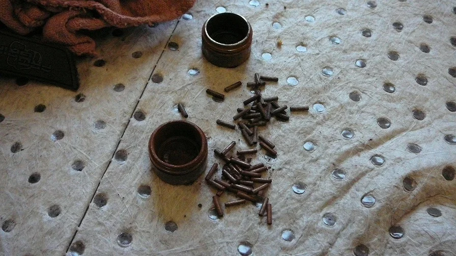

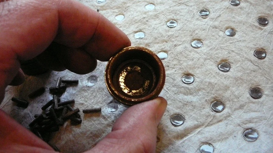

Just because your axle ujoints look like they are ok, they may not be. When I installed my BBK, I decided to change my axle u-joints since I had to remove the shafts anyways. This is what my ujoint needle bearings looked like when I removed the old ujoint.
I had no indication that they were that bad.
