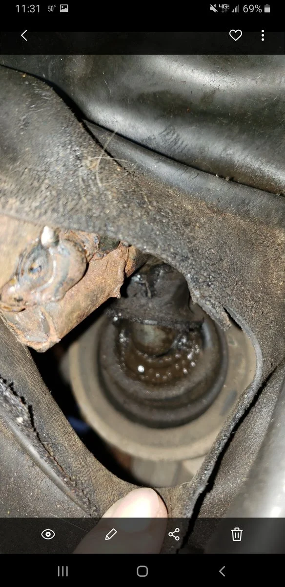

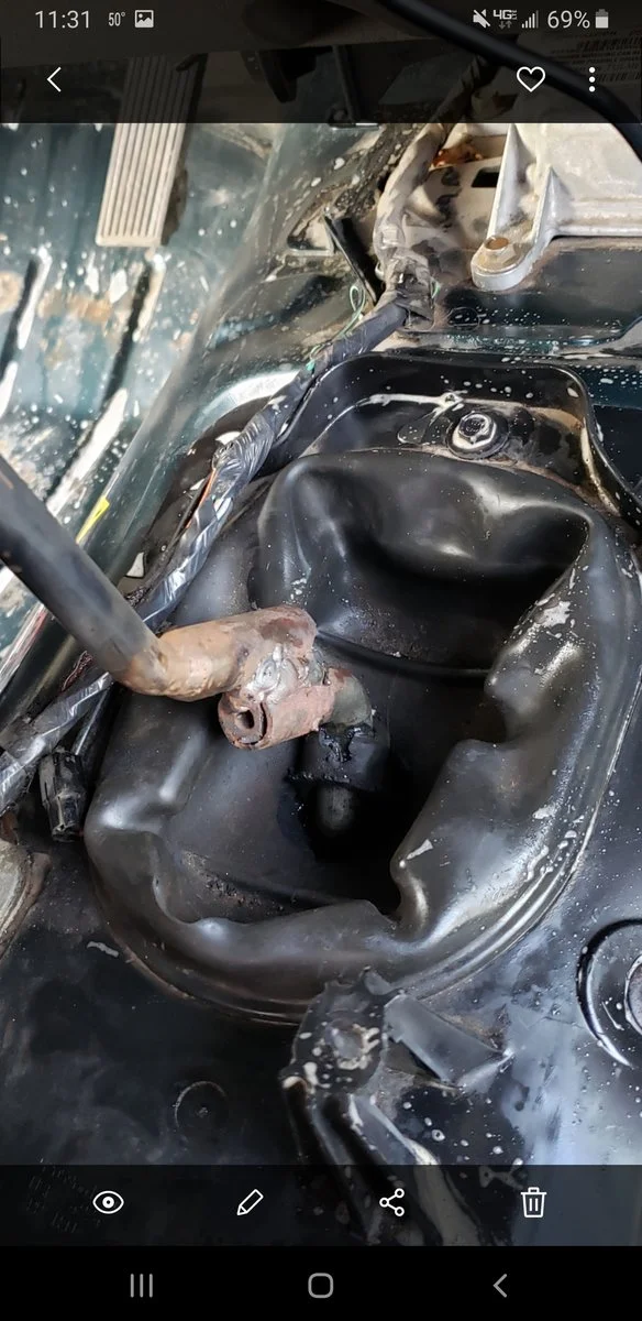

This is what I have currently, looks like shift lever is welded on and the rubber bit around shifter is dislodged. When I try to shift into reverse it's hard to go in at times and shifting in general feels like I'm hitting metal sometimes. I think problems are with shifter not transmission, does that sound like it could be the problem?
