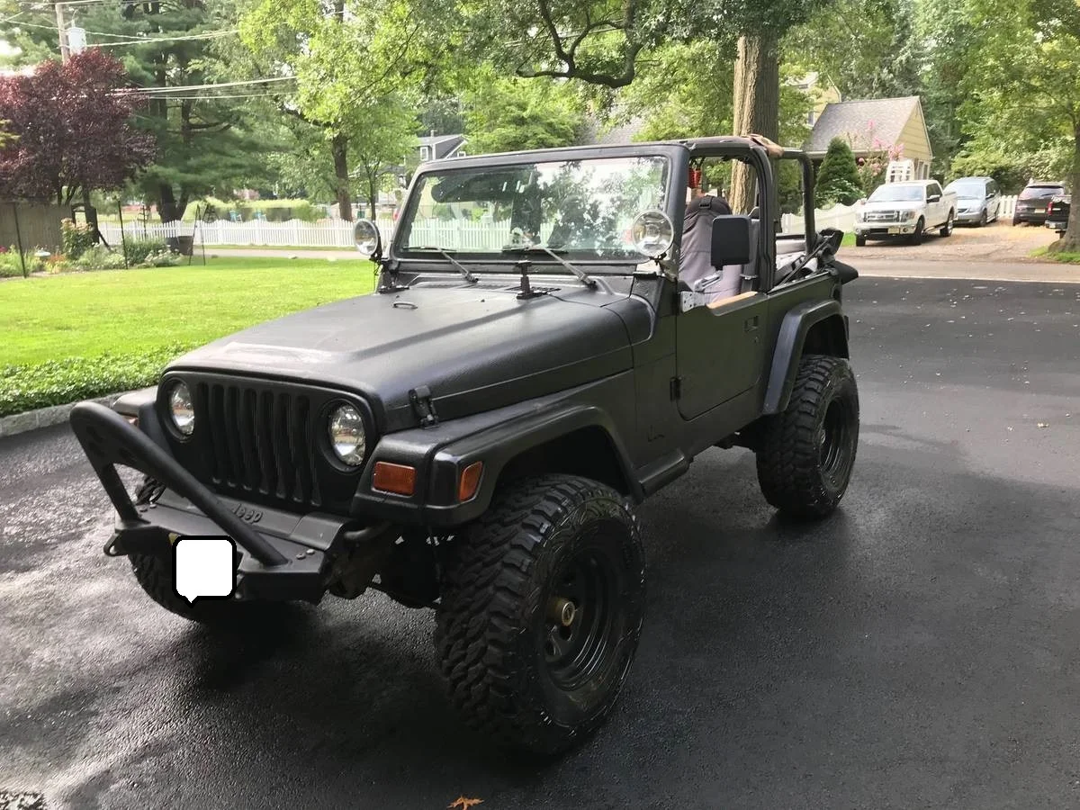

It has been a few since I've owned a Jeep. Recently acquired this 1997 Wrangler Sport 4.0 I6 and 5 spd manual. Came with a lift and 33" tires as well as some work done. Have been tackling the standard maintenance and correcting rust issues and patches here and there. New brake system fluid and flush as well as the parking brake adjuster clasp thingy. Rides well and picks up very well as well.
Have new seats coming(front and back) as well as rear seat belts and other things I want to change. Would not be myself if I didn't change something on it. I have read as many posts around here as I could search just to get myself up to speed with the Tjs. Only owned a CJ7, YJ and JKU at different times in my life.
I keep daily driving it to work as much as I can and making it more "me" as I go along. I'm in NY, just north of the City.

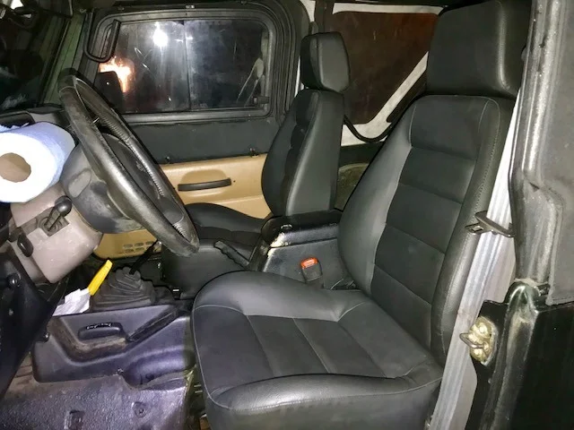

-New Corbeau Sport GT seats look amazing Brackets installed just need to drill and tap the rear bolts

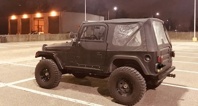

-Smittybilt bow-less combo soft top. This way I can use it as an extended bikini top when I want and not have too much bulk to worry about Decided to stick with the stock setup. New top with tinted windows installed.

Corbeau seat brackets were modified and man I like the seats. Cannot wait to install them.

Progress is a great thing. Still need to tackle the rear bolts as my drill bits were not the correct ones to eat through the stock bolts. The seats are amazingly comfortable and so much easier to get in and out of the jeep with them on. Managed to get everything on and only 1/2" higher than stock. Full tilt and recline.

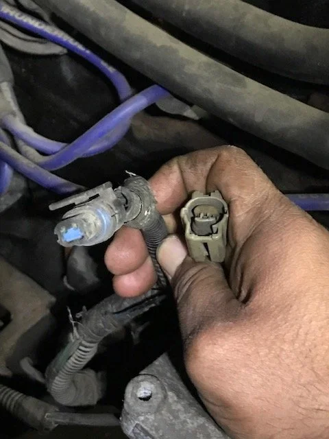

I was looking at the wiring and trying to make sure things are where they should be as I got a P0301 code recently. Wanted to know if anyone has any idea of what these two plugs connect to. Near the alternator coming of f the same wire loom.

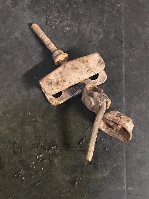

This doo-hickey was a pain in the butt to remove but I finally have a trustworthy parking brake
My list is almost done. Except for the door locks and certain things here and there and a pesky P0301 code that keeps coming up. Having a parking brake is such a nice thing to have.

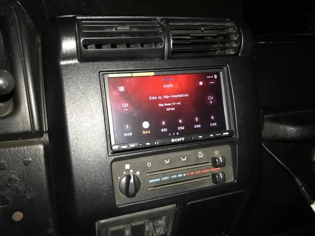

Finally got the new head unit and speakers installed. Had to deal with this mess from the PO(wire harness adapters, use them, don't hack)
Head unit is an XA AVX3000 Sony and puts out very decent power. With the now back to 4x6" Polk speakers up front and the boom mat enclosures, as well as the four speaker and dual tweeter rear overhead sound bar, the sound is much fuller and crisper. May not need to go subwoofer for a while. Now I find myself lowering the volume to hear the motor lol
Cleaned everything up up front and taped over any exposed wires plus added the mic for the hands free. Easy.

The driver’s seat and passenger are secured as well using grade 8 7/16-20 and locking washers.

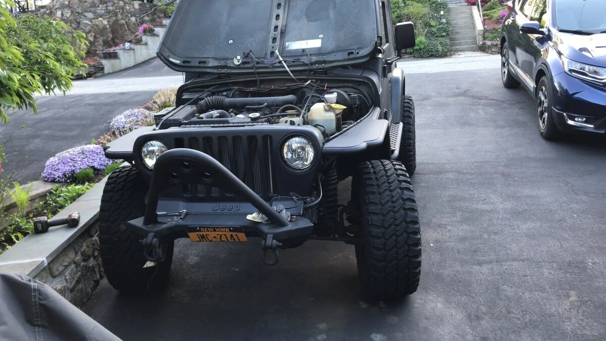

Getting the front bumper finished for the weekend and will be mocking up the fog lights to finish it off. Not crazy about the spotters that we’re on it and NY can be funny with that. I’ll leave the brackets there as I could probably use them for rear view mirror locations when the doors are off. May become the stock mirror locations if all goes well.

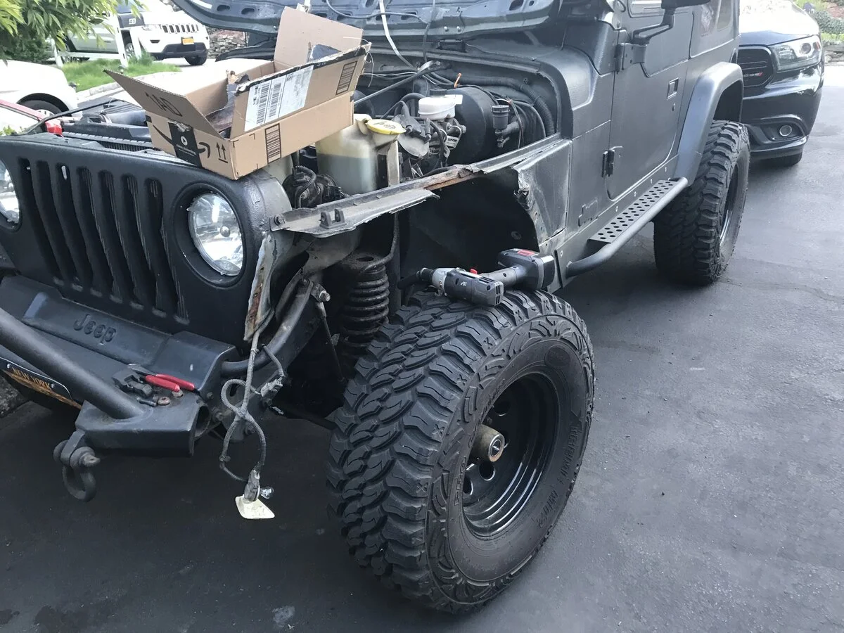

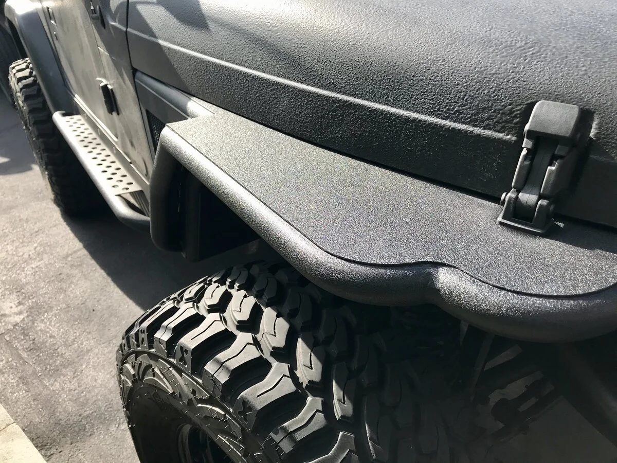

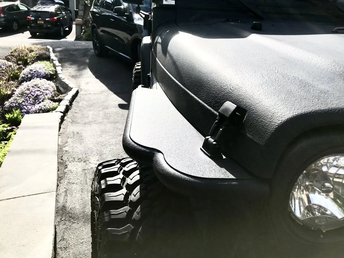

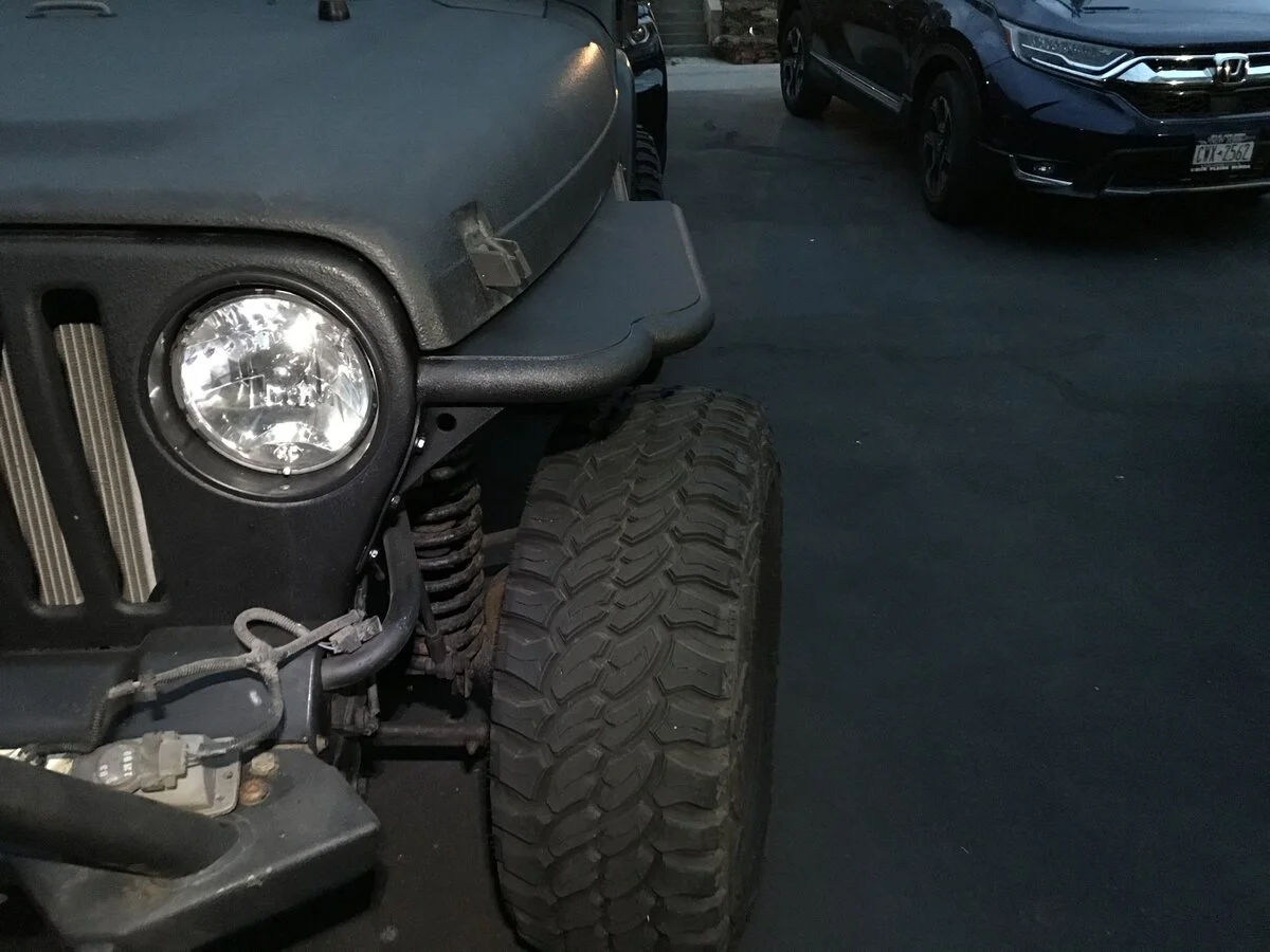

Got my tube fenders from EAG on Saturday and super excited to start chopping the rusty ones. Have to paint the EAG units with good ol’ POR. Went with the 3” flares as this is a daily driver.
Lube changed on the Dana30 and upgraded the cover to a nodular steel one. Will keep it and just upgrade the axle for longevity and maybe a Detroit locker, maybe.
sye kit and gathering a list for a stroker build.

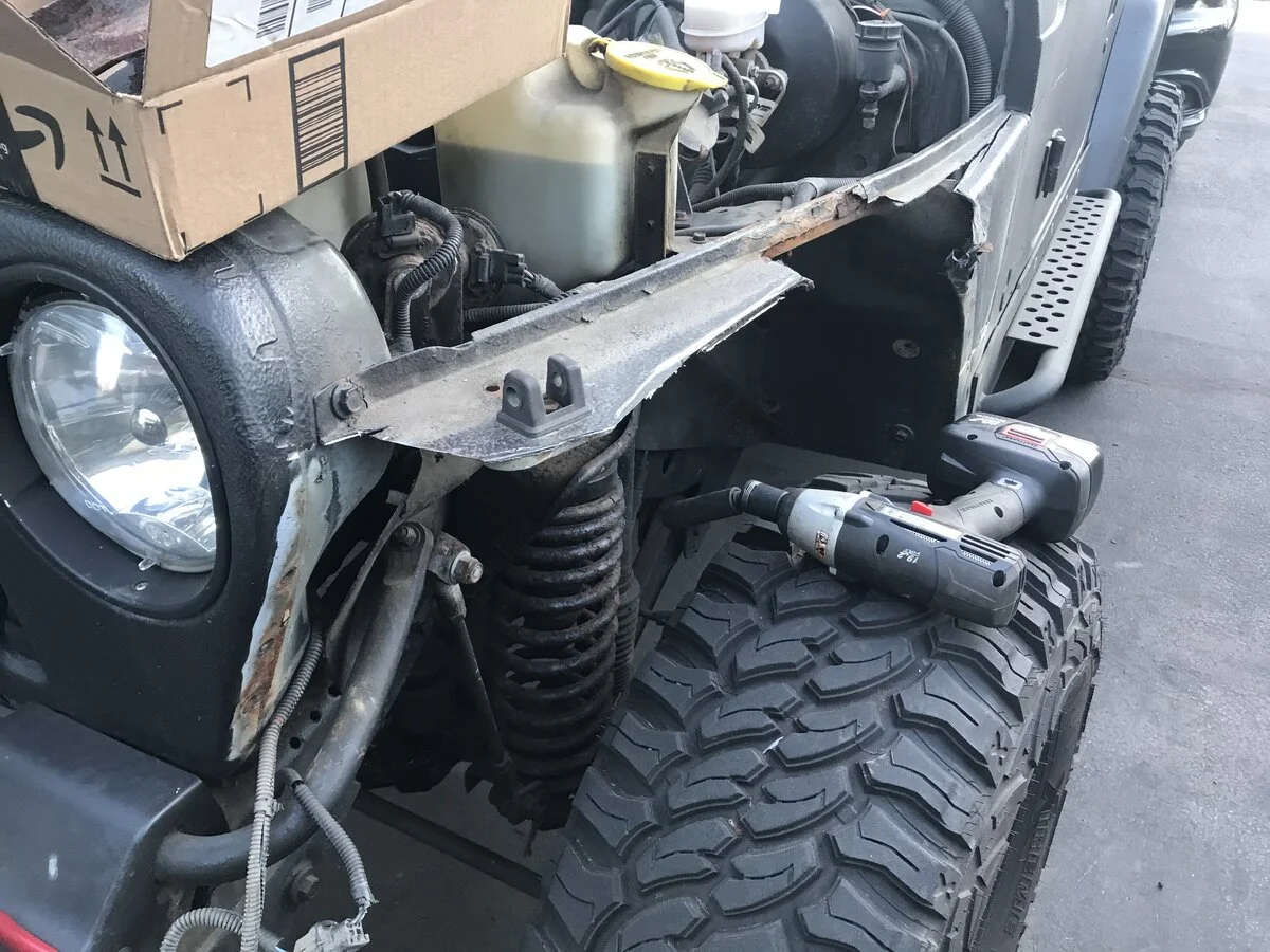

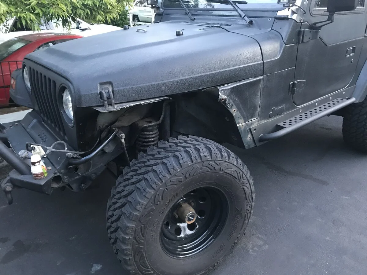

Tube fenders are on. What a PITA it was to remove the rusted bolts and follow the more than vague instructions. Should have purchased new bolts for the body-to-fender area. Note to self for later.
The fenders are on. Aligned as best as I could and will remove them in the summer to apply some body sealer to all of the areas that meat the body or are metal to metal. Just do that I can sleep better is all
next to do on the fender install is the LED lights and flasher relay for LED. Decided to just buy a relay and save the stock one just in case.
Every has been painted with POR rust converter flat black and then followed with gloss black. Painted the inside of the wheel well as well because it just looks better and will protect the paint against rust and such. Yes, the four bolts for the inner lower arch aren’t on, but I’m waiting for the paint to cure in that area.
Metal brushed off and sanded as much of the rust as I could prior to painting didn’t have to cut much from the passenger side batter tray, but the driver’s side needed a good 3/4” trim. Two bolts snapped their heads in protest but it will be fine as the fenders are held in by three body to fender bolts plus the bolt for the frame sliders on the side(still need to drill those)
All in all I’m very happy with the finish of the fenders and looks, as well as not having to worry about pieces of rust falling everywhere I park.
Just have to finish up the lights. Looks a whole lot better and it’s all secured. We shall see how long it will last.
