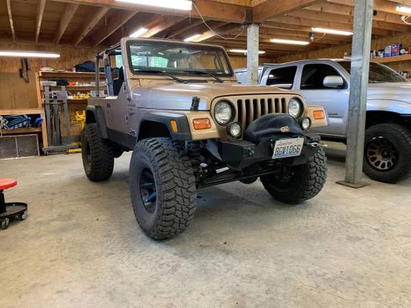

lastly here is a copy of the listing for the Jeep. Let me know what you guys think and I am looking forward to being a member here!
Listing Below:
Downsizing and selling my much loved Wrangler. It has zero issues, runs & drives great, is rust & dent free, and requires nothing. My goals just shifted over the past few years, and a dual sport makes a lot more sense for me.
Basic Info:
164k miles on body, axles, t-case
4.0L-reman@2500 miles
32RH (really a 727 with a sensor) 3 speed auto-10k miles
231 T-case
Dana 30/44 axles 3.73 gears
Comes with a bunch of parts and extras. It's ready for an axle build up. Paint is OK- its been through brush and has some scuffs and scrapes. Nothing too bad. I've fixed and sealed any bare metal showing.
It has fresh remanufactured engine (bought thru Napa/ATK w/papers) and a rebuilt transmission. Axles are 3.73, which is actually a good surprisingly good combo with the 35's.
Upgrades:
-ATK Reman engine- factory specs, 2.5k miles.
-Rebuilt transmission w/ deep pan, 10k miles ago
-Teraflex super short SYE https://teraflex.com/shop_items/tj-231-extreme-short-shaft-kit
-Tom Woods High Angle rear driveline https://4xshaft.com/collections/jeep-tj/products/tj-rear-drive-shaft-cv
-Savvy cable transfer case shifter https://savvyoffroad.com/product/sav-231s/
-Rough Country 4" lift https://www.roughcountry.com/jeep-suspension-lift-kit-906s.html
-Rough country HD steering https://www.roughcountry.com/hd-steering-kit-10604c.html
-Rough Country Dual Stabilizer https://www.roughcountry.com/steering-stabilizer-87308.html
-Hook Road Steering Brace
-Rough Country Stubby bumper w/D ring kit https://www.roughcountry.com/jeep-stubby-winch-bumper-1012.html
-CSI 8k Winch w/ synthetic rope
-Poison Spider BFH II rear bumper w/brace kit https://shop.poisonspyder.com/TJ-BFH-II-Rear-Bumper-p/14-61-030.htm
-Smittybilt SRC cage kit- https://www.smittybilt.com/product/index/90.htm
-Mastercraft Nomad seats installed on TJ sliders http://www.mastercraftsafety.com/product_p/seat-nomad.htm
-Genright Stereo Panel with SSV https://genright.com/products/ssv-mrb3-bluetooth-media-controller-w-screen.html
https://genright.com/products/genright-ssv-mrb3-dash-mount-kit.html-BOSS Marine speakers in Select Increment enclosures

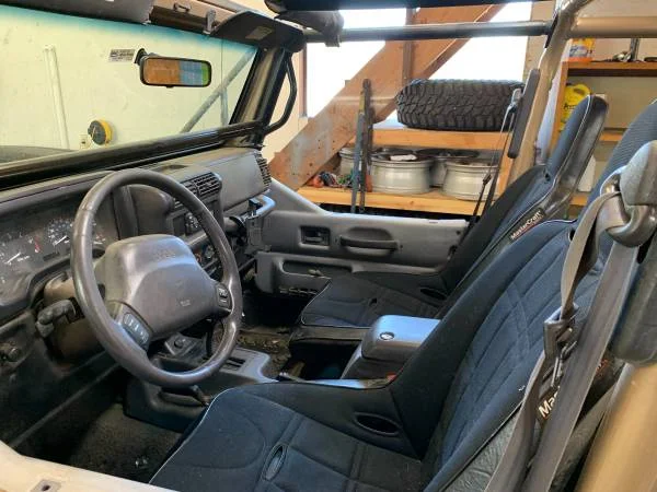

-Entire interior was stripped and coated with bedliner-

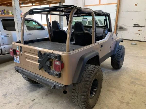

-Rear seats have been removed and a rear deck/enclosure is installed in its place. This allows the entire rear area to be locked. The deck is also coated, and has a latching setup to attach a large milspec rotomolded drybox via butterfly latches.
-Comes with 9 MATCHING Mastercraft MT tires. 5 are mounted on Ultra wheels, 50-80% tread life. 4 are studded and mounted on black steel wheels with 95%+ tread. The studs are awesome for icy roads and deep snow-Almost $3k total for all this when new.
Extras-
-Spare (used) transmission, functional when I removed it and put my rebuilt unit in.
-Spare Dana 30 front axle from another TJ
-Set of paint matched half doors and full doors, all in excellent working condition. The half doors were rebuilt by me and have some minor plastic fading and cracking from the sun.
-Bestop frameless top (2 yrs old) and Bestop bikini top
-Milspec drybox that latches to the rear deck. Has pressure valve for elevation changes.
-AC kit
-Mirrors
-tons of other parts, gaskets, seals, extras.
THE BAD:
-Swaybars are removed. I have zero issues driving it 65 except for really sharp corners, but be warned.
-AC is removed. I never put it back after the engine swap. I have the parts still, compressor is still in. Havent needed it.
-Occasionally drips oil. Despite the new engine, the rear seal appears to leak when the weather gets hot. I keep the engine topped a little high anyway, so its never been an issue.

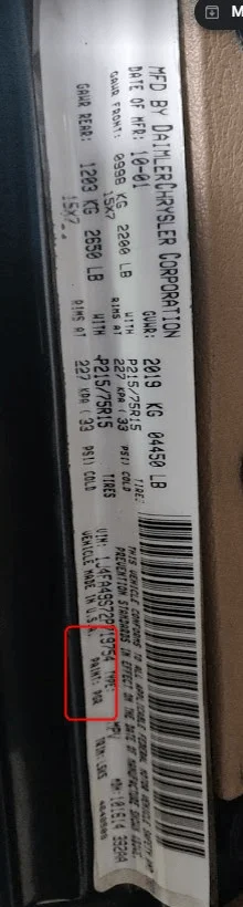

Thank you! Side question to anyone, does anyone know the paint code/ name for this color? Is it the PV3 / Amber fire?
Assuming factory paint, have you checked the VIN tag on the door jamb?
