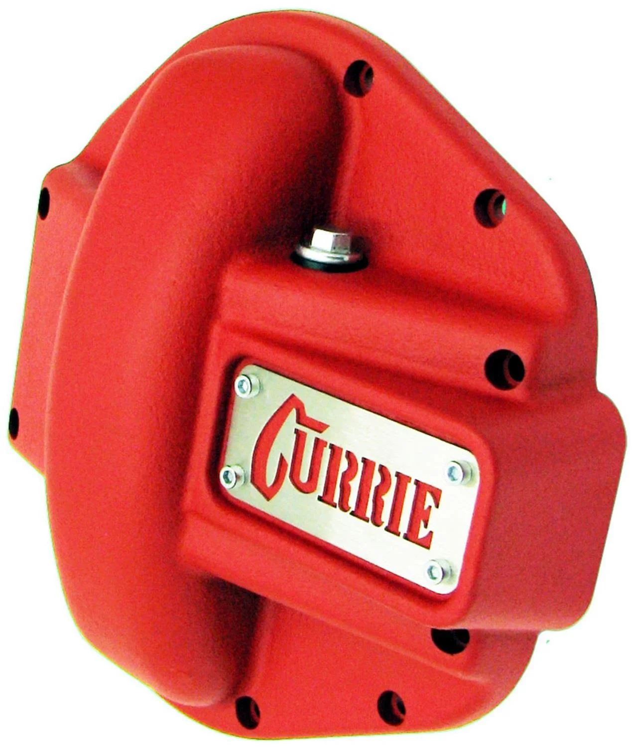

Maybe 4", only need the hose snug don't need to kill it. I also have Currie covers so it helps that the fill hole is flat.
