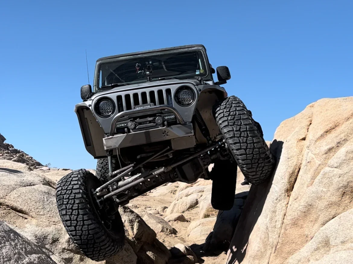

Since you can weld, the diy kit would be a good starting point for you to improve on the design by copying a few key details from Savvy.
First is to extend the winch deck back to capture the sway bar mounting holes on the frame. This will total 10 bolts attaching the bumper to the frame and will create a very large reenforcing gusset.
Then add a raised lip to the lower horizontal face to brace against the front frame crossmember tube. Doing so will keep the bottom of the bumper from deforming upwards when you use the bumper to push the front end up onto the rocks.
Finally, make sure the fairlead mount is back enough to place the hawse fairlead a bit behind the leading face of the bumper. This will help protect the fairlead and winch rope from the rocks.

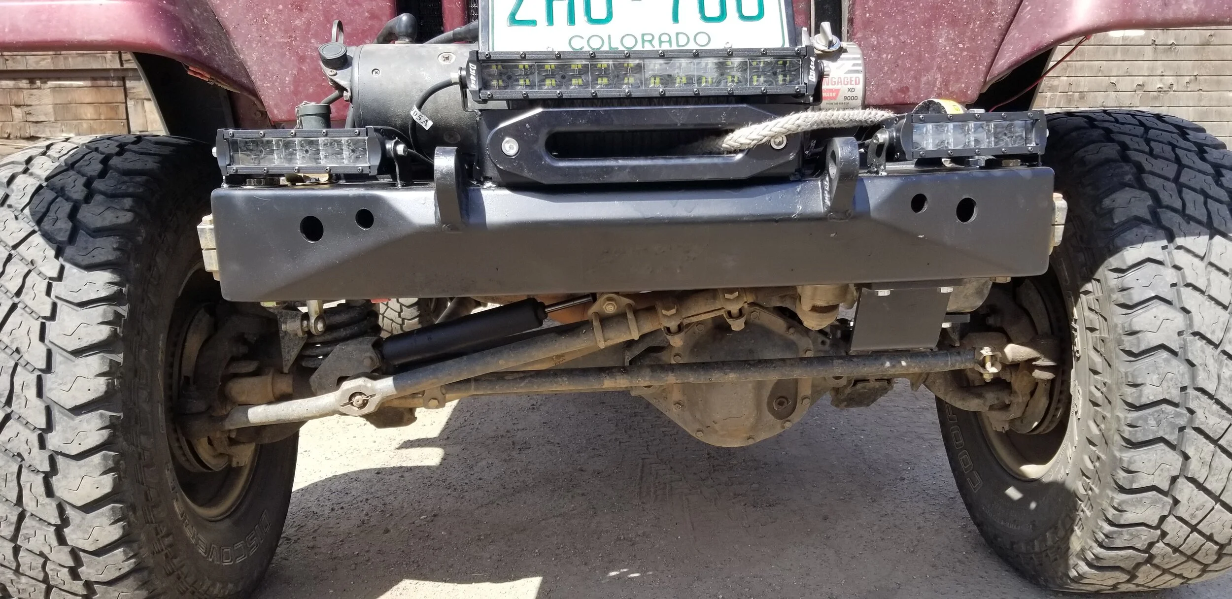

I have the Barnes bumper. Paid less than the 500 they want now, but I like it a lot. Well made..mounted a warn winch on it no problem. Seems solid and doesn’t interfere with anything.

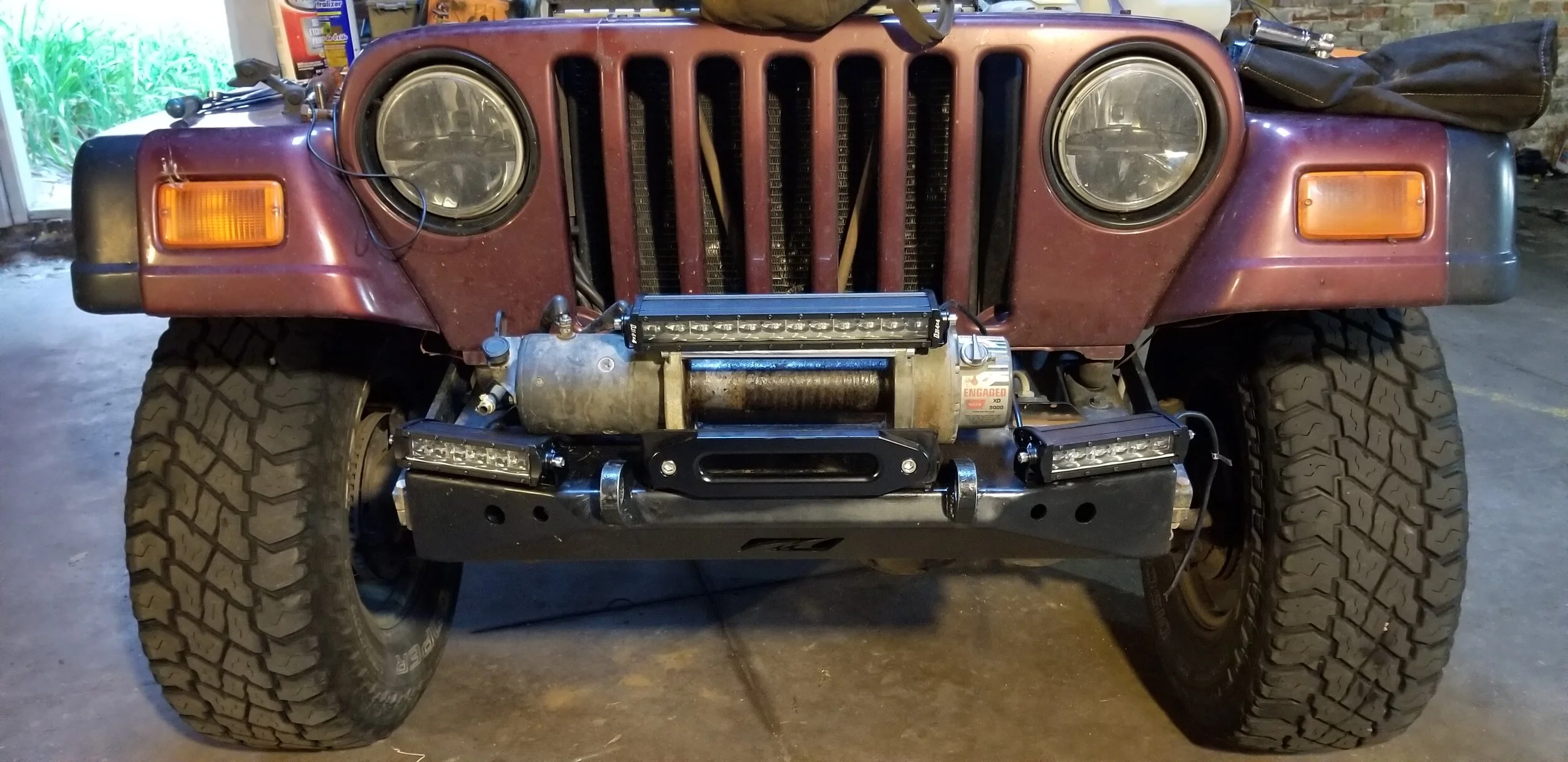

I cut out the Motobilt logo on mine and welded in a patch. Both for the reasons of durability you stated adds because I want as few advertising logos on my Jeep as possible.
I have their rear bumper and turned the B into an S, because that's my last initial. 🤣 It's also a lot less noticeable if you paint the bumper black.

Another vote for the Motobilt stubby.. Looks very much like the Barnes.
I really don't care about the logo so didn't make any effort to eliminate it. Same logo is on my fuel tank skid and the Seven Slot logo on my rear bumper.

I have the bumper in question and I like it. Doesn't interfere with the winch and I was recently in a accident and it held up just fine. I also didn't pay what they want for it now.
