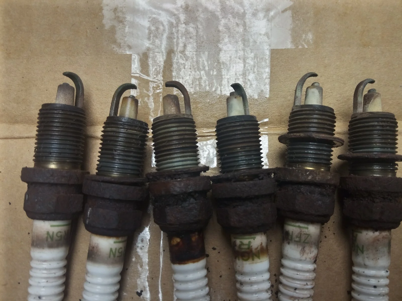

For the spark plugs how much force is too much when removing? I have no clue when this job was last done. I sprayed kroil 4 times a day and blew air once a day for 48 hours straight because it was pretty rusty. I watched the kroil literally go into the plugs. Still I had to use 60 ft pounds of torque to remove 4 of my plugs. 50 to remove one, 55 another. I had only a 3/8ths drive small wrench and 1/2inch drive torque wrench on hand, so I didn't use that torque wrench for tightening the spark plugs back up. I just used a 3/8ths until tight....then I checked them all again and give them a bit more turn because I'm a small guy and the wrench was only 8 inches long. Hopefully I'm okay.....afterwards I went out and bought a 3/8ths drive torque wrench, still a bit bigger than I would have liked at 14 inches. That's only 4.5 inches shorter than the 1/2 inch drive. But the 1/2inch is for 20-150 pds, where as this 3/8ths is 5-80 pds.

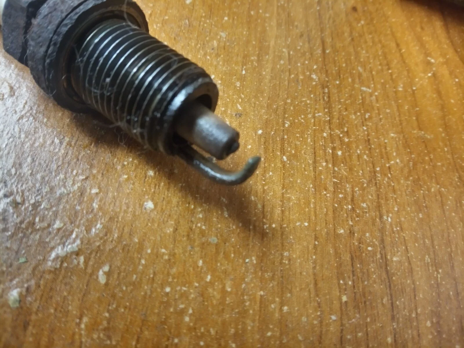

I've got autolite xp985 I gapped them to .035. They were all .025-.030 when I bought them, in case anyone was wondering. My old spark plugs were the recommended NGKs all had a gap of ABOVE .060? I literally couldn't measure them any further, must be at .070 atleast. Is that normal and how did the jeep manage to drive at all? Keep in mind this is just preventive maintenance. I didn't notice issues before hand with the running of the engine.

Spark plugs, as they wear, generally increase their gap with time. Depending upon the strength of the coil, this may or may not cause a significant issue. At best, it may alter the flame pattern and reduce power or efficiency. I've also found mega-gap plugs in other cars that otherwise ran fine.

Even though I went with the xp985s, im probably gonna pull them at 30k miles to see how they look, torque them properly, and apply the antiseize which I didnt do the first time. As you probably guessed this was my first time doing plugs and I was very surprised with how hard it was to come out and how wide the gap was. The tips looked pretty much shot.

them look like they've been in there awhile. might be original looking at how rusted they are and the wear of the electrode !

Yea that was one of the worst off ones, but I was still not real impressed when I saw what they looked like.

wow i bet it runs like new with new plugs, the 1st 3 look like they were wore slap out many miles ago !!!!

She definitely was shaking a bit for sure during the first start up of the day in colder weather. No more. Also peppier and likes to start off in second (6spd) a bit easier on those flat spots. But at 148k miles I'm not sure they're the original plugs. That would be crazy. However I did find the original stickers with vin on the frame and shocks, some other stuff like the lj body tag. It had a few owners, but seems it was daily driven. That still means quite a bit of rust however anyways because CNY lol.
