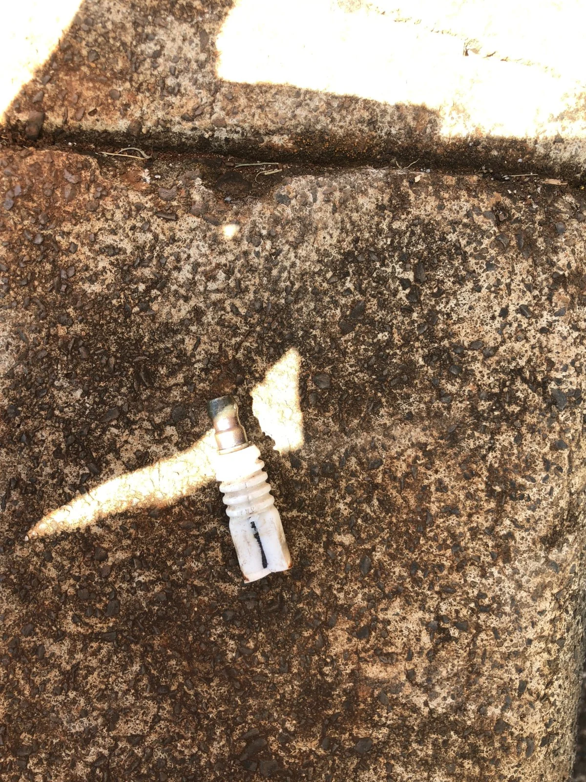

Well i just broke off part of plug... trying to use a screw extractor but it’s not even coming close to getting in
that's just the porcelain, the hex part should still be there with any luck. If you broke it off flush to the threads you are in for a heap of misery.

What he said. Try working the thread both ways, some times that helps the penetrating oil to do its job. Just don't get too crazy on the torque in either direction.
Also, make sure you get any of the broken porcelain bits out of the spark plug well before you actually remove the plug. You don't need those pieces dropping down into the cylinder. The fact that you've soaked the surrounding area with penetrating fluid might help in keeping the pieces from dropping into the cylinder, but I wouldn't want to take any chances. If you have access to some compressed air, blast down into the wells before removing a plug. And be sure to protect your eyes when doing so.
