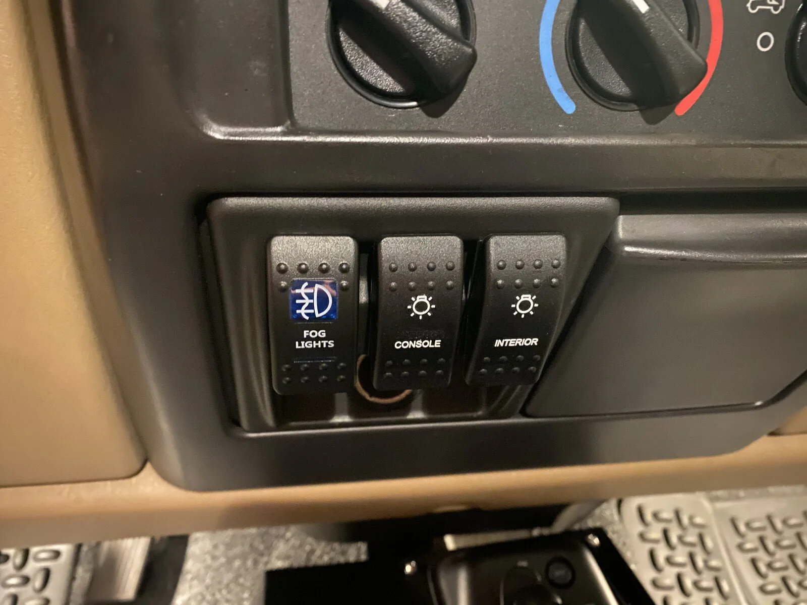

I used the Quadratec fuse tap as well, but wired it to a switch on the dash panel (far right). So when the doors are off (or if I need to leave a door open for an extended period of time) I just flip the switch.
