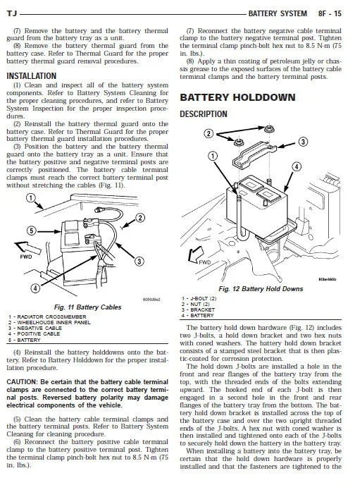

What year Jeep do you have? The hold down resembles the JK version.
In your case if the screw broke you might have to drill and tap it
Here is page 8F - 15 from 2006 TJ Service Manual
After a quick internet search, it looks like at least some 2005-2006 TJs use a wedge block instead of the j-bolts, although the FSM doesn't show this.
As to the OP's question, if I understand correctly the shaft of the bolt broke and you were able to remove the wedge block and the battery, but now you cannot secure the wedge block back to hold down the new battery? If so, you could try to remove the entire battery tray and see if there is enough of the bolt shaft showing to grab onto with a pair of vice grips to remove it. You can use a number of methods to persuade it (penetrating oil, heat , shock) if you can get a grip on it..
Good luck.
