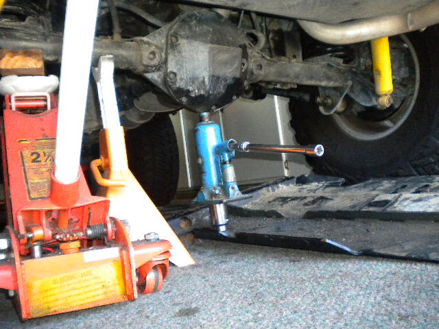

Mine didn't budge until I focused all the TJ's rear weight onto 1-2 square inches at a time via a big 1/2" drive socket. The hydraulic bottle jack I used allowed precise control of the weight, it ended up perfectly straight with no BFH or sledgehammer needed.
I just happened to run across the photos of how I did the above. These were taken after it was straight, it had about a 3" bend when I got it.
