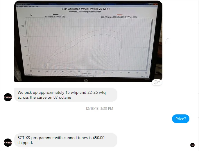

I believe a tune is the best and easiest mod. I have been playing around with mine and must say the difference in performance is obvious. Short of forced induction or internal mods, I believe a good tune is the most significant of mods. I am basing this on results others have seen on various bolt ons.
Here is my inquiry to Flyin Ryan's tune. It was a bit more expensive than I remebered. I bought the Syked software for $365.
Is this on a stock engine though or does it have stuff done to it? 15hp is pretty good if that is all stock. I've kept my Jeep engine stock on purpose as I hate dealing with CA smog and CARB approval stickers.
