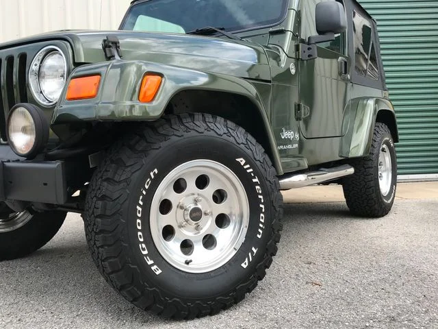

If you can find them, and it’s not easy, Jeep released a factory Alcoa 15” forged aluminum wheels for our TJ’s. They came factory on the Tomb Raider editions and the 65th Anniversary editions.
Likely the strongest and lightest factory wheel offered for the TJ/LJ. The draw is the backspace IIRC.
Look for a load range C tire regardless of A/T or M/T. Since you drive it daily, I would also recommend an all terrain tire.
Yes mate! Love those wheels. Been searching for them constantly but they are hard to find. I found these from Mammoth but I don't know how they compare in quality. Same thing with the Pro Comp version.
