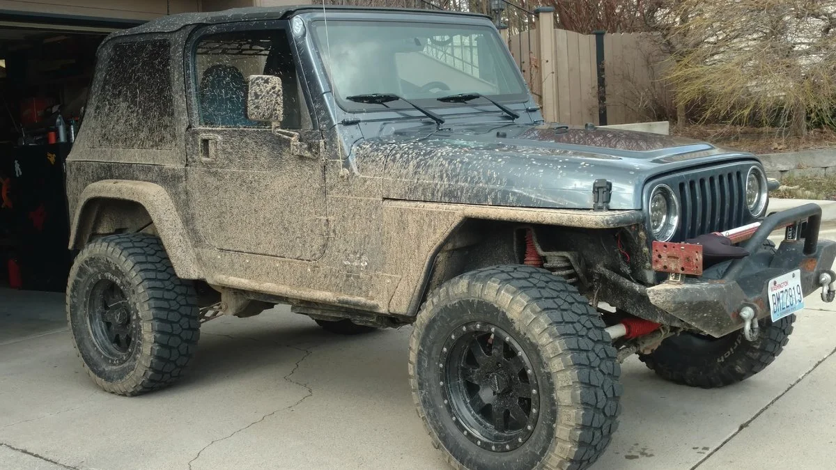

Nothing like that, but you may or may not need to drop the transfer case with some spacers if you get a shimmy on take off. I dropped mine anyway just to keep from putting anymore strain on my old u-joints. I had raised the jeep 2", so I figured I could stand to drop the t-case 3/4", but I'm not in rock country either.

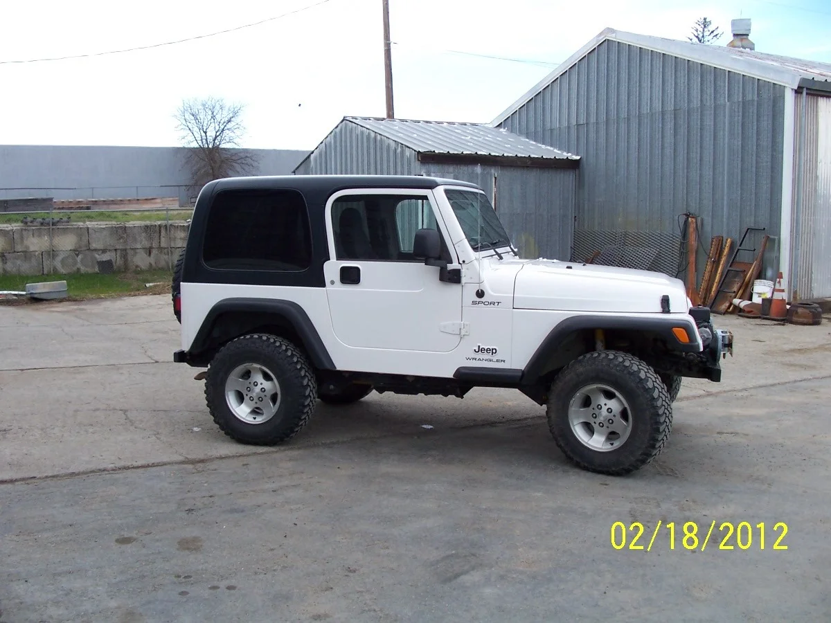

I went with the H&R 1" Springs and got 1.5" of lift out of them, and I'm running 31's. I extended my bumpstops a little bit, and adjusted my steering stops, but other than that it's stock and I have no issues.
