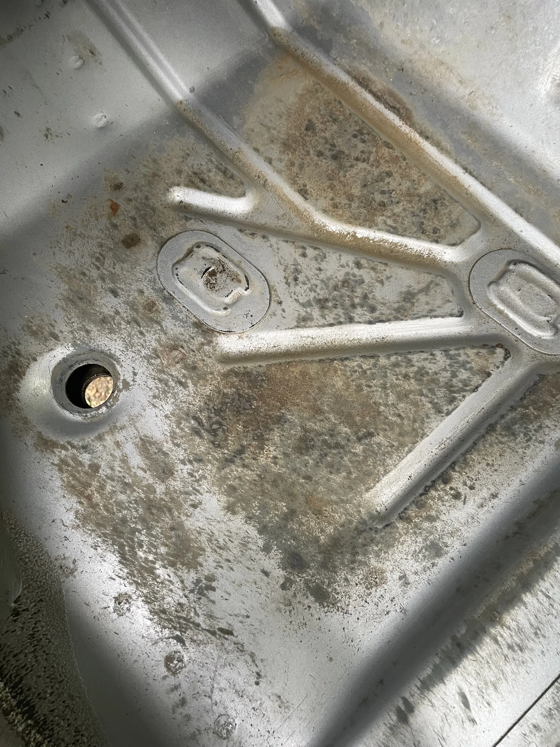

Have some light surface rust on my drivers floorboard that I need to take care of, got rid of a good bit just with a green scuff pad already, gonna finish up by hand with some sandpaper or a red scuff pad.
Would like to touch it up with body-matched/close-ish. Thinking just the Duplicolor Perfect Match but what kind of primer should I use? Self-etch?

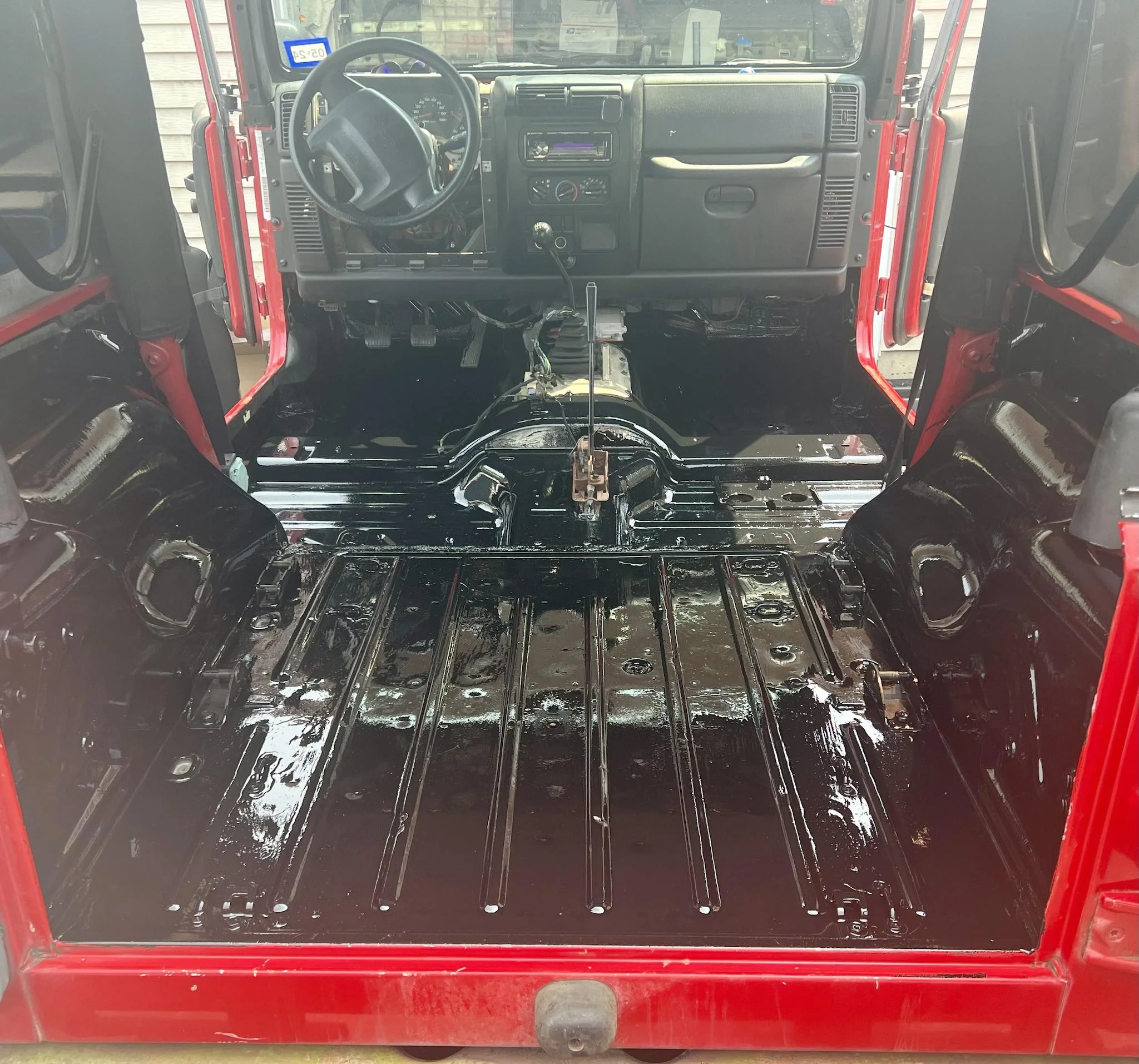

I sealcoated my floor with a high zinc oil based Rustoleum pro silver can. Its around $60 a gallon

Rust reformer, carpet, floor mat. I’m all for color matching, but that doesn’t look like a visible spot.

Knock it down to bare metal, use a GOOD primer, then you can color match and throw carpet back down.

No definitely not visible.
I was hoping to just get rid of the rust by hand as I’d almost need to take the seat out if I wire-wheeled it and didn’t really wanna have to do that.

Well you're wasting your time unless you get the whole thing down to bare steel. Rust reformer is great, but you can't just spray it over a floor pan with barely any prep and expect it to last. I learned that the hard way.
The rust being so little, you may be able to get away with it. But IMO I'd just do it the right way and use a self etcher after wire wheeling.

I wasn’t super explicit, but rust reformer after you’ve got it down to bare metal. I just don’t see the benefit of painting it with anything else in a spot which won’t be seen.

Rust reformer isn't really a "paint". So people rubbing their feet over the carpet will bring it to square one. I tried to get away with a little bit of reformer on the center of my floor pan. Buddy of mine moving his damn feet all the time it scuffed down to bare metal again.
@James9100 if you truly don't care, some reformer and truck bed liner will do just fine. Knock that down some more and get it smoother though.

I had mine cleaned showing no rust. Then, it was primed and bedlined. I ditched the carpet because it just creates areas of water pockets that lead to rust. Whenever I see water pockets now, after an intense rain, I just soak it up. The bedlining adds good noise reduction, and I fastened Jeep floor mats over the top for extra grip and noise reduction. Everyone says it looks nice too. I got the idea on this forum and it works. No floorpan rust at all. I have white bedliner, so any rust will permeate, and I see none, as long as I keep the floorpan dry.
