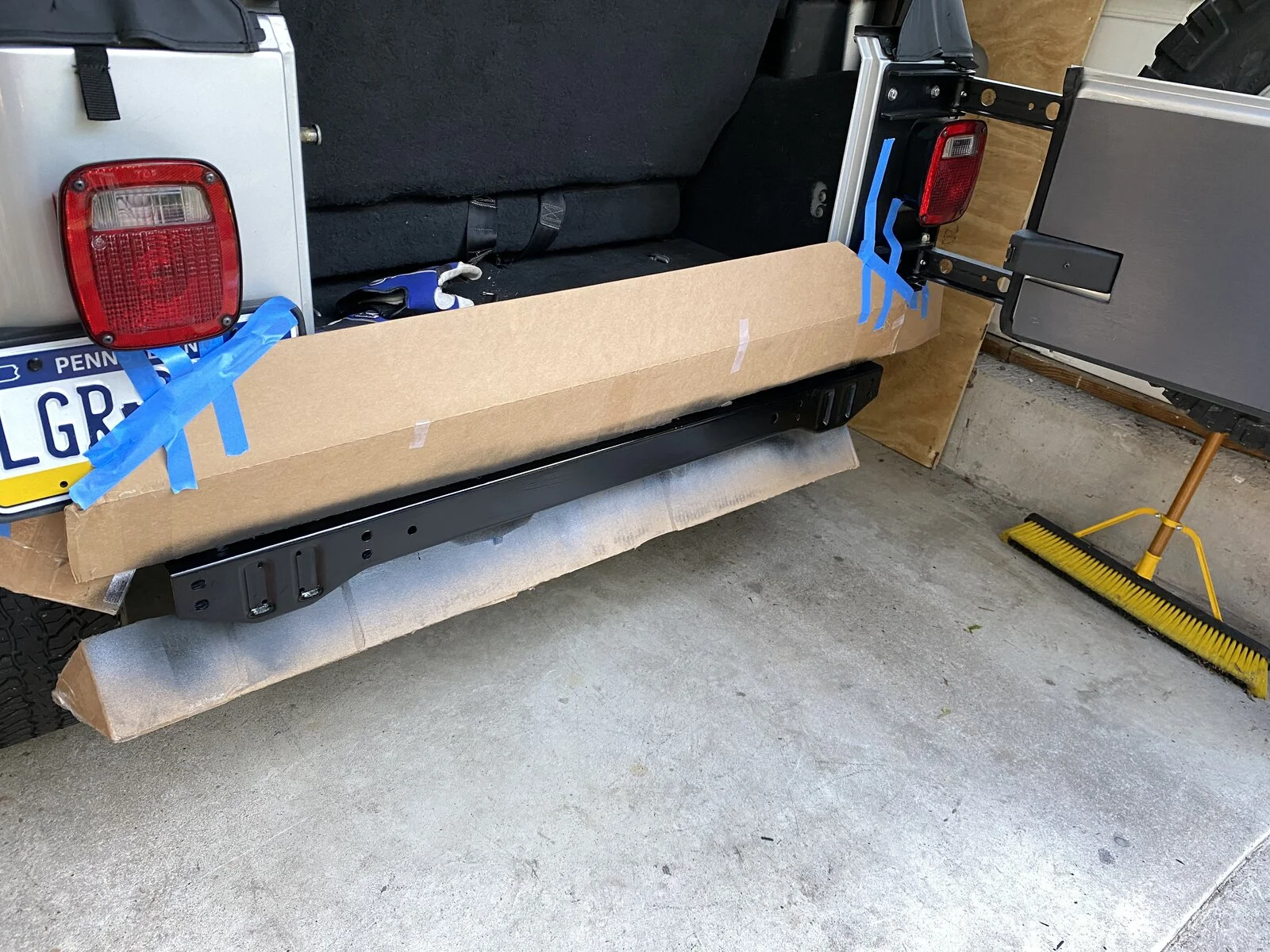

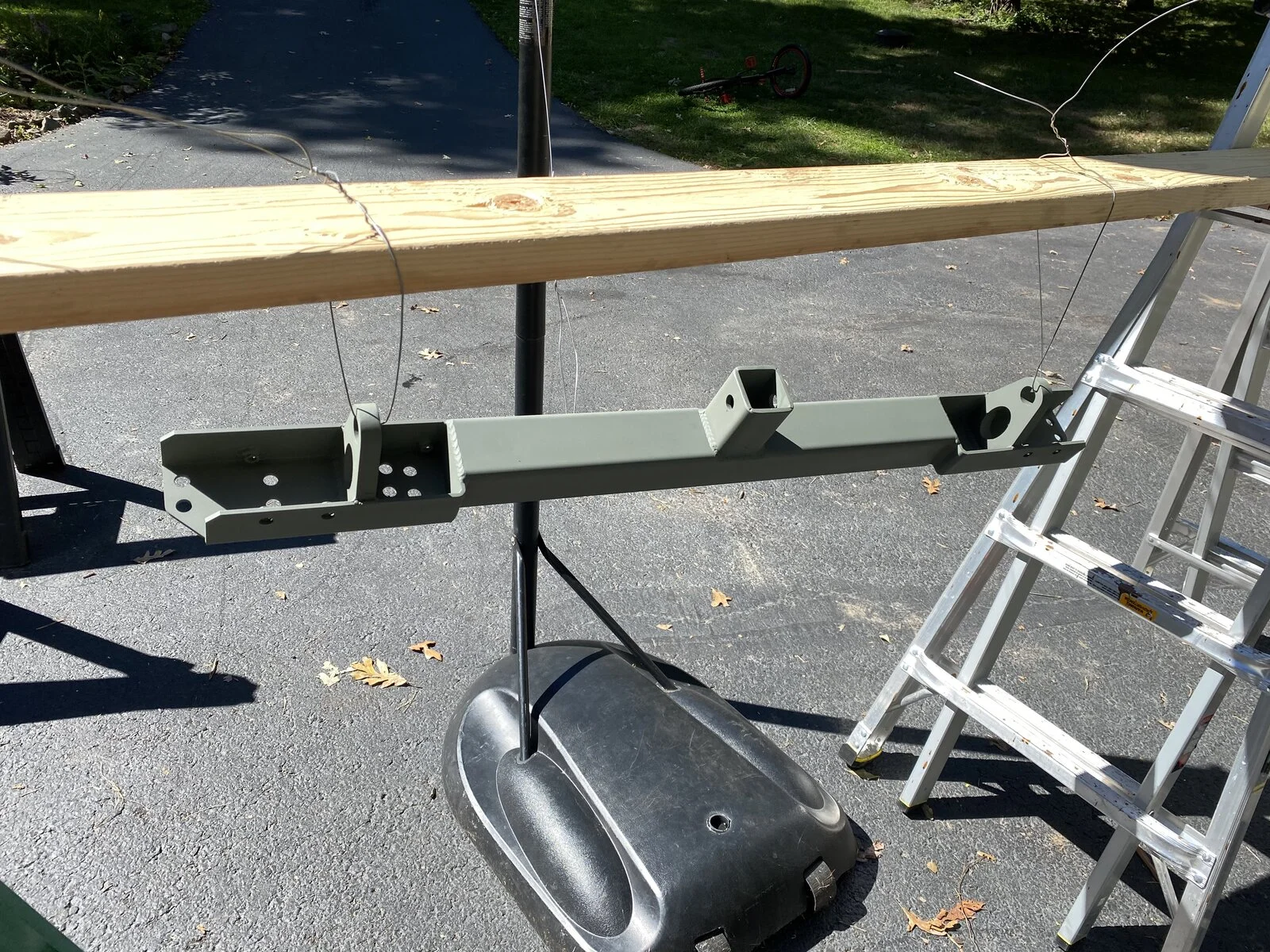

Mocked up the bumper just to check fit. Will drill out the holes and paint the cross member. Tomorrow I'll paint the steel part and see how that goes. If all is good I'll carefully paint the Aluminum shell.
