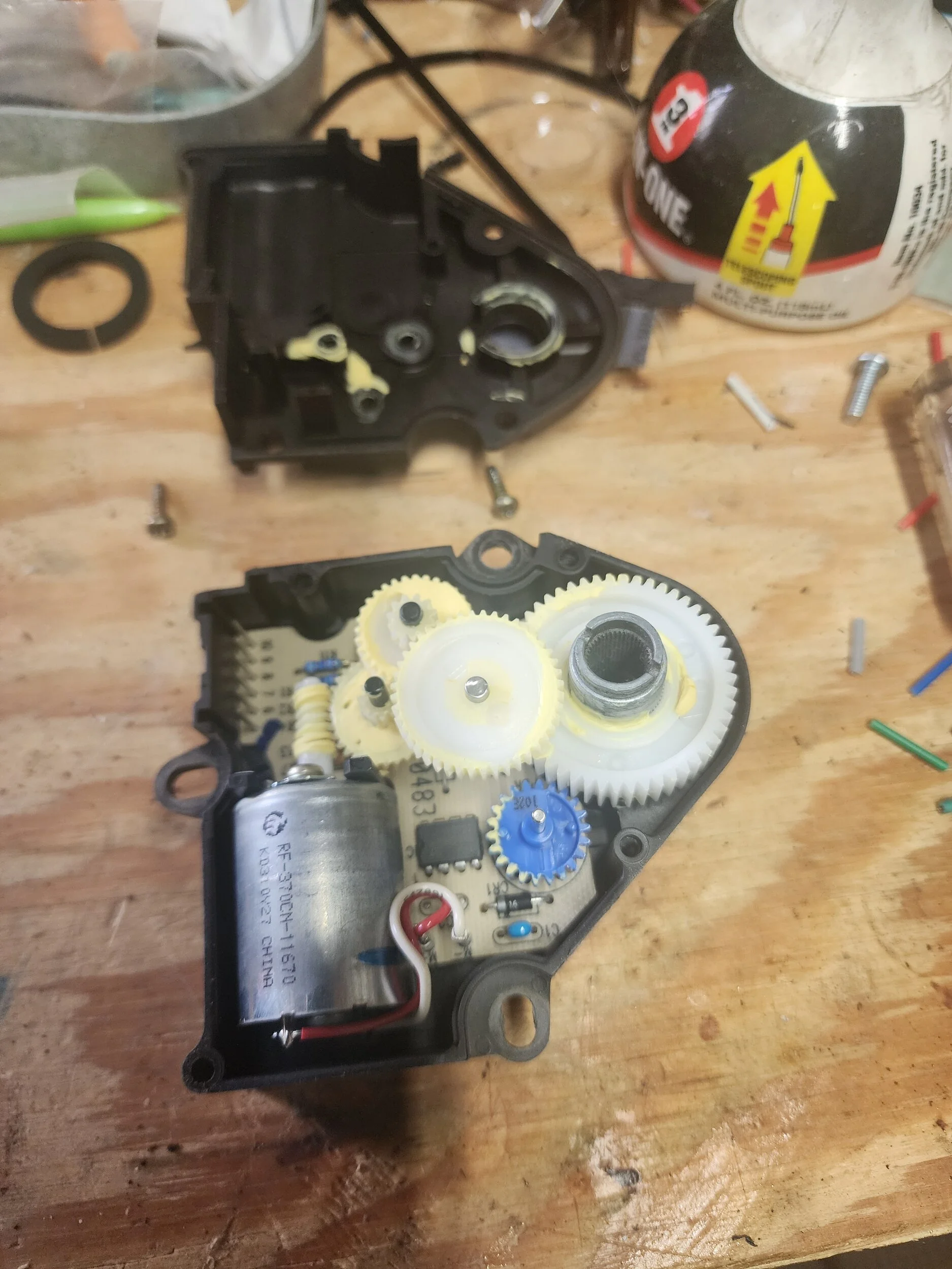

Warmer weather in the afternoons, so time to start using the AC again. On full AC with outside temp of 70, I'm getting 60+ degrees out if the center vents.
I'm was thinking low on freon. Today I hooked up the gauges and checked the high and low pressures. Pretty much dead center of where they should be at the 70 degree ambient temperature according to the FSM.
FSM says if pressures are good, but air isn't cold, blend air door is sealing improperly.
I take the electric actuator off the blend air door and open it fully by hand. Temperatures go to 45 degrees. The actuator is going fully from mark to mark when I adjust the temperature knob.
The blend door isn't fully sealing off the heat when the temperature is on full cold.
Has anyone else experienced this issue & more importantly does anyone have a solution?
