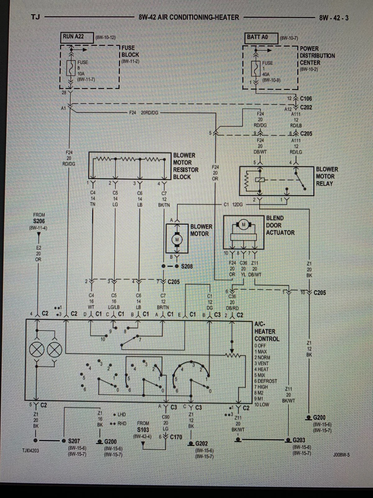

Does anyone know on the ac switch where there is a little green on top big green in middle and bottom is black. Should that little green wire on top have power. When I plug it up I lose all grounds to my speed selector. Plus I don’t have power going to my motor. 2000 TJ
Hope this A/C wiring schematic from the Factory Service Manual will assist you to find an answer to you question.
Trying to read those are Greek to me. There is just that one wire causing me problems.
IF you are referring to the green wire between Connector 1 terminals B and E (12 ga); that is the ground that goes thru the model selector switch C3 terminal C (12 ga black wire) which comes from the G202.
Disconnect the wiring harness and inspect the wiring for overheating; then test the mode selector switch terminals for continuity.
