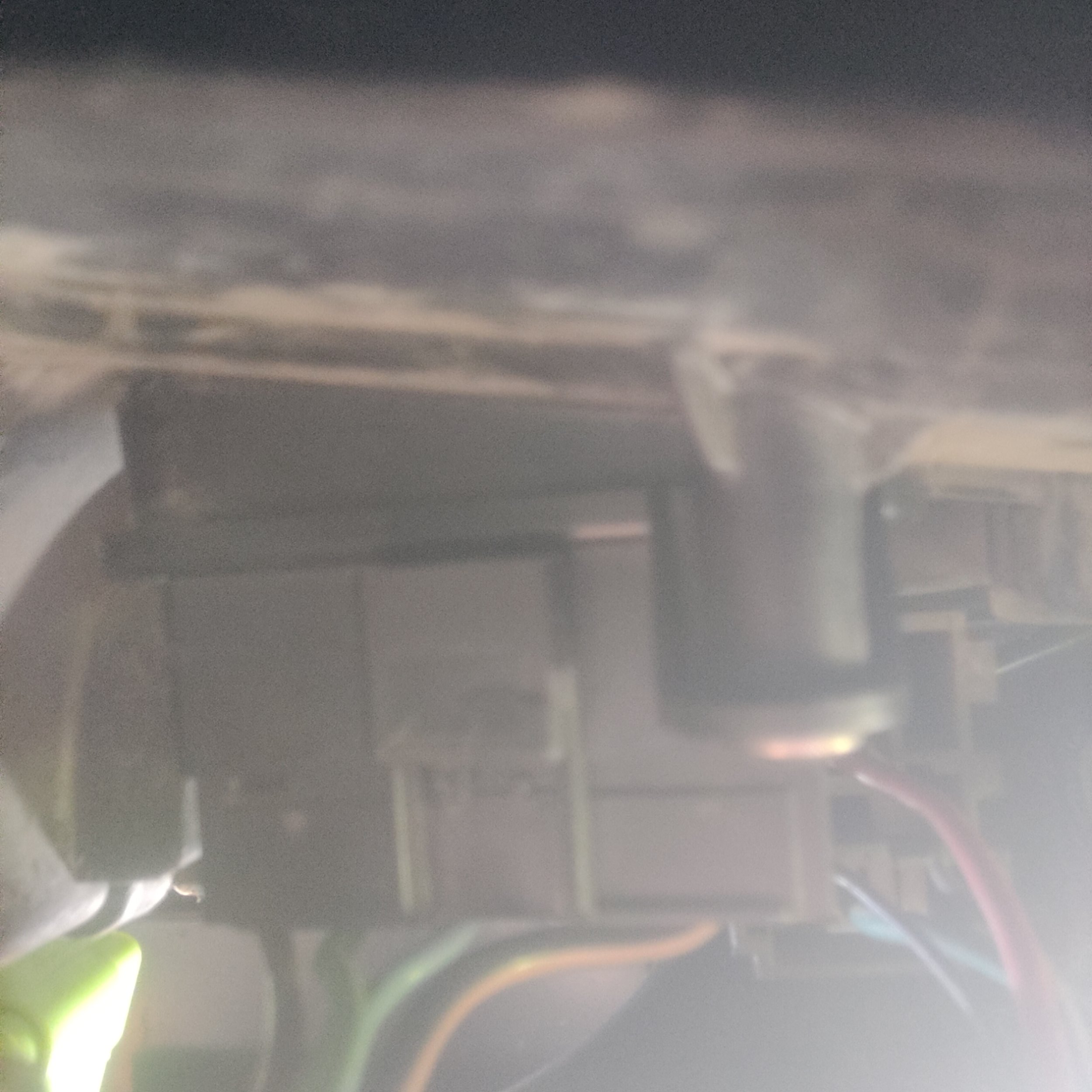

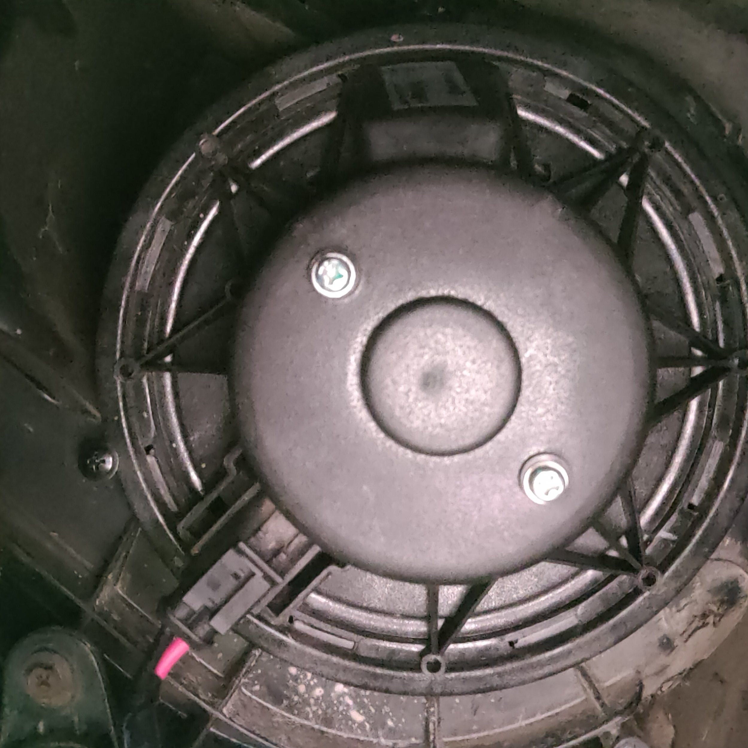

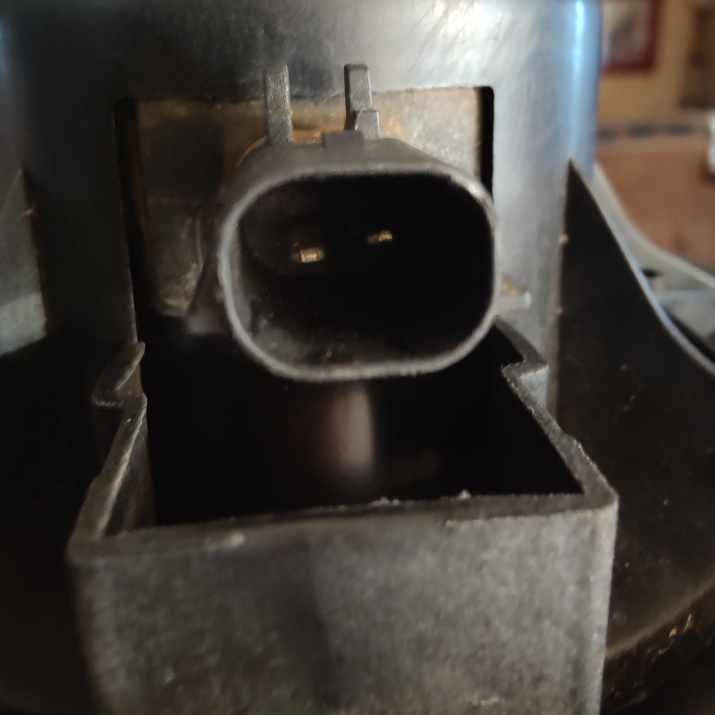

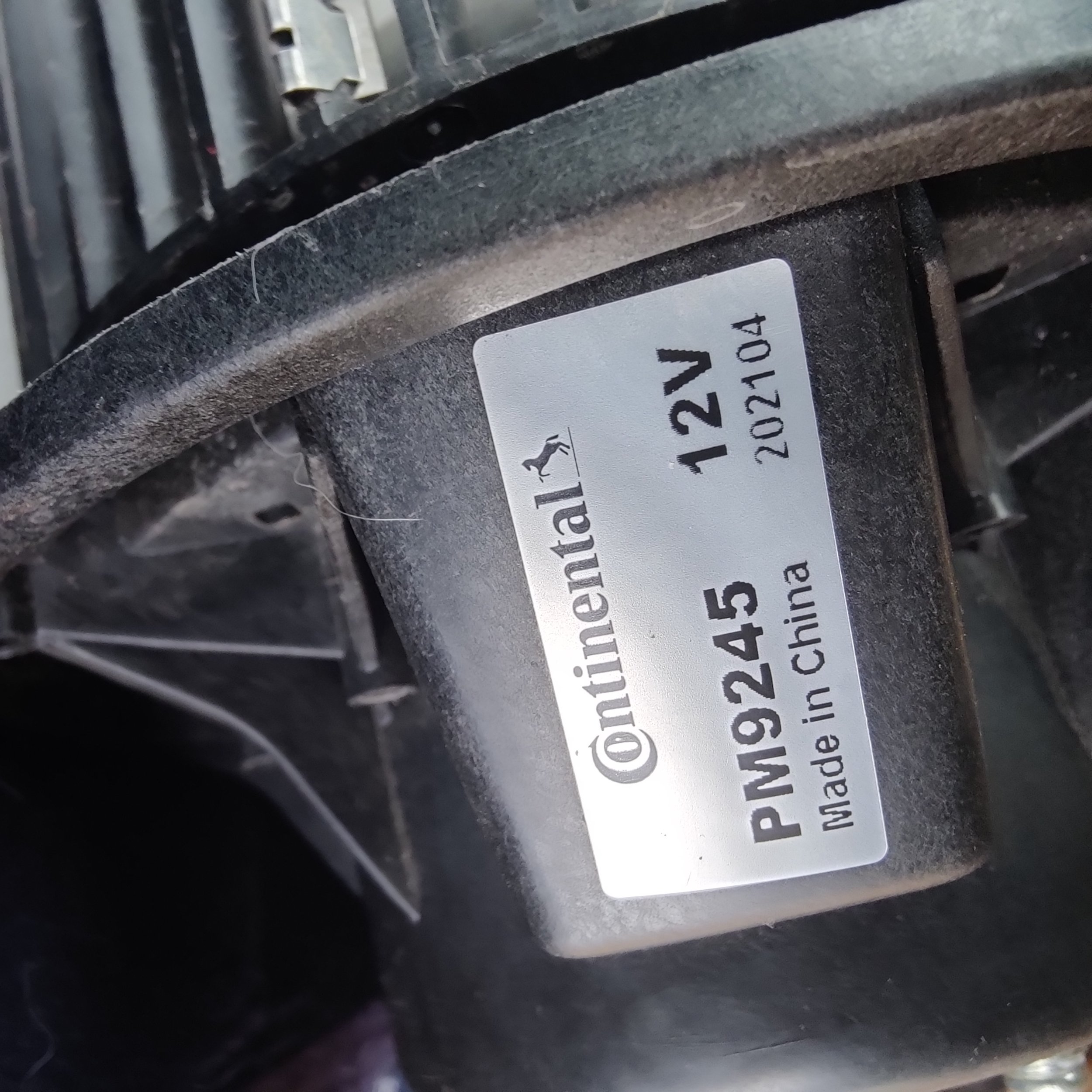

Started this thread back in January could not find the parts for a wiring harness and got a fan delivered that did not fit the original OEM if this is OEM. As long as the pictures the part Continental blower did not fit the harness correctly. Any help on this would be greatly appreciated
That appears to be the correct motor.
Your wiring harness doesn't look like the OEM connector.
My 97 had a pigtail that removed from fhe original motor... couple of spade connectors...was able to jam it on to the new motor's connectors. Still good three years later.
-Mac
Yes, that's the issue. Somewhere in time a round peg to square hole mechanic got his hands on the wiring harness/connector. Connector or harness discontinued in 2018 but China, Mexico & Canada still make the blower
