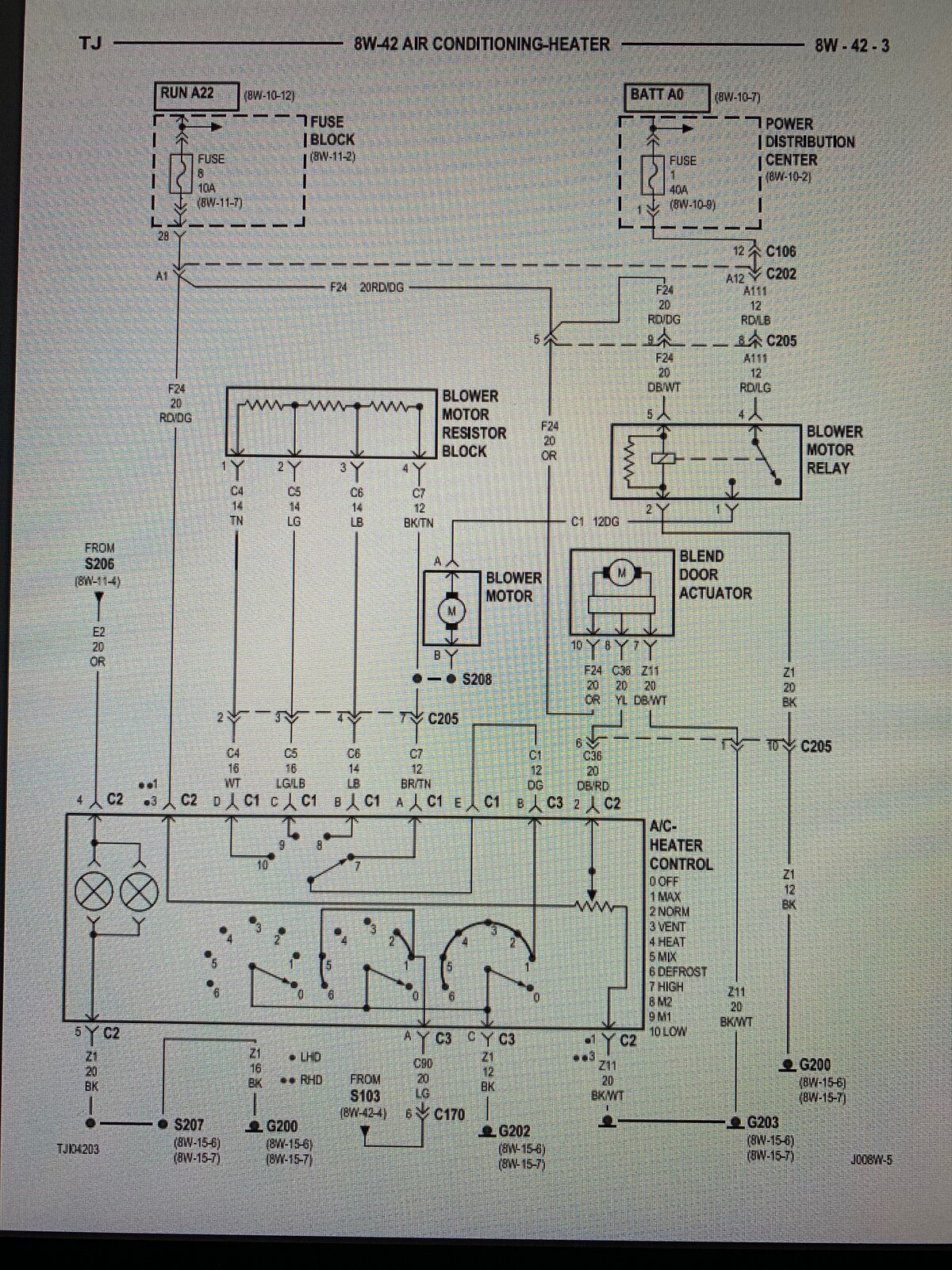

To get it out of the way this is what I know and have done.
- Switch panel has been replaced
- Melted wires are replaced with heat shrink female blade connectors
- Relay has been replaced
- Resistor has been replaced
- Blower motor works (12v wired to motor or using harness)
- Fuse 8 and 1 both are 12v and working
- Bench tested relay, 12v I hear click and circuit closes
- Jumper the power bypassing the switch, blower works, speed selector works
- Jump the 12v to the blue/white on the relay plug , blower works, speed selector works

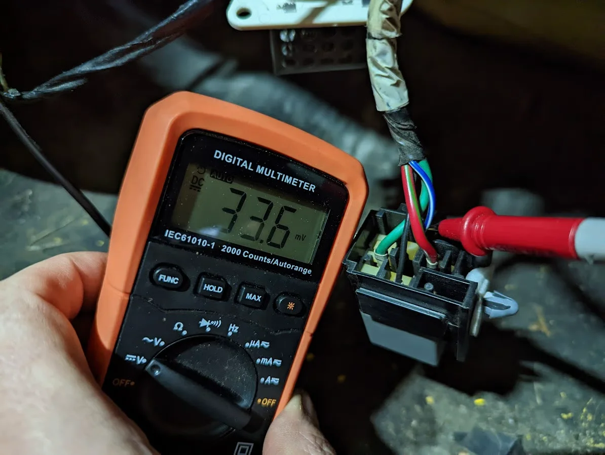

- Blue/white wire to the red/green on the relay plug to temp on panel is 35mv
