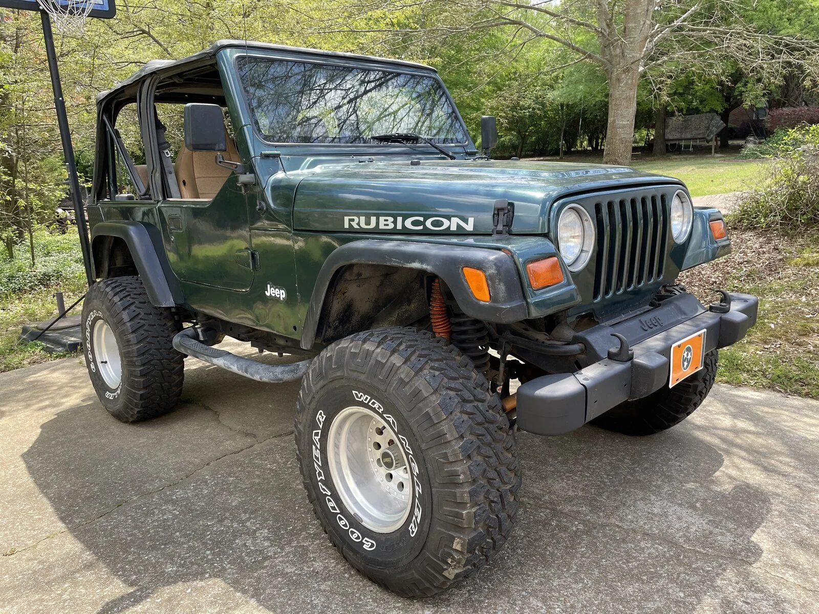

I need some help from anyone who would be willing to give it in the West TN/KY/North MS/East AR (Memphis Mississippi Delta) region. I have a 3” body lift on my 1998 SE. This Jeep has never been outside of TN and north MS according to the CARFAX. The only shop I can find in Jackson, TN who will help me wants to charge $900 and they’re saying I also need a $400 OEM bushing kit from the dealer.

@jrmcafee could you take a close up photo of the pucks? From the photo it looks like the oem rubber is still in place and you'd simply need shorter bolts.
So that’s what I thought as well. Yes, the original rubber is still there and I already have the bolts. I’m simply a little gunshy of taking it on with all the horror stories I’ve heard of the tub either getting off-line from the frame or bolts not lining up properly if the job is done in steps.
