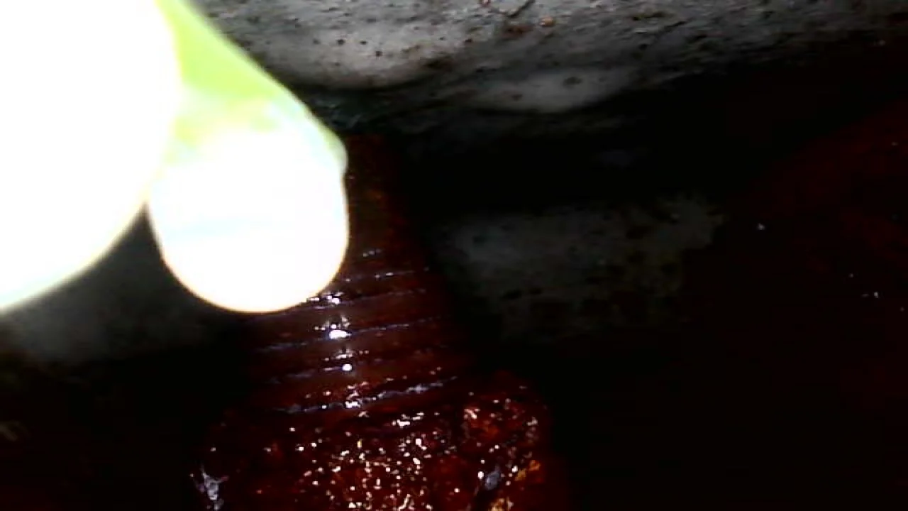

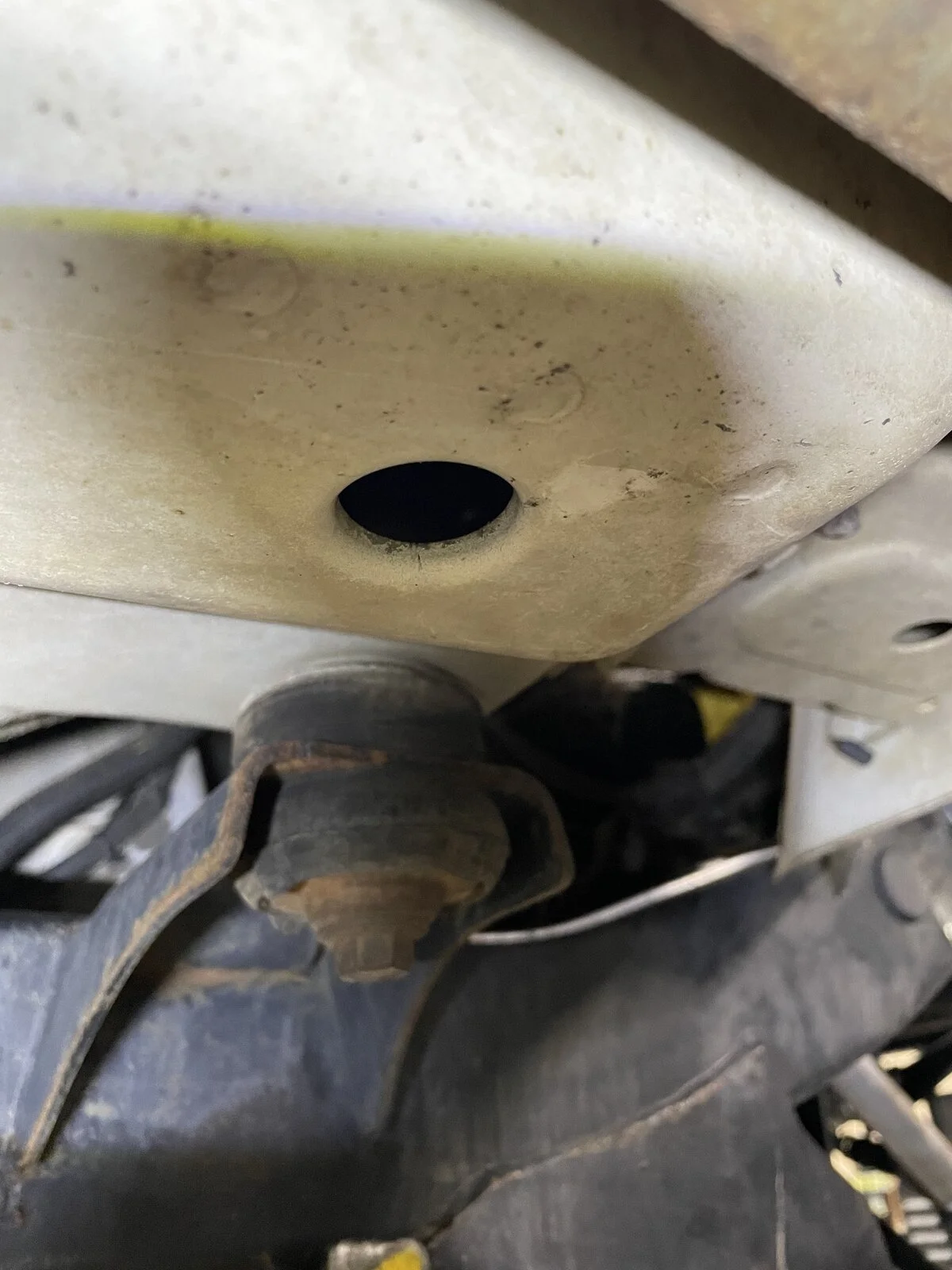

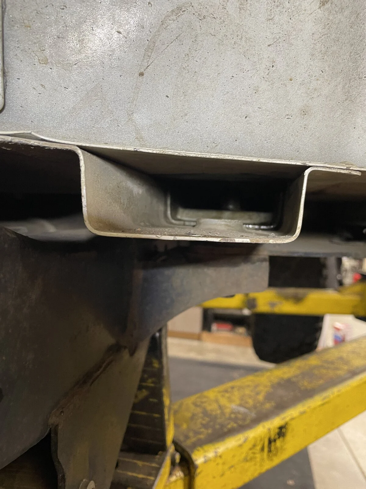

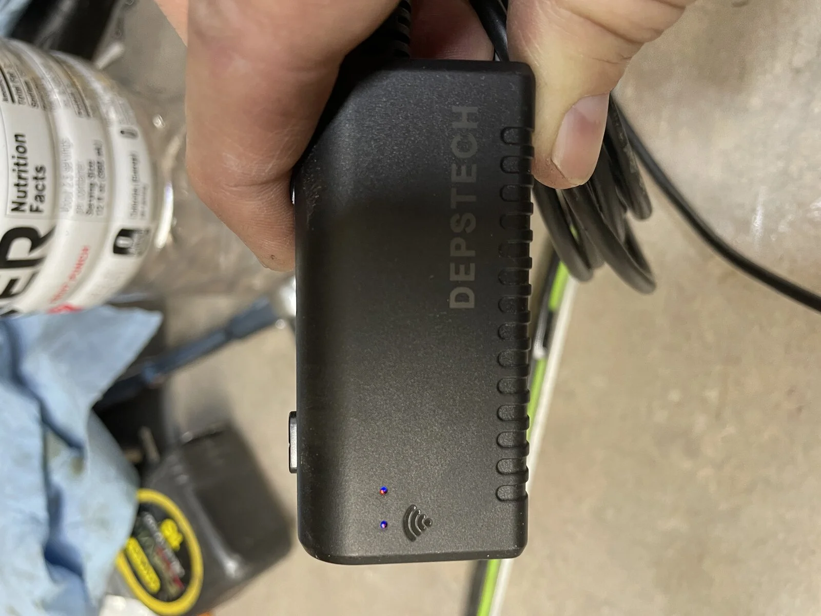

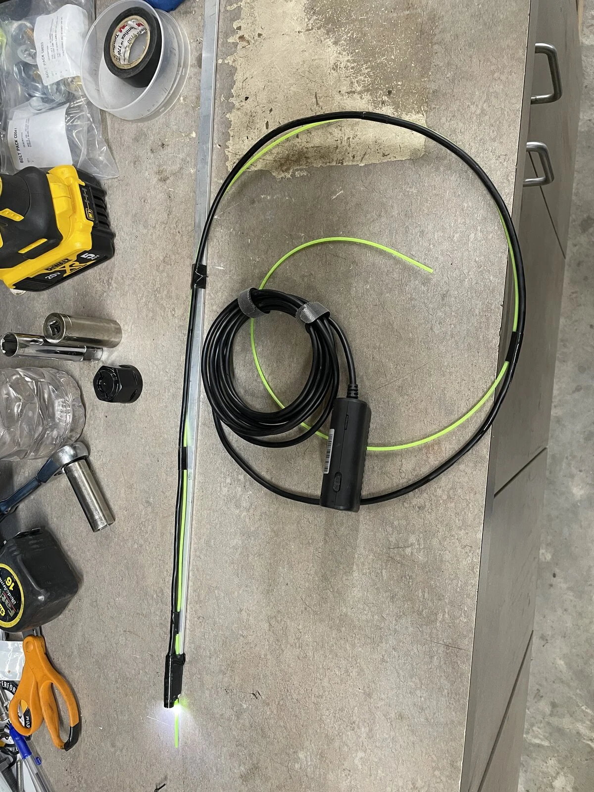

I apologize if this has been discussed already, but I did a search and couldn’t find what I was really looking for. I’ve seen many people cutting apart their floorboards and doing all kinds of weird stuff to try and lubricate the body bolts before they put on a body lift or change out a body mount. This is my solution! I purchased an endoscope off of Amazon and tied it to a long lubricating tube that fit on the end of my liquid wrench can. I then tie that to 1/2“ x 1/16“ aluminum flat bar. I removed the rear inner fender well covers to get access to the body mount bolts. The endoscope really helped a lot locating the top of the rusted bolts. For the two front side mounting bolts I removed the endoscope off of the aluminum bar and fished it up through a body hole next to the body mount. All you have to do is spray away at that point! Hopefully this helps somebody in the future.
