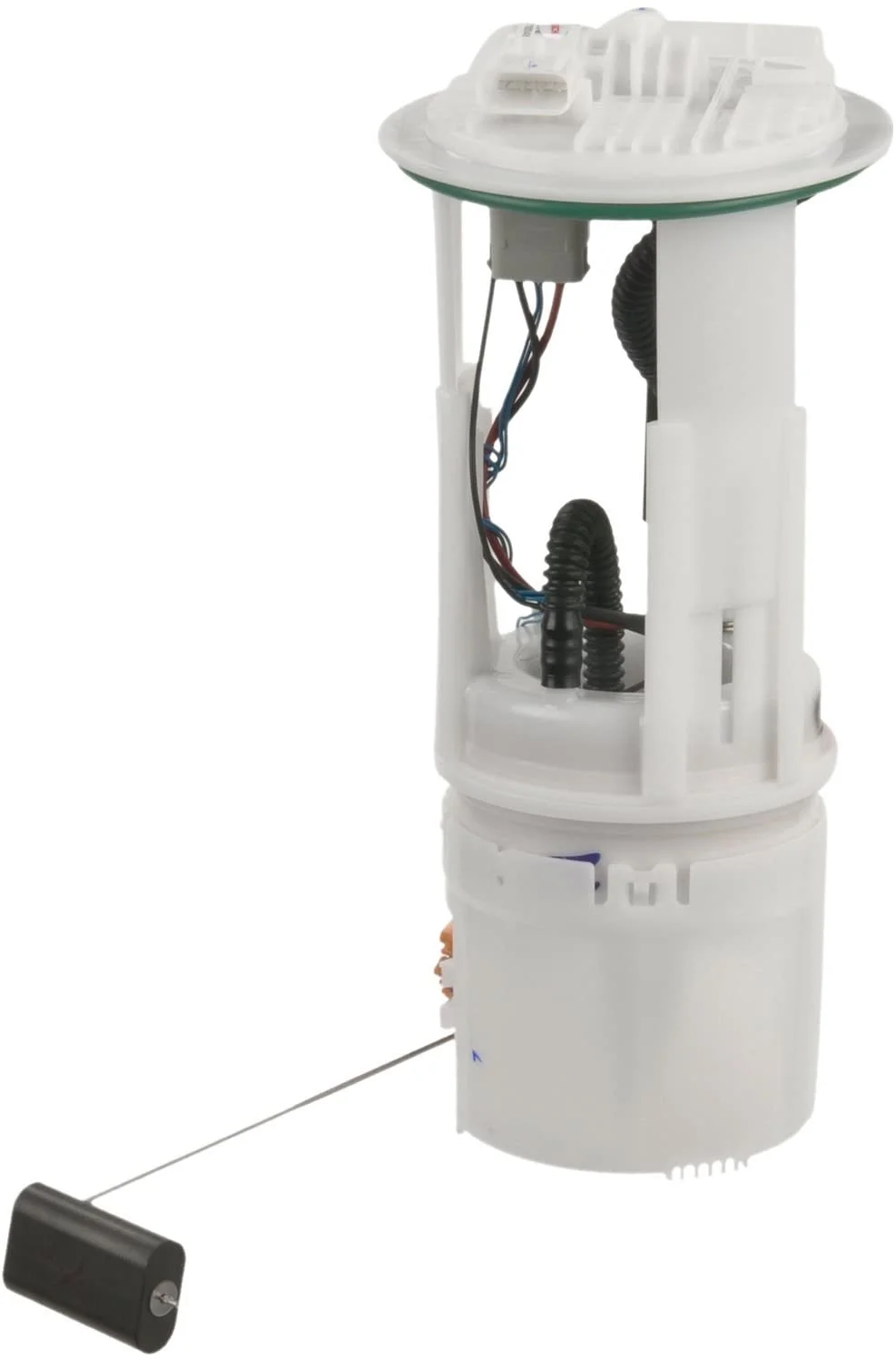

sorry about the giant picture.. this is the Bosch unit I'm looking at... complete as far as my limited knowledge. If not, please let me know. thanks
Definitely get the Bosch unit. Also, it doesn't look like the Bosch 67756 comes with the strainer/filter. Don't forget that!
I think the filter is internal, or part of the assembly on the ‘05-‘06 pumps. I ordered one some months back for my spare parts pile and it didn‘t have one on the bottom. I think I read that somewhere after getting it and seeing it didn’t have one. It may have been in the literature or on the box itself. I’ll try to remember to look at them when I get home from work tonight and see if it says that.
The fuel filter is inside the fuel pressure regulator that is part of the assembly.
