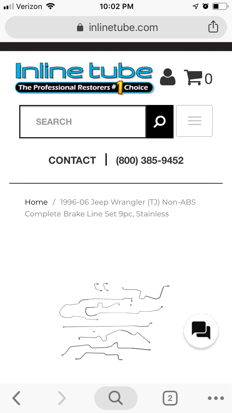

It appears that a repair of that line has been done in the past. I don’t think there should be a joint there. Where I live we get brake lines from InLine Tube (see image). You’d have to call them to tell them exactly what you need. You might be best off by replacing that entire line from the master cylinder.

I didn’t have luck finding one hard line that was pre-bent. I ended up buying a whole set from Extreme Terrain for under $100. It all started with a simple front hose replacement, then ended up being all new hard lines, hoses, rear wheel cylinders and one new front caliper.
