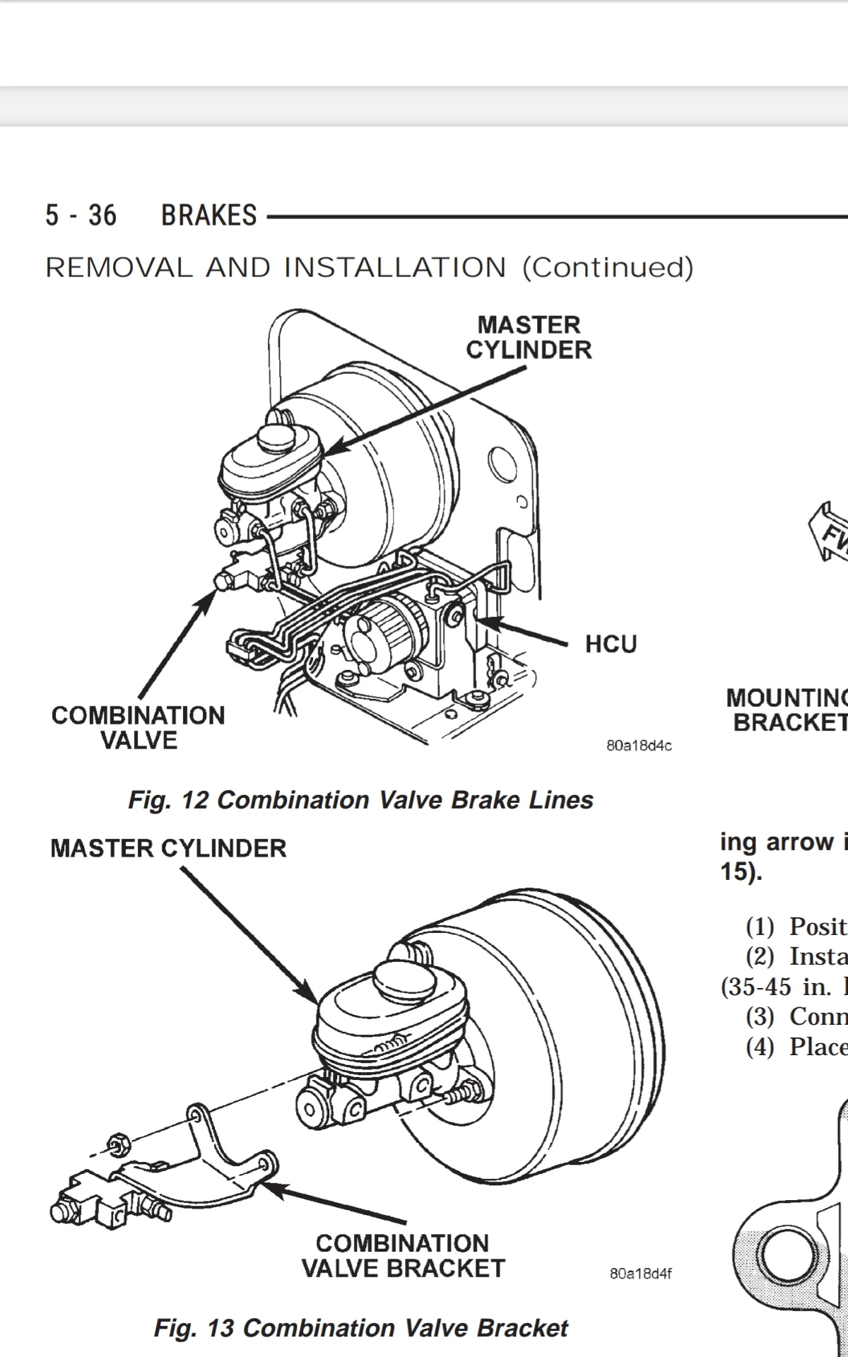

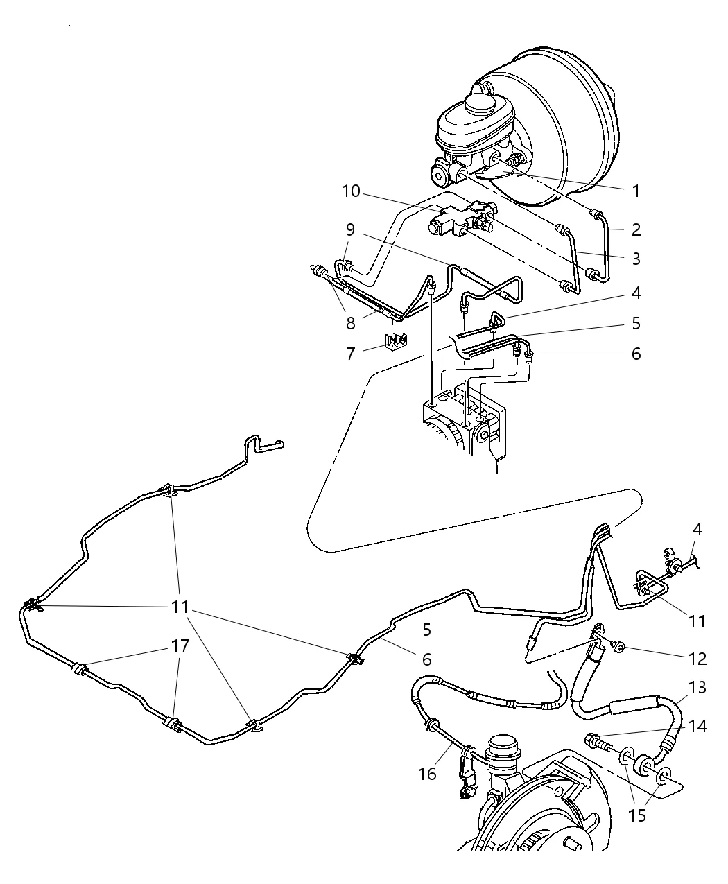

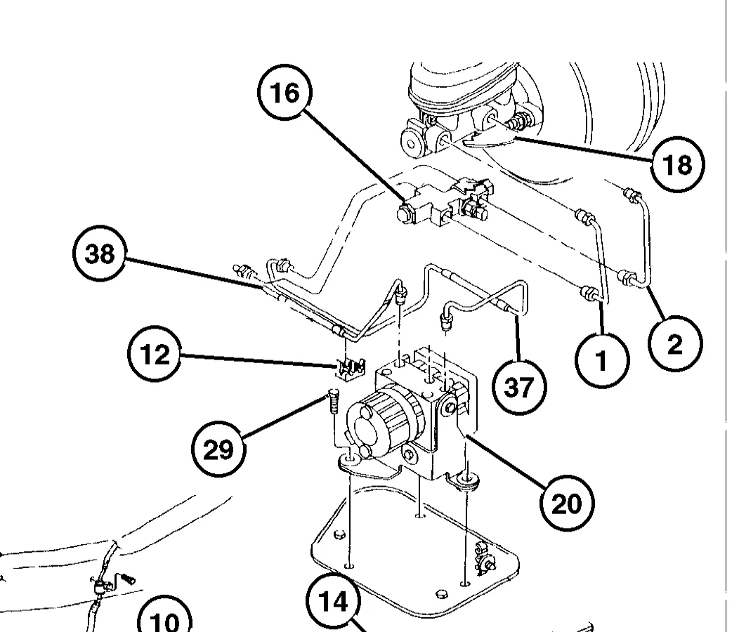

Good evening, does anyone have a early TJ with ABS? I am replacing the brake lines and the PO cut some of the lines and I thought I knew where they went but after trying to install a pre bent kit (I did in fact buy one for an ABS equipped TJ) the fittings seem to be the wrong size that go into the HCU/EBCM. Block front and rear I have figured out as they were pretty self explanatory.
I have looked through the factory service manual and I have done extensive google searching as well as reached out on FB and a local forum (greatlakes4x4.com) but no one seems to have an answer/ hasn't answered.

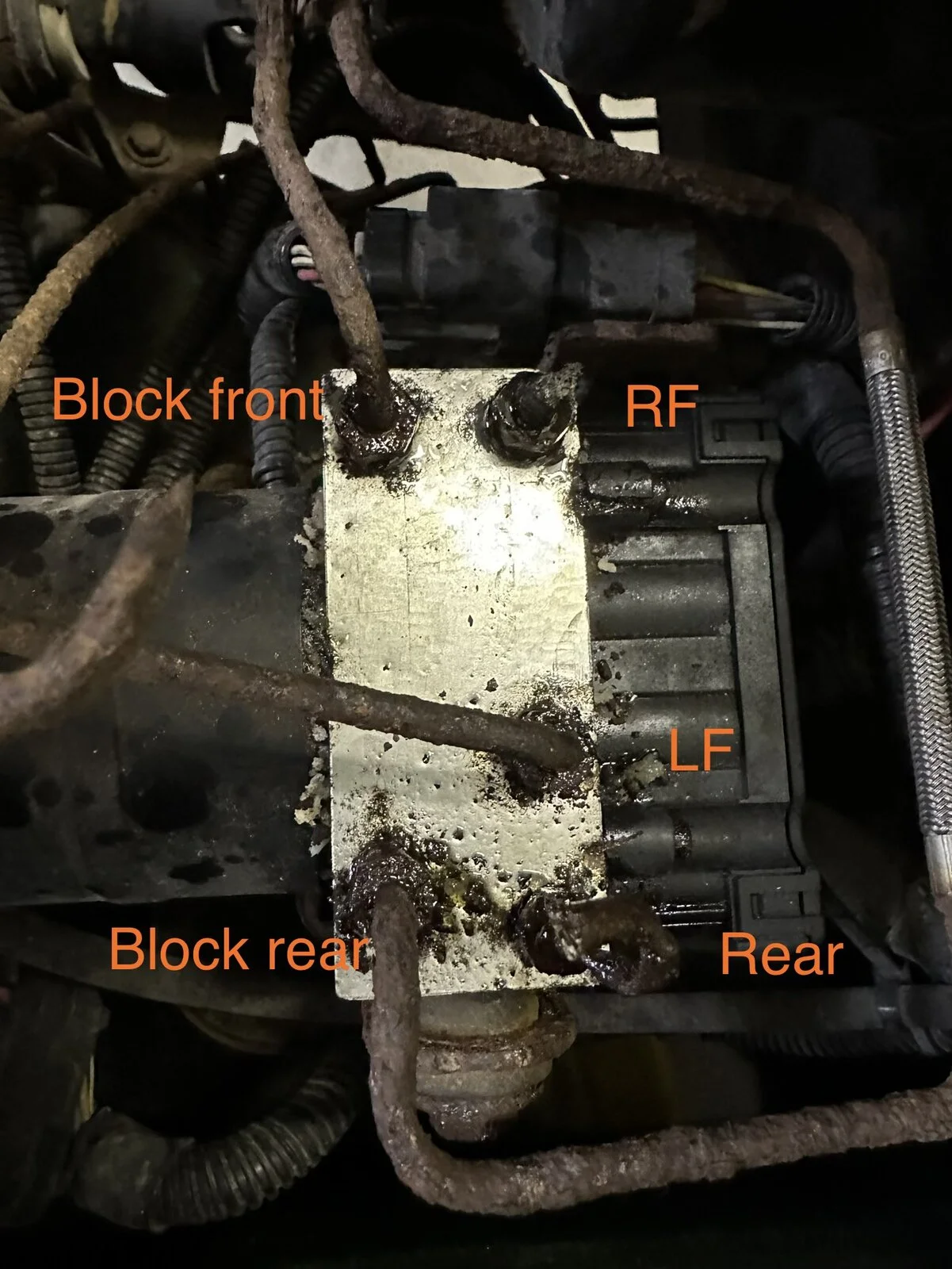

I have attached a picture of what I think each circuit is for.
Basically I want to know if the kit I received was miss built or I have the diagram wrong. Any help is appreciated!
