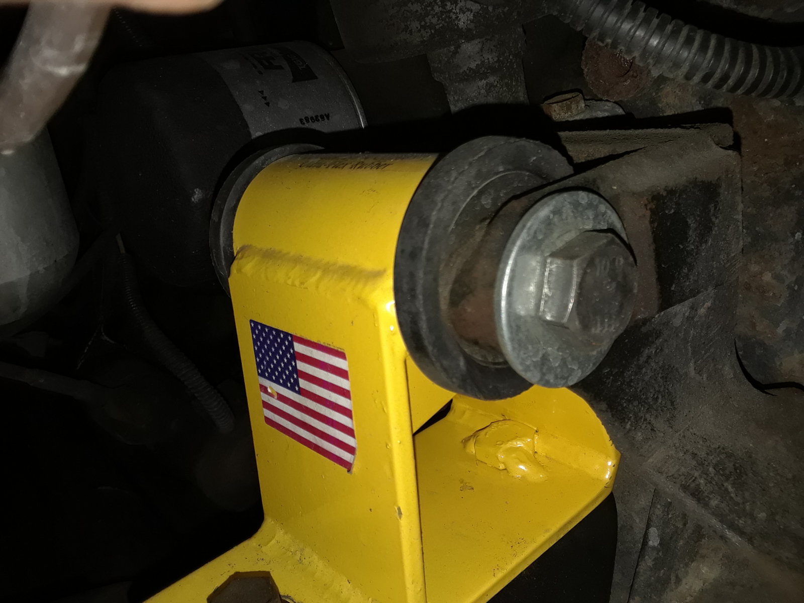

Installed my brown dog 1"mml, ultra flex rubber, and get a lot of vibration at idle. I loosened the through bolts so there is a gap, can turn bolts by hqnd (mine didn't have washers) and still shaky mirrors. Drivers side dropped in no problem at all. Passenger side took lots of prying and pulling. Used a rachet strap from the a/c spot to my front bumper d ring to get the holes to line up. Looks like I'm off centered judging by the bushings. Any help would be great.
Your passenger side bracket from the mount to the engine looks bent, the ear toward the filter side maybe? If it is and is putting the Browndog mount in a bind, that seems it would transmit extra vibrations on top of what those mounts already transmit.

What would cause that to bend? Not saying it couldn't happen but seems extreme.
The mount looks like it's in a bind by how the bushing get pulled.
Has the Jeep ever been in a wreck? That could cause it but other than that I don't know what could either, the bracket is a pretty stout pieced of cast metal.

Your pic of the mount looks normal My passenger one isn't sitting right for some odd reason, and is a huge pain to install.
Well, don't think the shrubs would bend a mount bracket on the engine for sure, it could have been that way from the factory and the big squishy rubber on the factory mount covered it up. In the pictures, one of the factory mounts has cracked rubber, did that one come off the passenger side by chance?
The driver side gave me trouble. Here is my passenger side,
if yours isn't sitting right it shouldn't be hard to spot. There's lots of clearance around the pass mount.

From the top down of my passenger mount it looks "tweaked"
