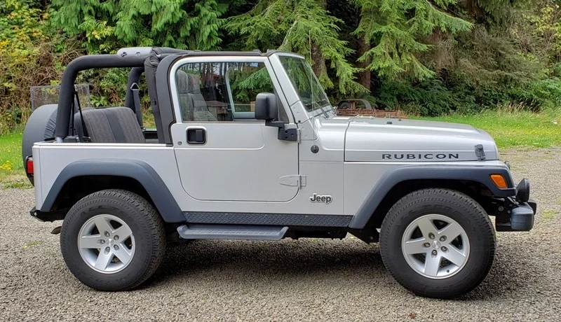

Build Advice Please
flyinfish
Aug 31, 2019
13
Oregon
2004 Rubicon 25k miles and is stock except a Warn Rock Crawler rear bumper. Moab 16x8 Wheels
I'm looking to put 35x12.5 Tires on it and after a ton of reading on this forum(thanks to everyone), I started purchasing the items I know I need.
The main issue I'd like to get figured out, can I or is it not advisable to run 315/75/R16 KM2 BFG Tires on the 16x8 Moab rims. The tire spec is Dia 34.8, Width 12.3, Rim Range 8-10, Measured Rim 8.5, Load D
If I have to purchase wheels I can do that but I like the Moab wheels. I know I should probably be running beadlocks. If I do purchase wheels should I buy 17" or 15" dia. for good air down.
My other area of concern is regearing. The front and rear are both Dana 44's running 4.10 gears and a 241 transfer case. I have a 42RLE Automatic. Do I need to regear both front and rear and are 4.88 gears the best or should I go lower. I don't want to have to run the hell out of it to do highway speeds.
If anyone has an opinion, I'm all ears and would appreciate it. Below is my build list and will start Installing the lift Monday.

I see no issues running those rims.👍 Other than the 5" offset that most likely will not be in any aftermarket rims you buy. So a bit of rubbing near full lock.🧐 Easy enough to deal with. If you like those rims then why pay money to get something you don't like as much?
Re-gearing...get the 35's put on and see what you think. There are guys that have 3.07's and 35's and say they are happy.🤯 So everyone is different. I've got 4.10's and 32's on a 6 speed and am happy. Don't think I would be happy on 35's though.

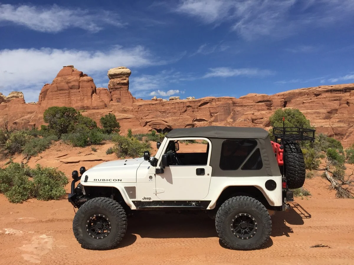

Your build is very close to mine, and you have picked all very good quality products. I think you will be very happy, mine drives, handles, and off road's great.
I am also running
Currie CE-9801HS 4" complete lift kit with Currie front Anti-Rock Sway Bar. SAME
Extended Brake Lines SAME
Currie Currectlync (Tie Rod/Drag Link System) SAME
Body Lift - Savvy Aluminum Body Lift 1.25″ 1" BL
Double Cardan Driveshaft (Tom Woods) STOCK
RS5000X or RS9000XL Shocks RS9000XL
Wheels? 15 x 8 WHEELS w/ 35's
Front Bumper BESTOP HIGHROCK
Winch-Warn Zeon 10-S Platinum WARN ZEON 8S
I switched to 15" wheels more tire choices and a lot less money for the same 35" tires. And yes I would recommend a re-gear, I am not sure what gears you need as mine is a 6 speed manual but I switched to 4:88's and yes you have to re-gear both front and rear. I would also recommend removing the steps and the factory steel plates and add a nice pair of rock sliders
I am also running

Have you wheeled it stock yet? Do you know what type of terrain you are building for? Your list may be overkill for what you actually end up using it for. Just trying to save you some money, if it matters.
I haven't four wheeled this TJ stock yet. I just bought it three weeks ago.
My four wheeling will be in the Pacific Northwest. Oregon Coast Range, Cascade Range and Eastern Oregon. I shouldn't have the large boulders and rocks like other places like Utah.
Ground clearance is important and is why I was thinking 35's otherwise 33's might be the way to go. I do want the jeep to still drive good on the road as I'd be driving on highways to get to wherever I go four wheeling.
I have a 1973 CJ-5 with a 304 in it and used it for hunting and four wheeling. The TJ should be a big improvement with coil springs, fuel injection and all the Rubicon extras that the CJ-5 doesn't have.
