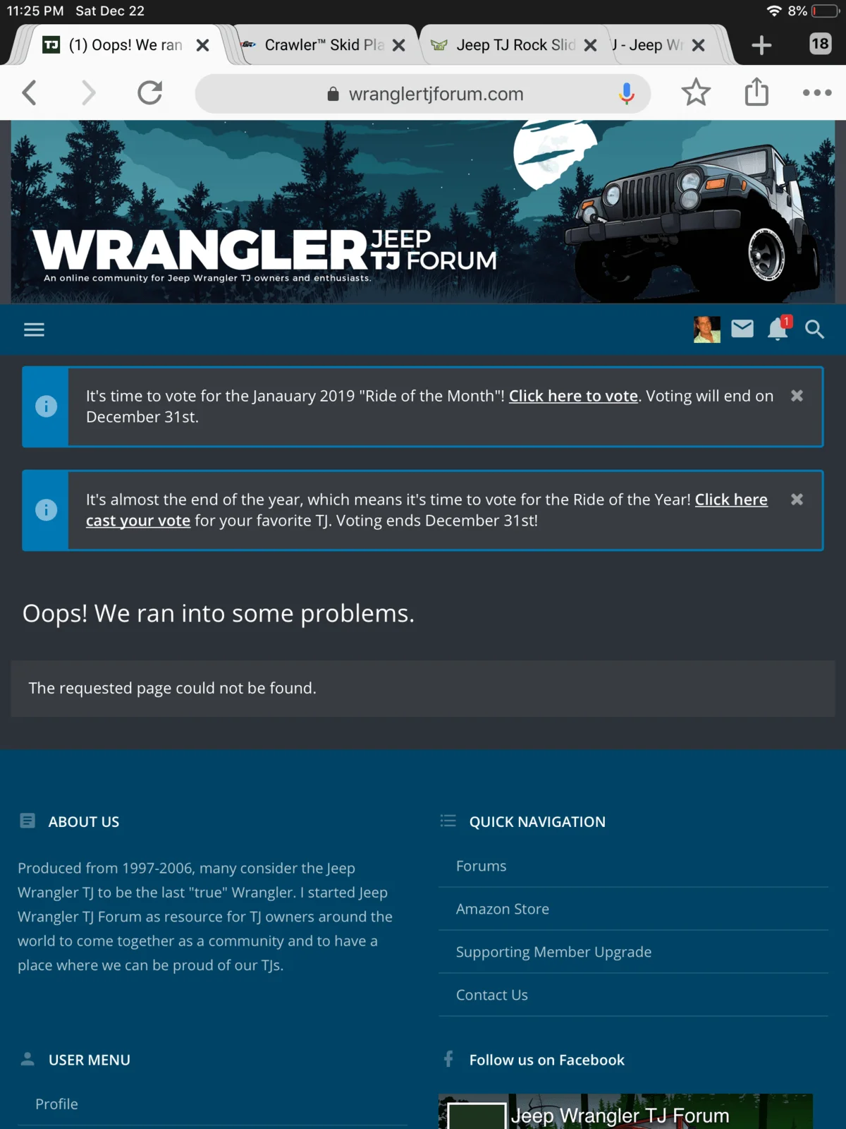

1. Editing my profile, when I click on the link Chris sent I get a “oops, we’ve encountered a problem” page and can’t seem to get into that area any other way.
Is this the link you're using?
https://wranglertjforum.com/account/account-details

Yep, that’s the link but it worked this time. I tried the one from your intro message again 10 min ago and it didn’t, odd

Here’s the error, just tried it again from your intro. There might be something going on there.
Figured as much OM the stabilizer, I have a new Monroe magnum waiting to go on. In my head it helps with the heavier tires on crappy sections of road, but I could be wrong. It’s a $30 part so no big deal.
Is there any reasoning behind sticking with the spicer joints ? I’ve noticed a few entries to the market since I went down this path last time and didn’t know if they were being used. Seems likes it would just cause damage in the diff rather than at the joint if something was going to give.
Yeah, I've since updated the link in that intro email as it wasn't working, use the one I gave you for now.
