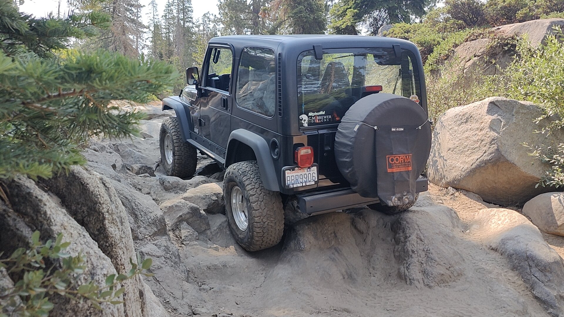

"Im not Rubicon noob. And I have to say running the Rubicon from Loon to Tahoe in something you don't want to ruin on 33s and a 3" lift is no joke.
My advise for anyone with small tires and lift wanting to run the Rubicon is, be patient, be smooth, and choose wisely. Bring your "A" rock game, or your gonna have a bad time."
"Bare minimum" is sort of a realative term. Post #1- 79 in my build thread is what I had when we went, and I would not have wanted to do it with anything less. I didnt get hung up anywhere, didnt have to winch, and only got one dent (in the body 😁).

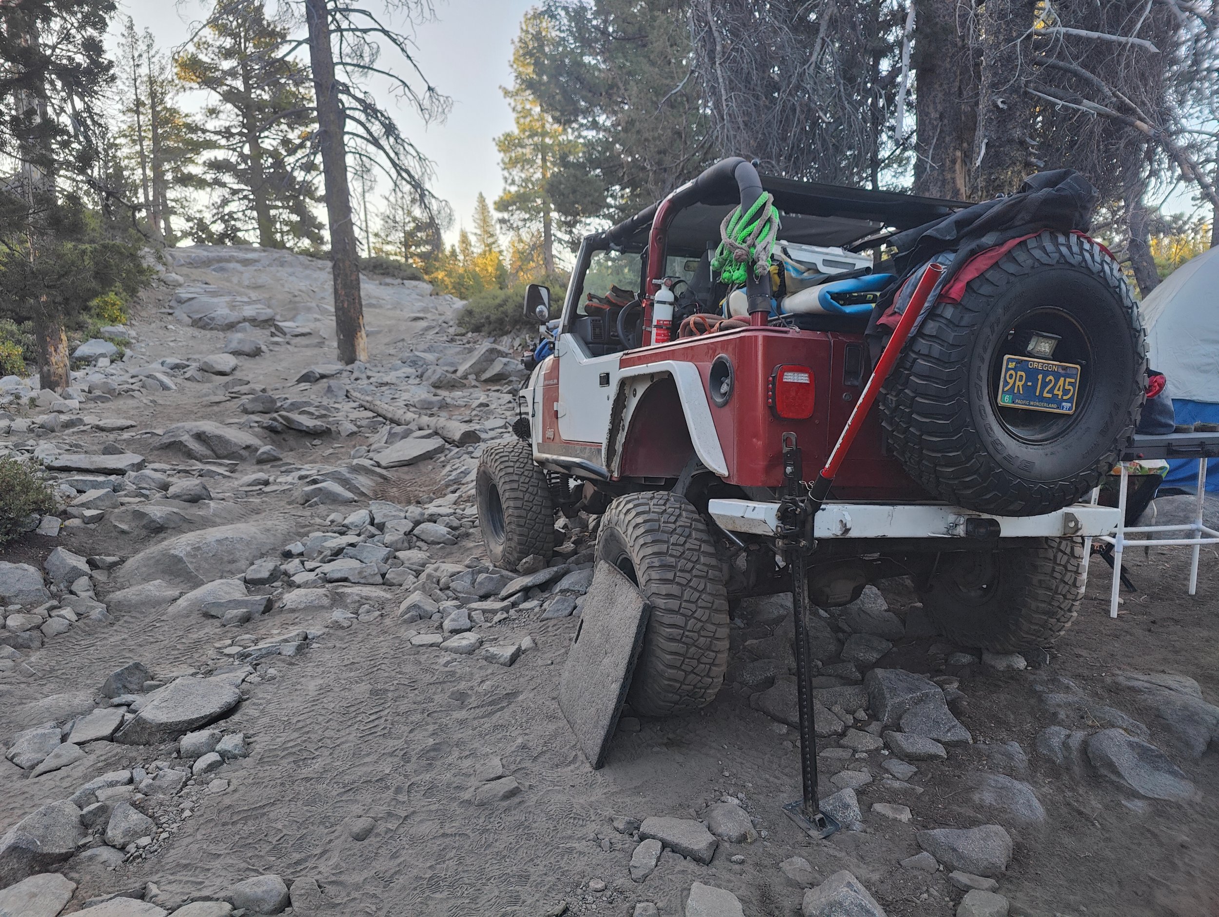

TJ's are especially suited for the trail. Short, narrow, light, and the coil springs provide supreme flex over a CJ on leafs. Its all about the lines you pick. The pic is my buddy who was too far right going around Buck Island. His choice required three winches to pull him out. Which is my last bit of advice. SAFETY. One moment of impatience, one moment of not paying attention, or one decision to not get out and walk the line first will make for a very long day at best.
