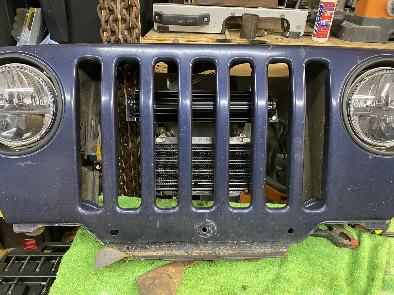

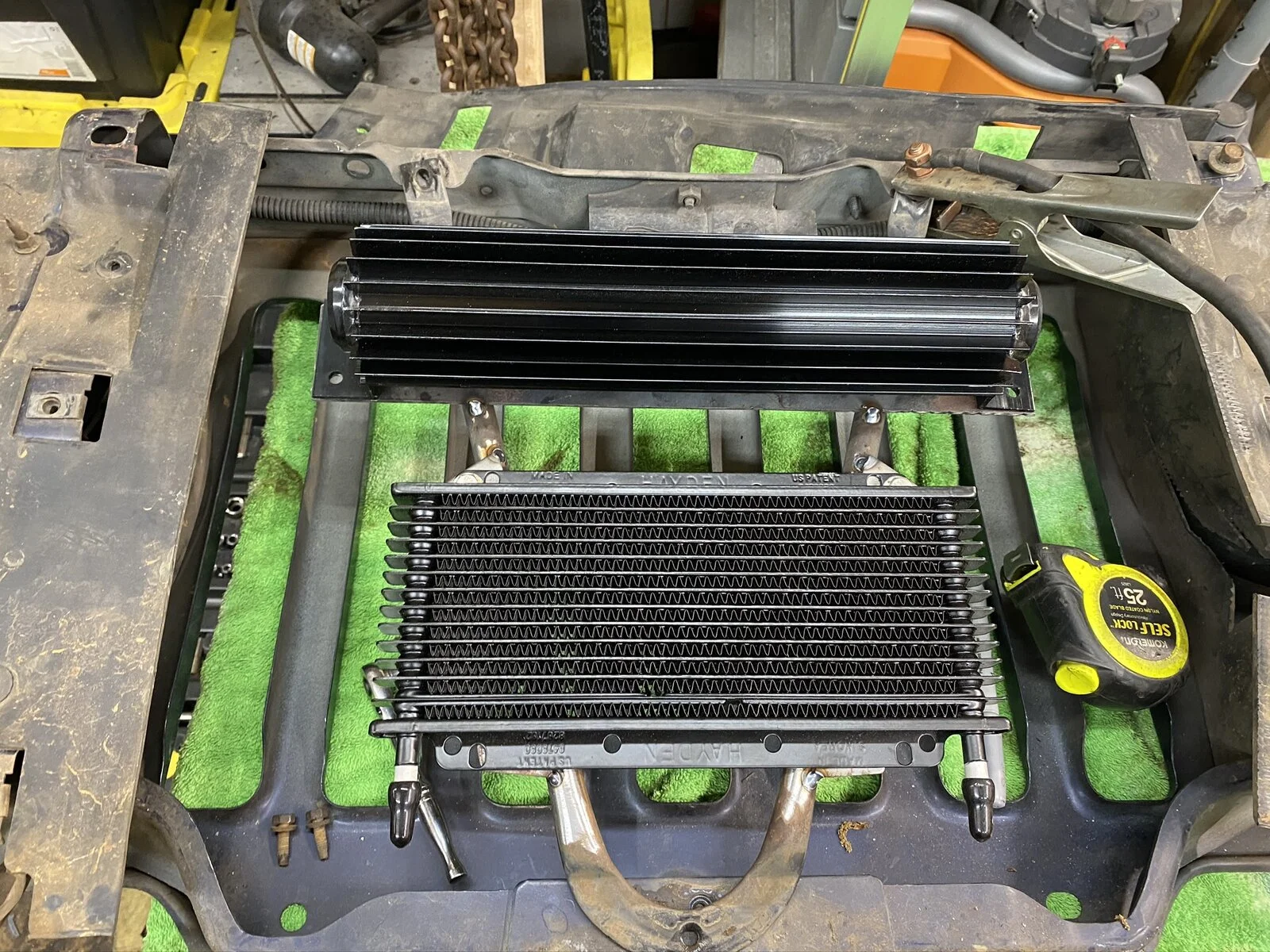

Here's how I did mine, albeit with a different transmission cooler.
I used 4 threaded trick tabs to mount the trans cooler - these were welded straight to the V brace.
Added a piece of 14GA to bolt the PS cooler to:
The final result.
