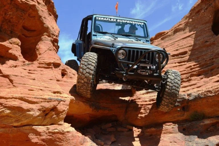

I have been continuing to read past threads on this wonderful forum as I start to think about what modifications I need to plan for my TJ. One thing I picked up on was building for the conditions you will encounter. Now in the UK I am unlikely to need to do this...
But I may well end up somewhere like this...
The question I therefore have is, given my jeep is likely to see an awful lot more mud than desert rock, what differences will that mean for my build?
Thank in advance for any thoughts!

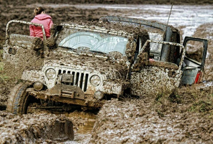

  • Wow
Reactions: Blondie70 and B252

.View attachment 215277
Thank you so much for the input. I also love the picture, but for the life of me I cannot work out how that women can be so clean in amongst everything else going on there!
Windows up until it gets stuck, then hang out of the door (out of the mud) and bitch.:)

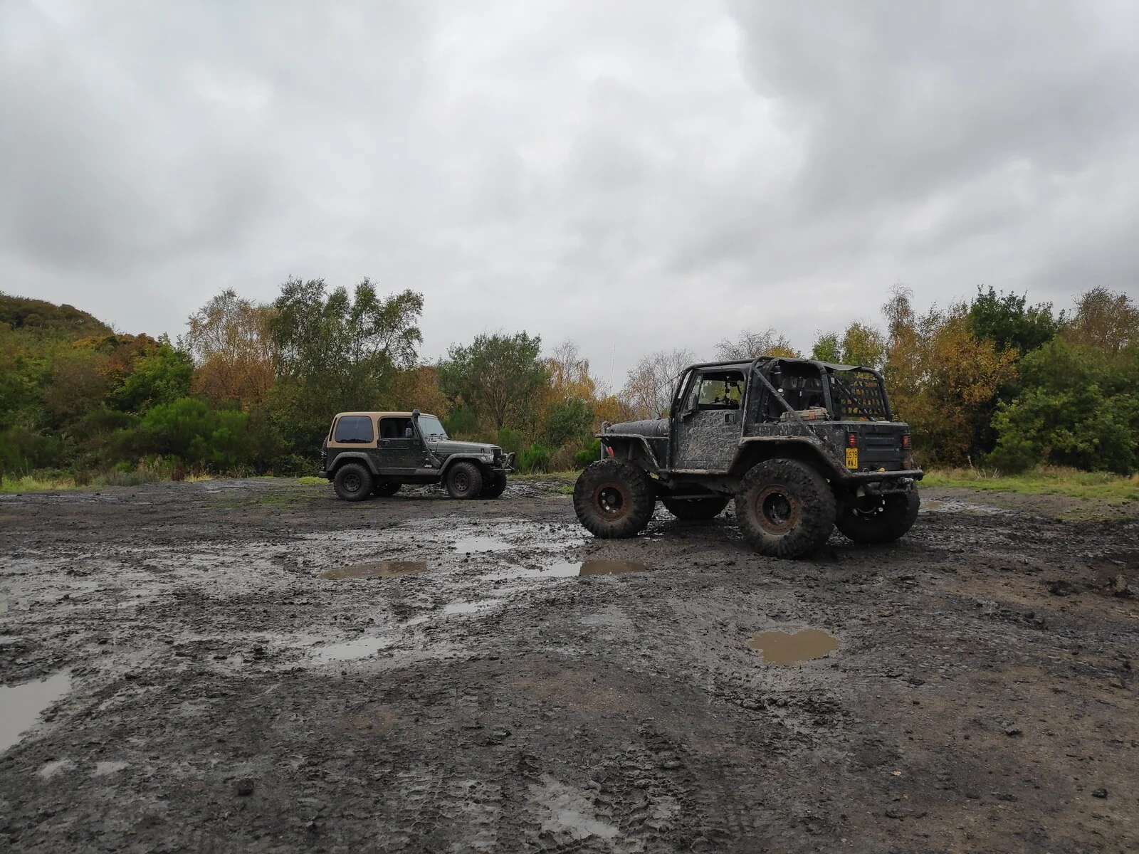

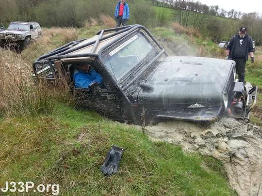

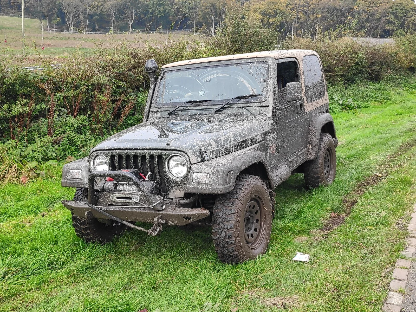

Fellow UK jeeper here...
Here are some pics from a pay & play I went to in October. Didn't get many of the action but there was a lot of deep mud and rutted climbs.
My TJ did surprisingly well on 32s and no lockers. Only had to winch once cause I got wedged in a ditch, but didn't go for any crazy mud pits because I knew it would be pointless and only break stuff.
The level of challenge really depends on what you tackle as it's basically a free-for-all. Pay attention to what other vehicles are doing and what kind of mods they have to get an impression of difficulty.
